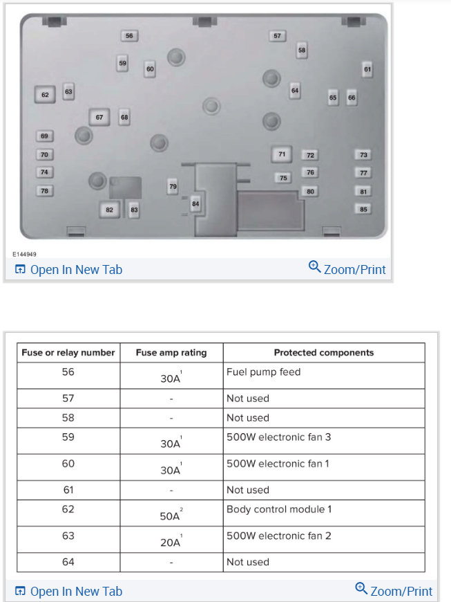

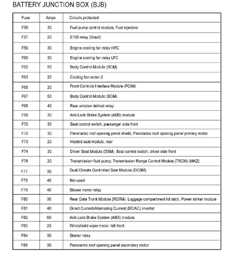

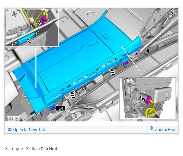

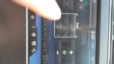

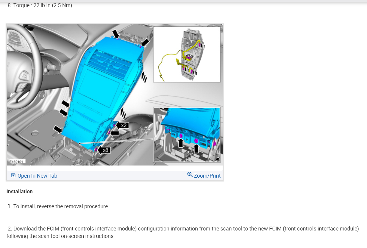

No climate control, and radio control, heater blower,cross trafic Gautier, blind spot system faulty, rear defrost, passenger power mirror, airbags. electric windows passenger side only works passenger side door front.
Aug 26, 2019 at 9:11 AM
  • 54,832 POSTS

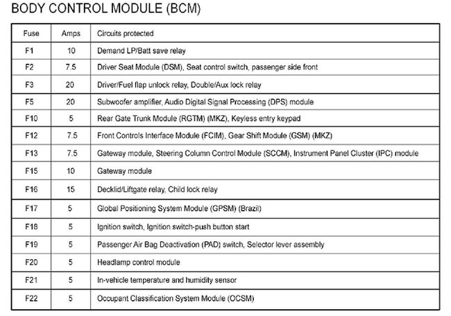

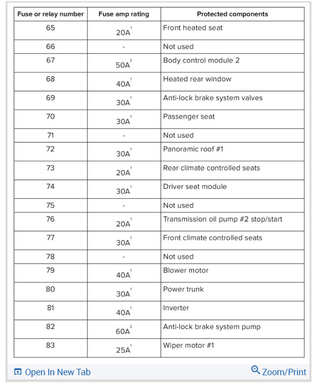

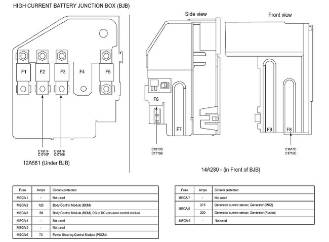

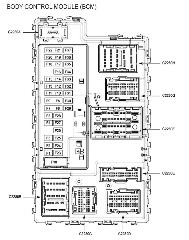

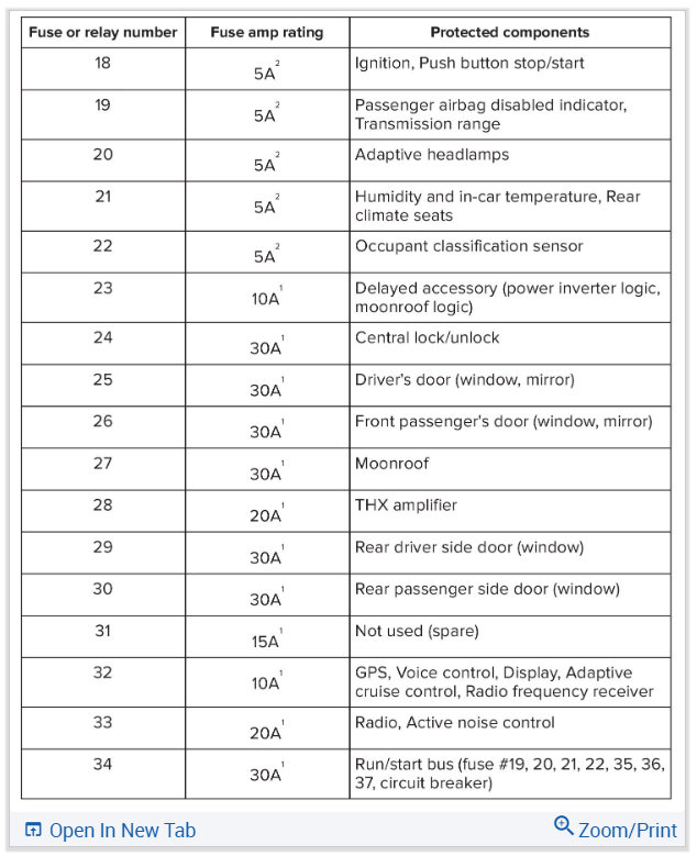

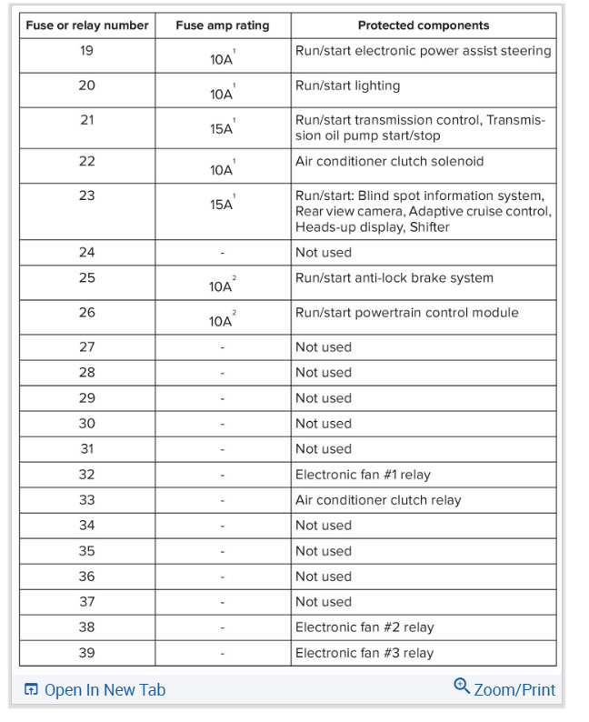

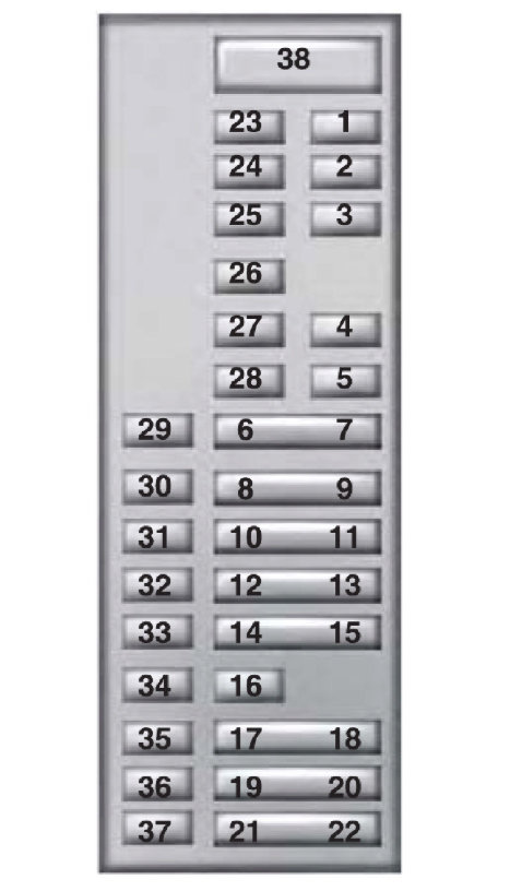

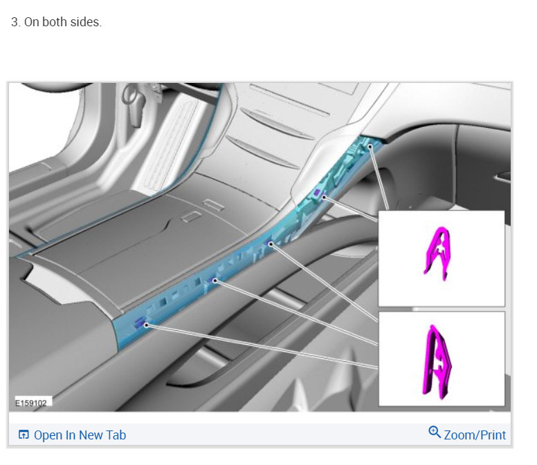

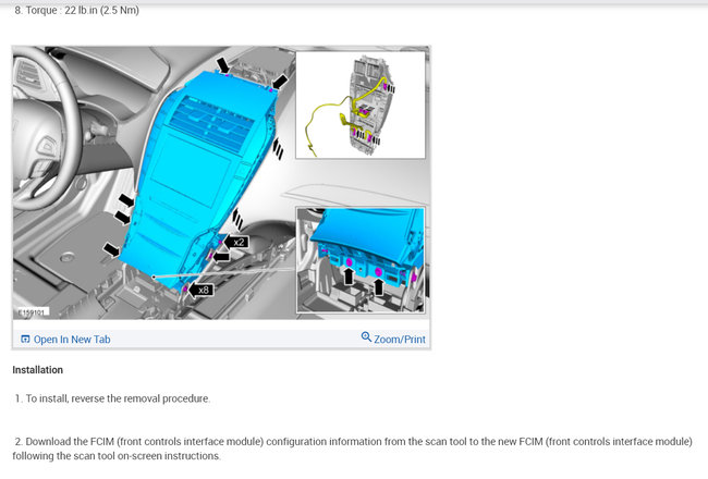

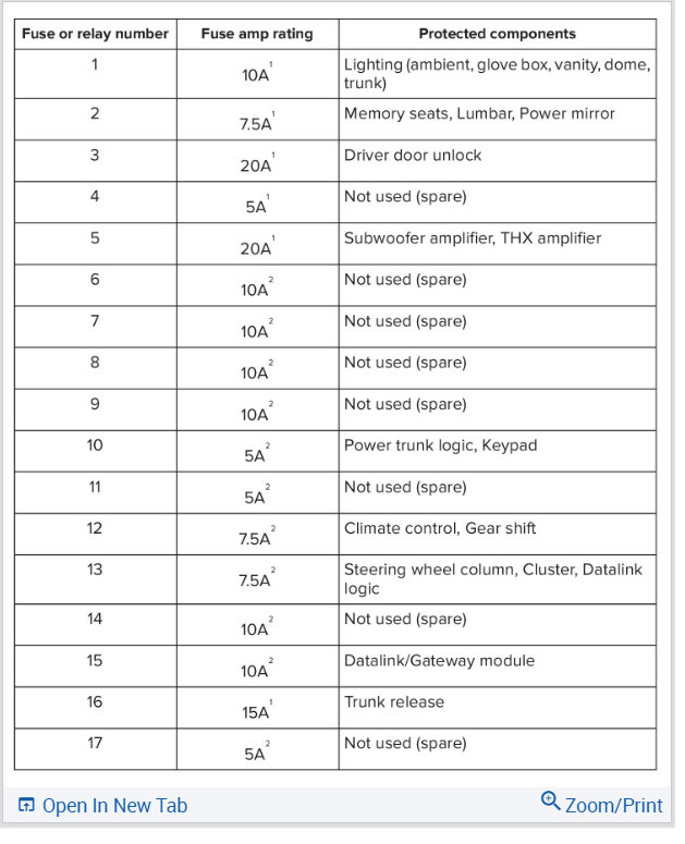

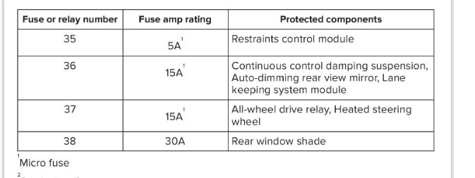

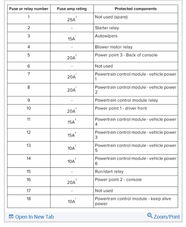

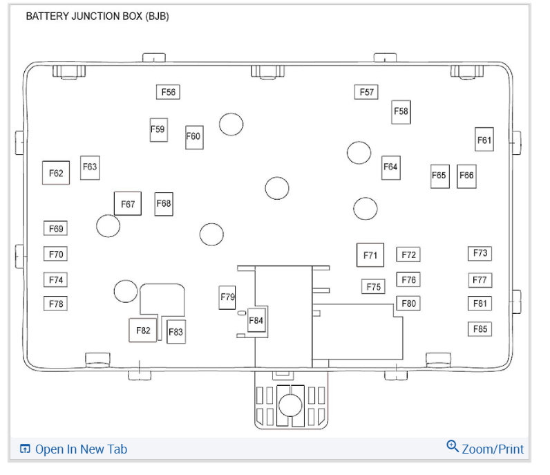

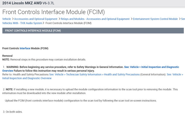

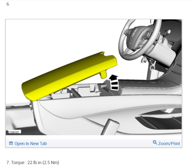

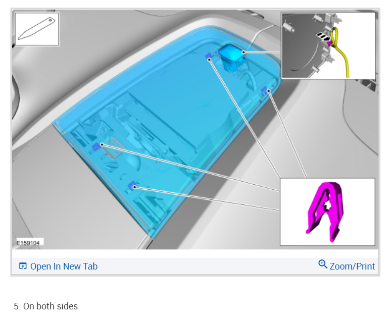

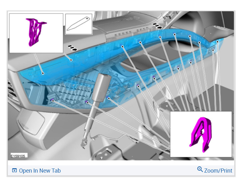

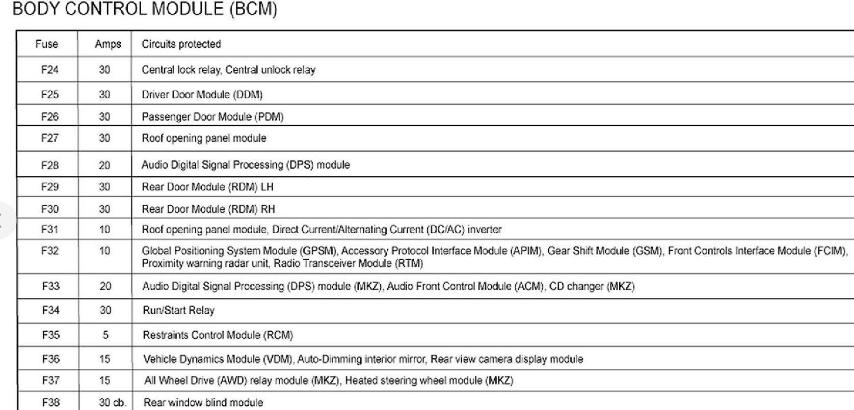

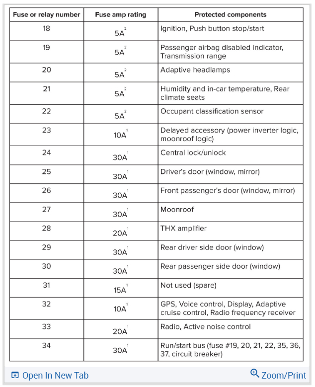

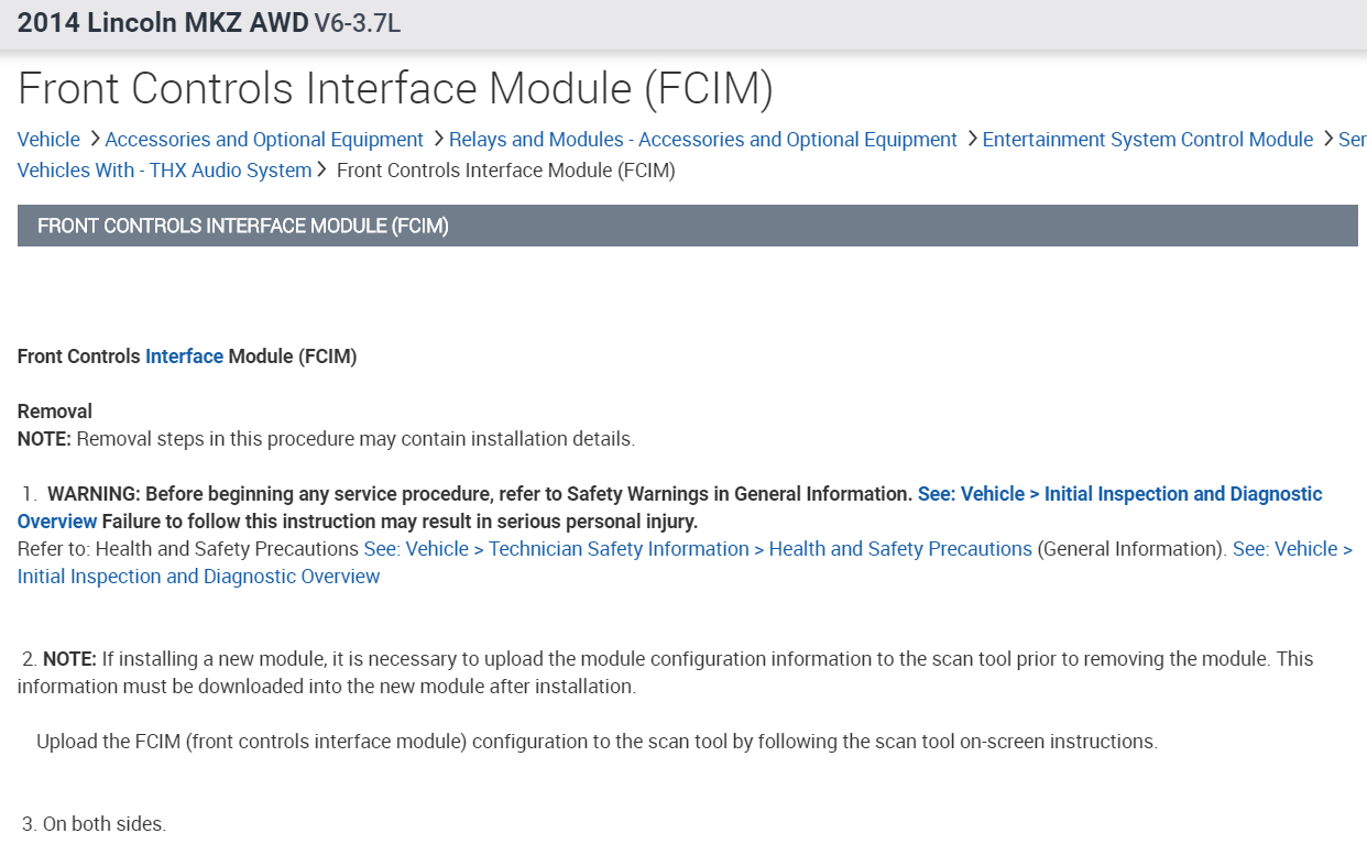

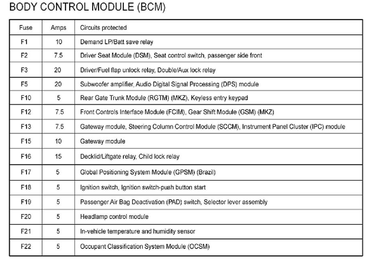

It sounds like the front interface control module is out. We should check the fuses first and run a CAN scan. here are two guides to help us fix the problem with diagrams below to show you how to replace the module if bad:
https://youtu.be/InIlnsjOVFA
and

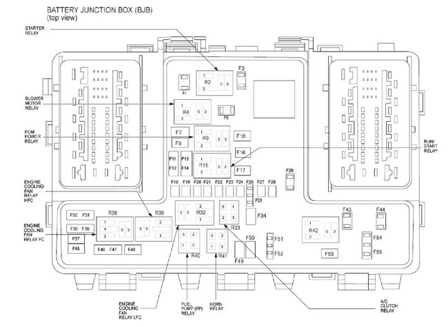

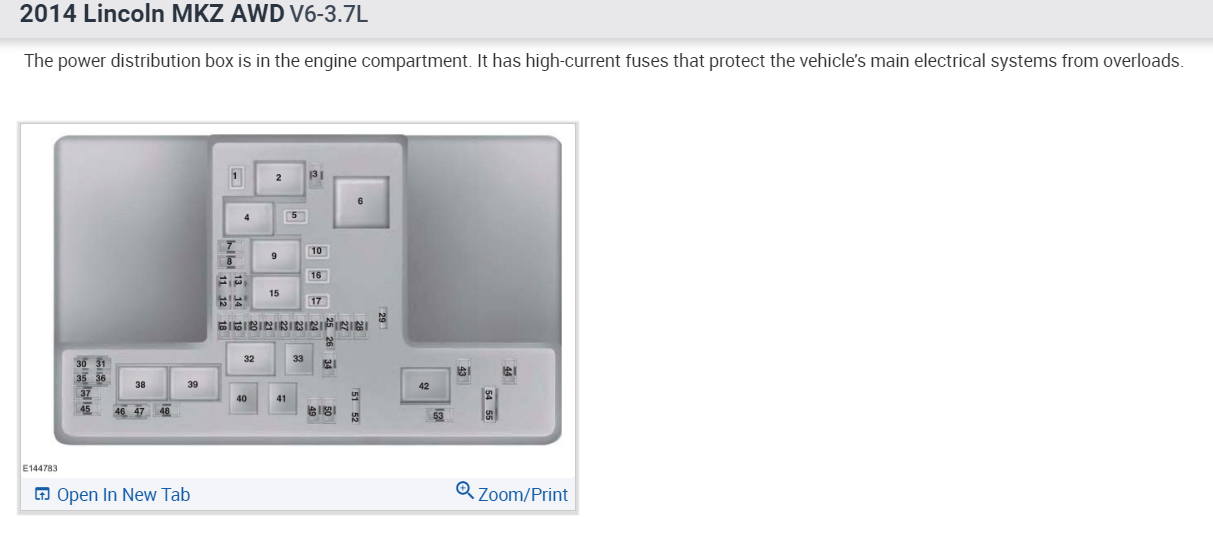

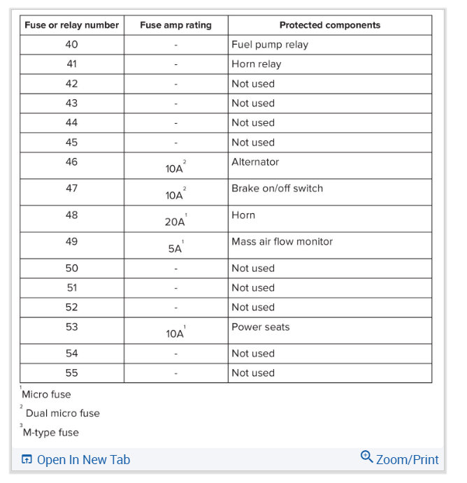

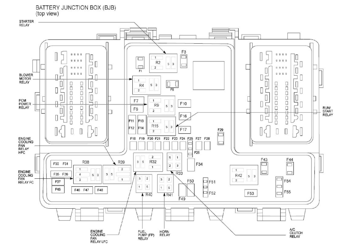

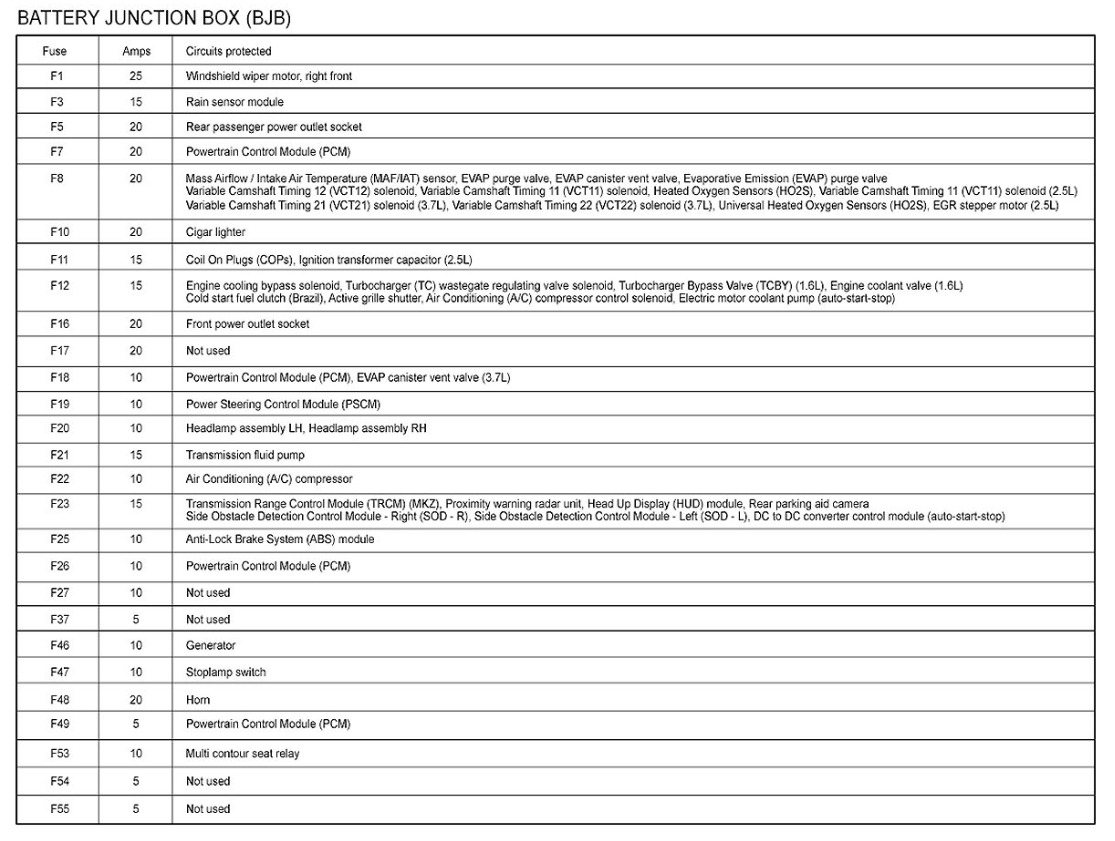

Here are the hybrid fuse panel, you can get a CAN scanner from Amazon for about $34.00:
https://www.amazon.com/gp/product/B007XE8C74/ref=as_li_qf_asin_il_tl?ie=UTF8&tag=2carprcom-20&creative=9325&linkCode=as2&creativeASIN=B007XE8C74&linkId=dc5e47e62fd1fb60fcb987399eb9edd0
Check out the diagrams (below). Please let us know what you find. We are interested to see what it is. Test with the key on make sure power is on both sides of the fuse.

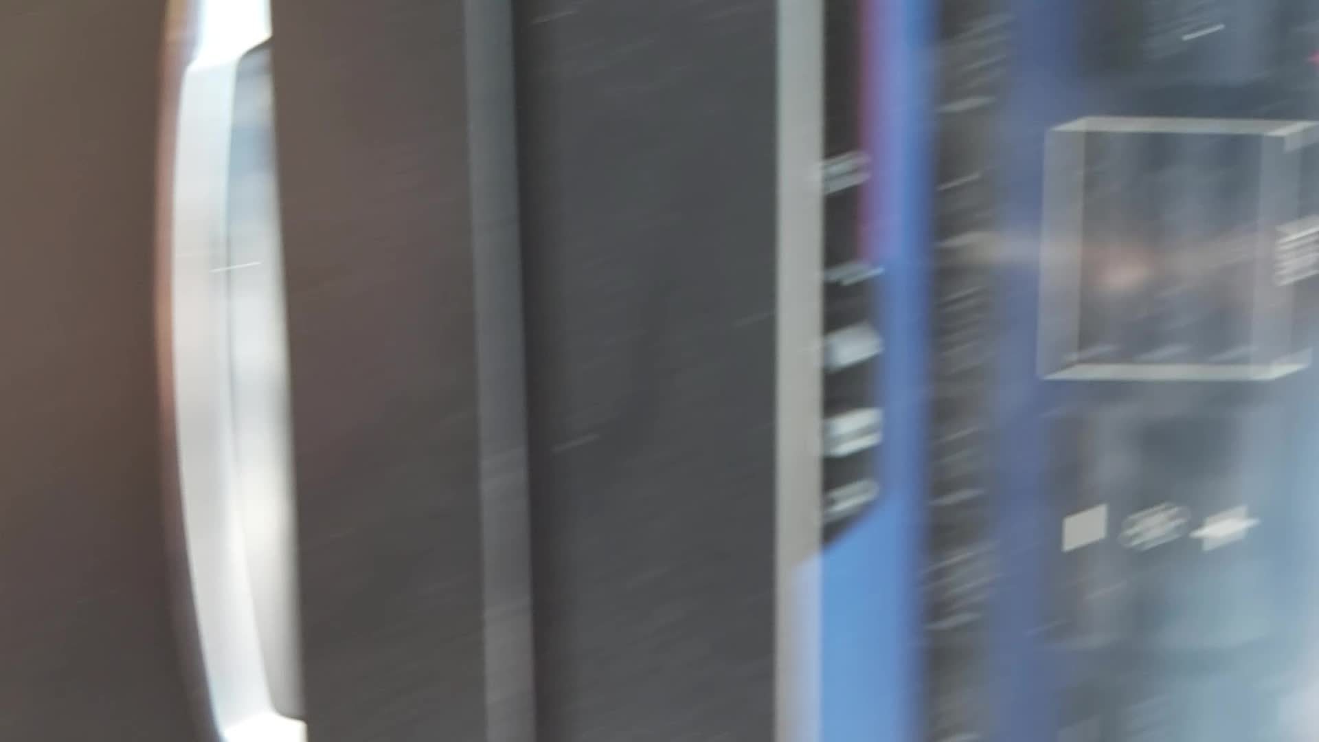

I don't think APIM is the same as the FIM. The scanner will tell us what is going on. Can you please shoot a quick video with your phone so we can see what's going on? that would be great. You can upload it here with your response. Please let us know what you find.
Aug 29, 2019 at 9:43 AM
JEAN-GUY ARSENEAULT
  • 6 POSTS
Hi Ken! Here is a short video of what I got! Hope this will help To solve the problem! Thanks again for your support.
Aug 29, 2019 at 1:22 PM
  • 54,832 POSTS
Thanks for the video. It does look like the front interface control module is out but to be sure lets wait until you get the CAN reader to confirm the issue. Let me know what happens.
