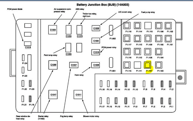

Windows, radio, and sunroof not working
2003 LINCOLN TOWN CAR
40,000 MILES • 4.6L • V8 • 2WD • AUTOMATIC
TWWJR1
Electrical problems.

If this all happened at the same time, the first thing I need you to check is fuse 107 in the under-hood fuse box. When checking the fuse, even if it looks good, check to see if there is power to and from it. This fuse is for the accessory delay relay. It can shut these things down.
I attached a pic of the battery junction box below and highlighted the fuse to check. Let me know what you find.
See pic below.
