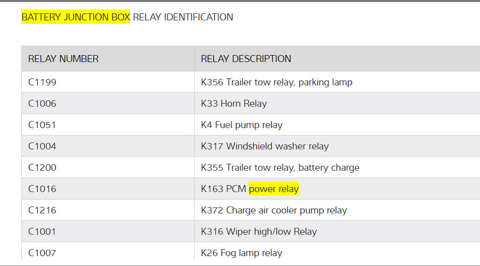

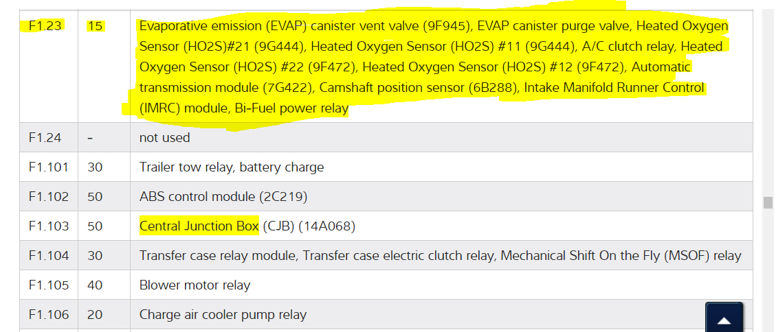

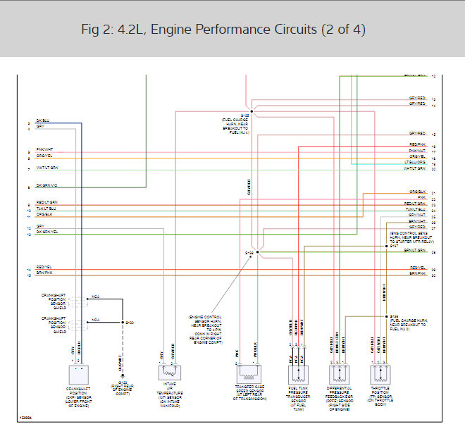

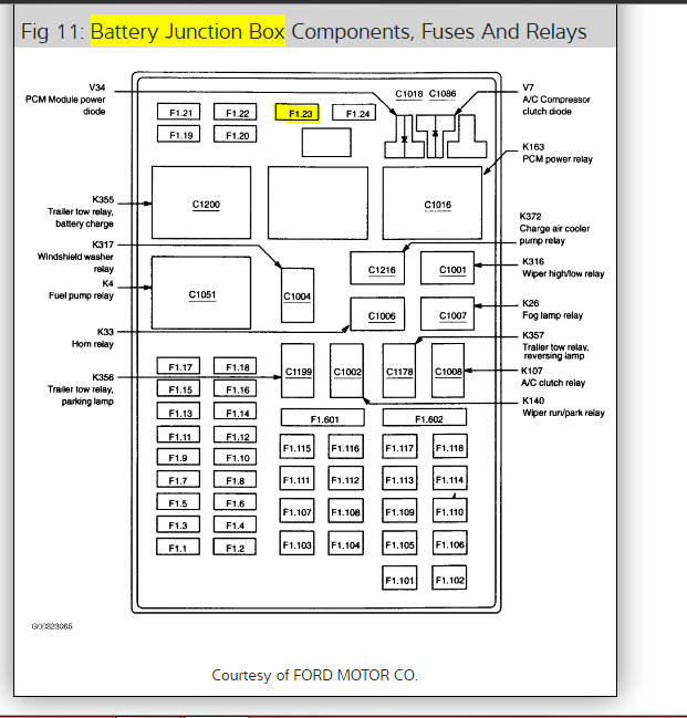

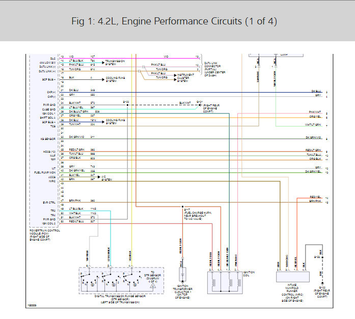

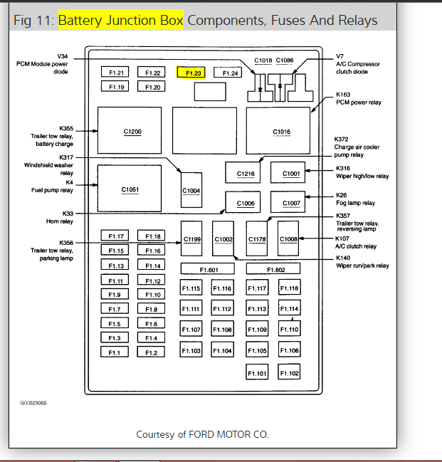

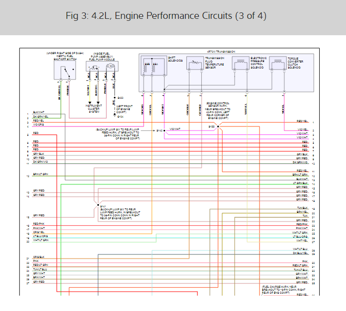

This is an interesting problem. Purchased this truck used. It idles fine, surges when accelerating,loses power up hills. Replaced plugs, wires, checked coil, checked and cleaned main ground,cleaned MAF with spray cleaner. intermittently, power at dash lights when key is turned but wont crank,checked ignition switch and movement of actuator "shaft". Theft light slowly blinking. Replaced fuse#3 obd port. also blowing fuse #23 engine compartment. Codes, 135,141,155,161,340,443. Any ideas would be appreciated.

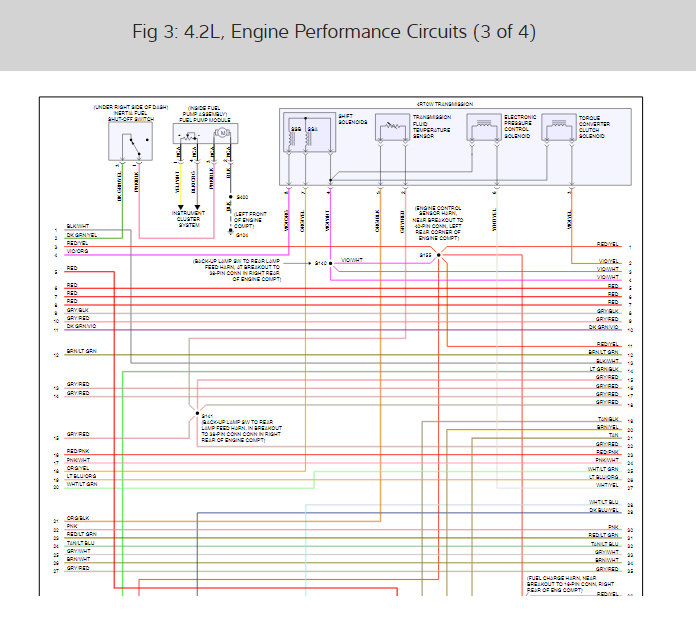

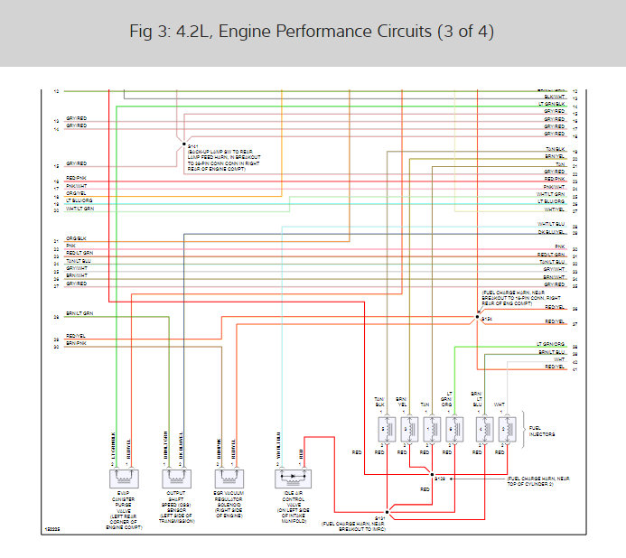

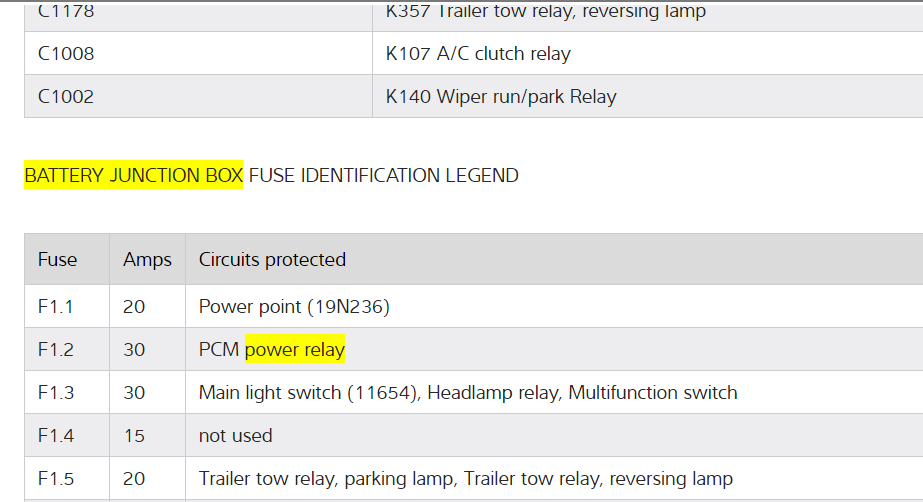

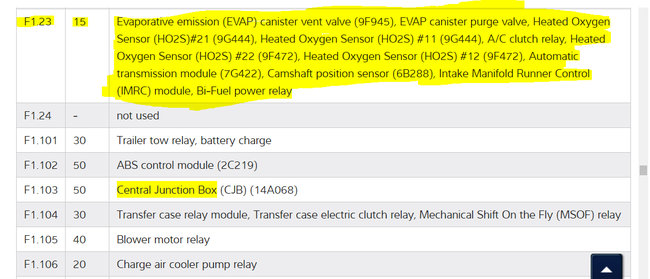

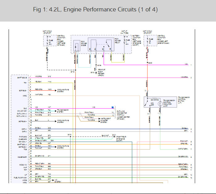

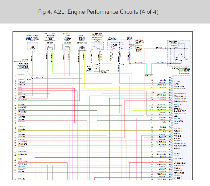

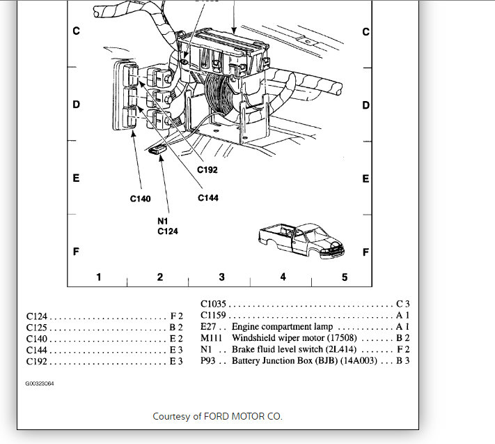

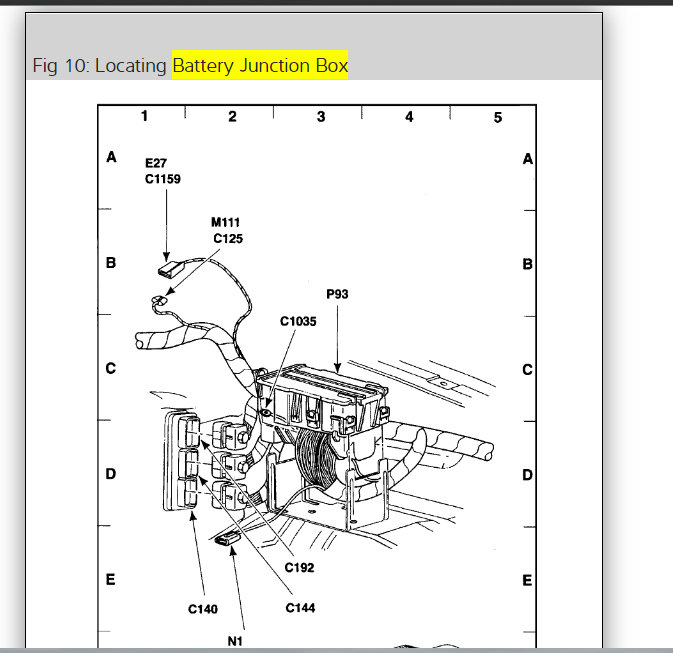

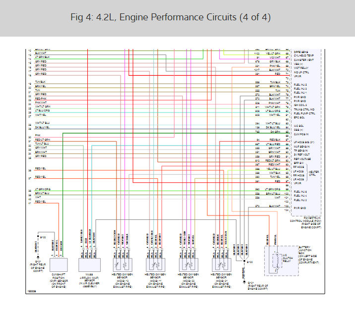

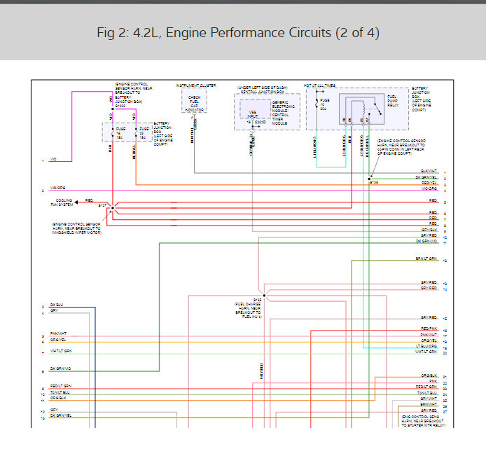

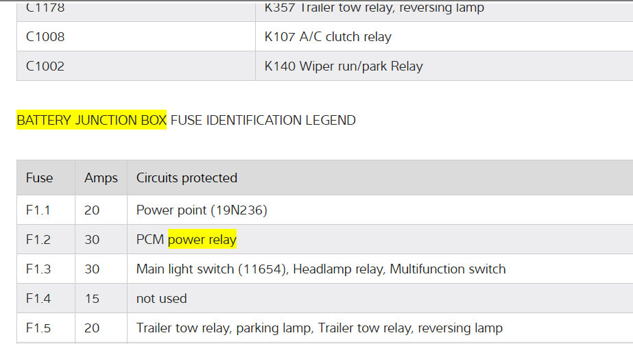

You are blowing fuse #23 in the Battery Junction Box because you have a short to ground somewhere in the circuits that the fuse protects. Let's start with the blown fuse then we can move on to the Direct Trouble Codes (DTC)(s). In the diagrams down below I have included a diagram with callout of the Battery Junction Box as well as wiring diagrams for the engine performance of your vehicle. The set of wiring diagrams will have all of the circuits that fuse #23 protects(available on the callout). I have also included a guide for finding shorts to ground in an automotive electrical circuit. You will need to use a Digital Multi-meter (DMM) to find the short to ground, so I have included this link below for you to go to if you are unfamiliar with how to do so.
Please go through these guides and get back to us with what you are able to find. We will tackle the DTC's then.

Thanks for your quick response and the wiring diagrams. I will get back in touch when i've had a chance to do more troubleshooting.

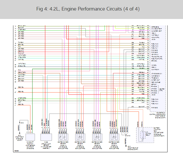

Okay, slowly but surely, but don't call me Shirley. having to work on it when i can. Checked connection,cleaned , lubed and replaced springs on clutch home position switch ,solved intermittent non starting problem. Applied Permatex flow-able silicone around wind sheild for leaks. seems to happen a lot on these models. Oh yeah, replaced fuel filter earlier, looked like it had never been replaced. Traced wiring to oxygen sensor with a bare wire.did a temporary tape job but still blowing fuses. Will check back when i have more time.
Sep 1, 2019 at 7:55 AM
  • 54,832 POSTS
I would unplug the coil and injectors to see if the fuse still blows. Let us know.
