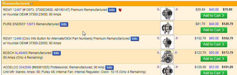

This could be due to the alternator they sold you is not equipped to match your vehicle. There are many options including ones with internal regulators and other with clockwise rotation.
