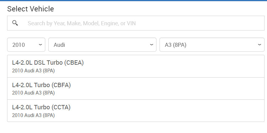

I need clarification on the engine. I attached a pic below showing the engine indicated in my manual. It's not showing a 1.9L.
Let me know which you have.

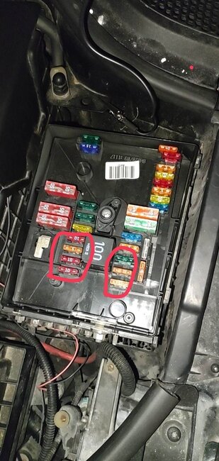

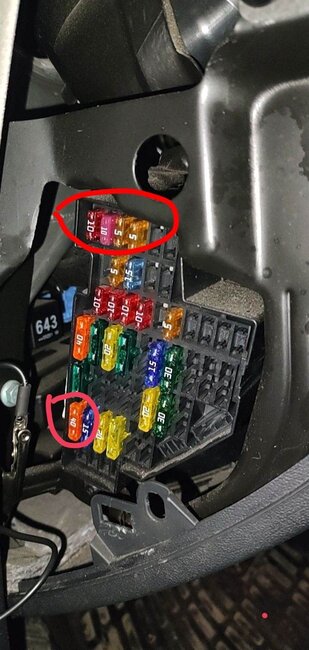

Hey, my engine is 1.9 TDI. Thanks for the video. I got a fuse checker and checked the fuses that control the light and such. The fuses are new and working, but the fuse checker did not light up on the fuses i made a little red circle in the picture, those are the ones that controls light and other things. The rest of the fuses in the picture outside the red circle light up when checking with the fuse checker and seems to be working correctly. So, it has to be something behind the whole fuse box or something that is wrong? perhaps some relay?

Same with the fuses in the motor space. Here is a pic. All working fuses, but some get no power like you said.
Jan 14, 2023 at 1:11 AM
  • 110,241 POSTS
It could be from behind the fuse box or there could be one of them that powers others that may have failed.

The 4 fuses that is not working in the cabin does.
1 Engine components (I), manual headlight beam adjustment, automatic headlight beam adjustment, AFS control module, engine components (II), light switch (switch lighting/illumination), diagnosis socket 10
2 All Wheel Drive, automatic transmission, control module for CAN data transfer (gateway), electromechanical steering, shift gate automatic transmission, engine relay, fuel tank control unit, engine control unit, brakes control (ABS), Eleclltronic Stabilization Program (ESP), Anti-Slip Regulation (ASRl, brake light switch 10
3 Airbag 5
4 Air-conditioning (pressure sensor, air quality sensor), button for Electronic Stabilization Program (ESP), Anti-Slip Regulation (ASRI, oil level sensor (WIVl, back-up light switch, front seat heating, Seat-occupancy recognition (on USA vehicles), navigation, garage door opener, automatic mirror dimming, Heated windshield washer nozzles,air conditioning (control module 5

In the engine. The fuses that are not working:
F13 Engine control module
F14 Ignition coils
F15 Tank diagnosis, oxygen sensor
F21 Oxygen sensor
F22 Clutch pedal switch, brake light switch
F23 Engine relays, engine components
F24 Engine components
Jan 15, 2023 at 3:56 AM

And i noticed also in the cabin that two more fuses did not work.
40 Heating (blower fan) 40
41 Rear window wiper 15

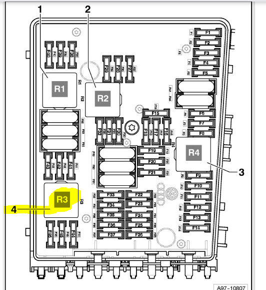

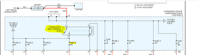

Wow, that is a lot of them not working. Keep in mind, what I have isn't for the 1.9L engine. But most of the fuses you mentioned crossed.
So here is what I recommend testing or checking. There are four power control relays in the under-hood relay box. In this case, it appears that power control relay (30 B+) is what powers the fuses you mentioned.
So, remove the relay and check the connectors in the box and on the relay.
Here is a link that explains how to test a relay:
Hang in there. We'll figure it out.
