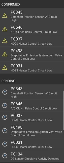

10a Sensor fuse blows, everything down stream inoperable, O2 sensors, EVAP vent valve, A/C clutch relay, camshaft position sensor, heater control circuit, fans, all inoperable.
Voltage on both sides of fuse terminal.

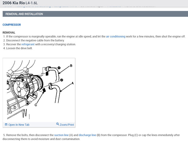

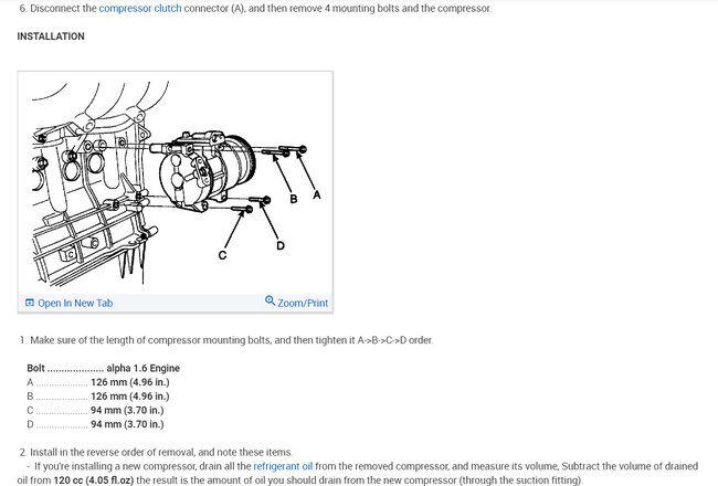

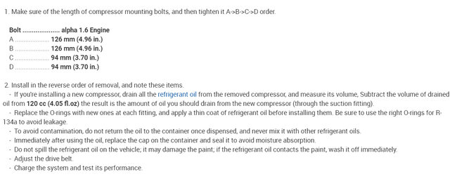

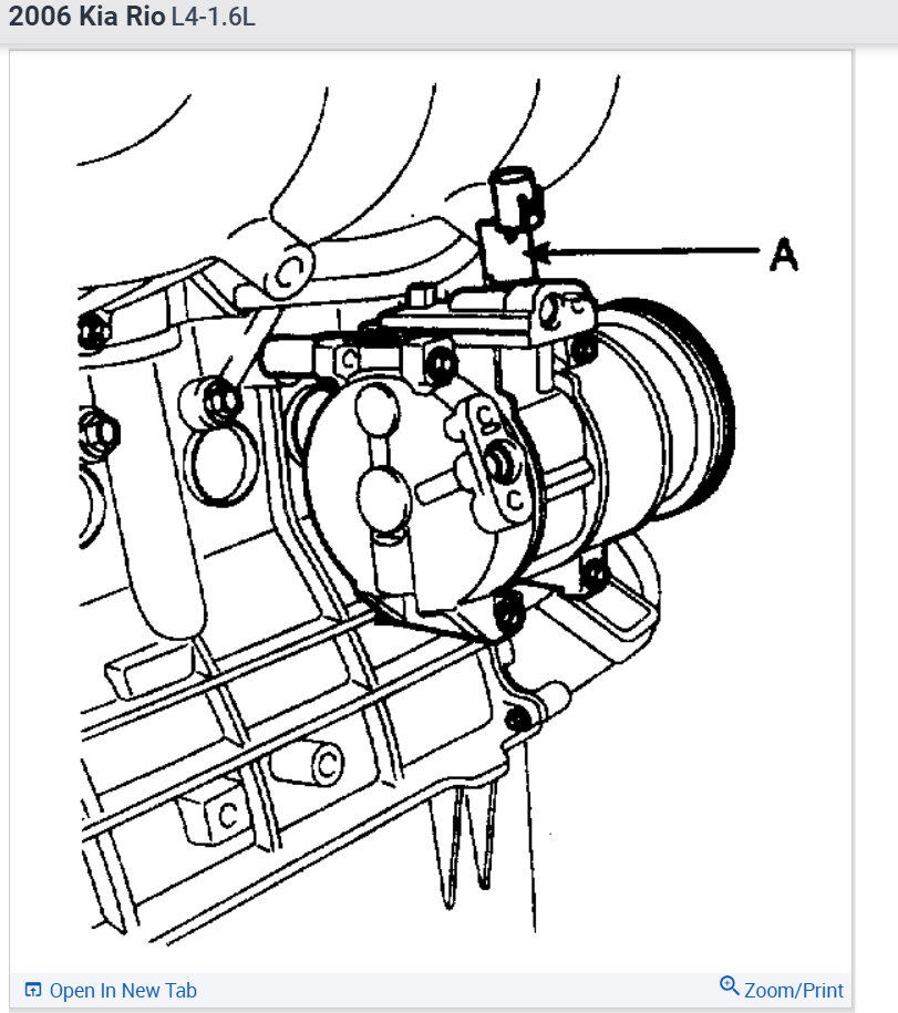

I would unplug the A/C compressor and then replace the fuse because it sounds like you have a compressor clutch coil that has shorted out. If the fuse does not blow with the compressor unplugged, it will need to be replaced. Here is a generic guide to help you step by step with instructions in the diagrams below to show you how on your car:
https://www.2carpros.com/articles/replace-air-conditioner-compressor
and
https://youtu.be/4EqdrBVb0sY
Check out the images (below). Please let us know how it goes.

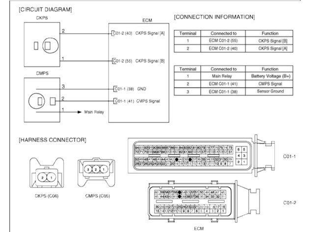

The camshaft position sensor power is still hot with fuse blown, indicating electrical short to power?

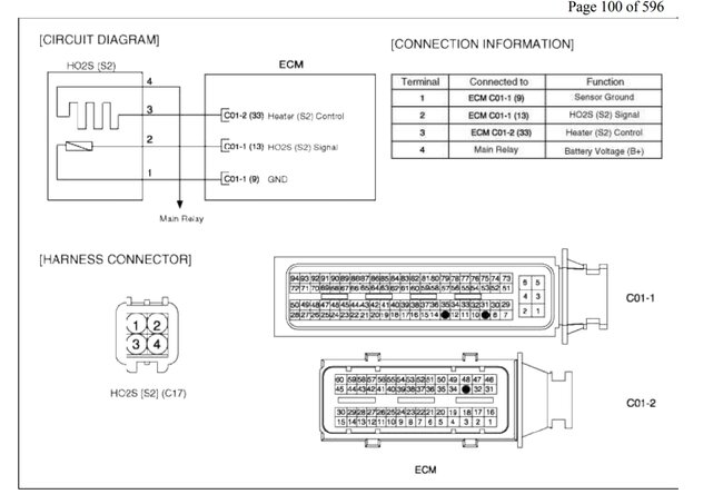

Good job, let's unplug the oxygen sensors, and then if it doesn't blow plug them in one at a time to see which sensor heater is bad.

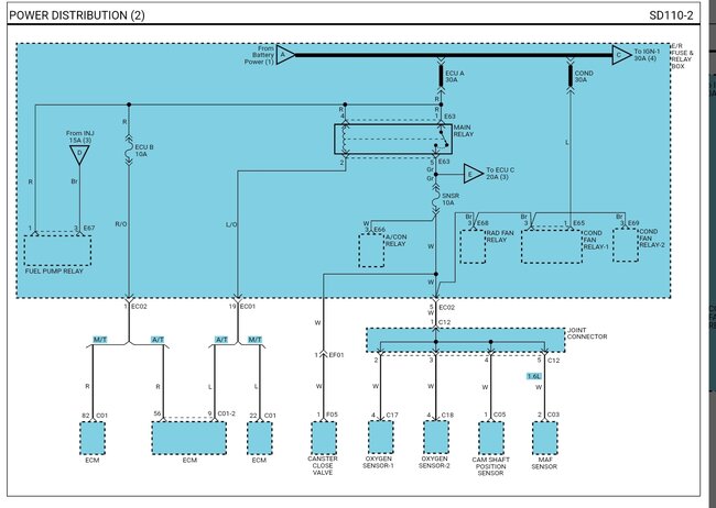

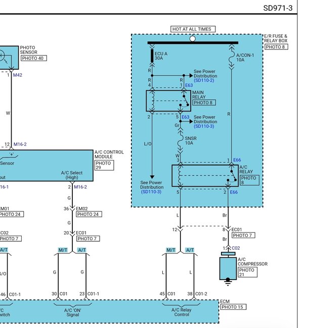

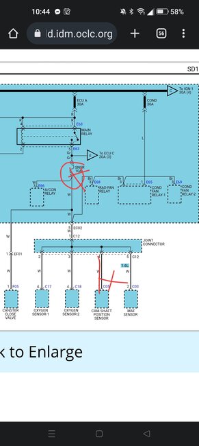

I've disconnected everything in the power distribution wiring diagram connected to the 10a sensor fuse. Still blows. With fuse removed and loads disconnected There's 10v at camshaft position sensor white wire and at the o2 sensors 4th white wire from the diagram(attached).
How's this possible with fuse and sensors removed, Is there a short to power in the wiring harness or joint connector? How do I go about finding this? Why is it 10v? If that's the case wouldn't there be more problems? with another circuit? another fuse blown?
Battery is 12.5v. and running voltage 14.1v and ignition needs to be on to power circuit.
Both sides of fuse terminal show voltage with 10a sensor fuse removed. Is this normal? The load side should be 0v right? And power side is battery voltage?

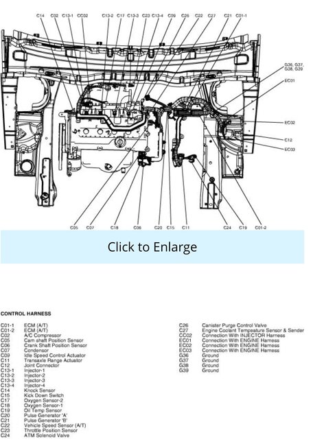

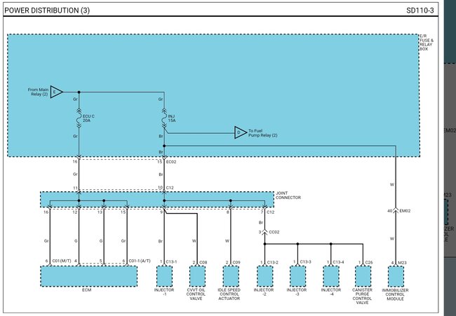

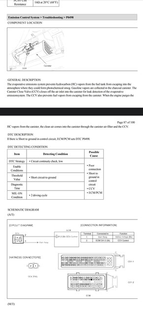

Attached is control harness wiring, DTC codes, power distribution wiring for the 10a SNSR fuse, everything that goes into the joint connector, another main relay diagram, service manual for canister close valve, service manual 02 sensor diagram, camshaft position sensor diagram,
I confused the canister purge control solenoid valve for the canister close valve. I'll check that tomorrow and see if it changes anything.
I'll also check camshaft position sensor signal short to power.
Sorry, this seems to be a complicated problem and a lot of information.
Any help would be appreciated. Thank you, Ken.

Yes, it is possible there is a short in the wiring, but I noticed the fan relays and EVAP control solenoid is powered by this fuse did you disconnect them as well? And you have a code for it the EVAP solenoid so this can be a clue.
