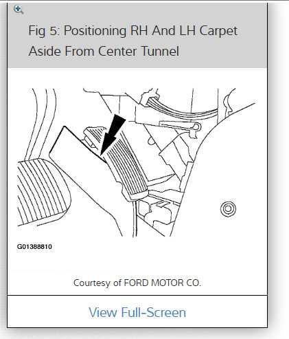

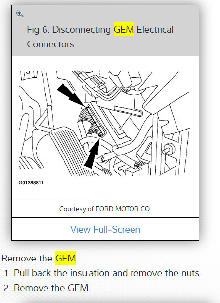

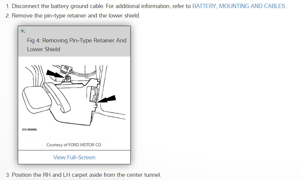

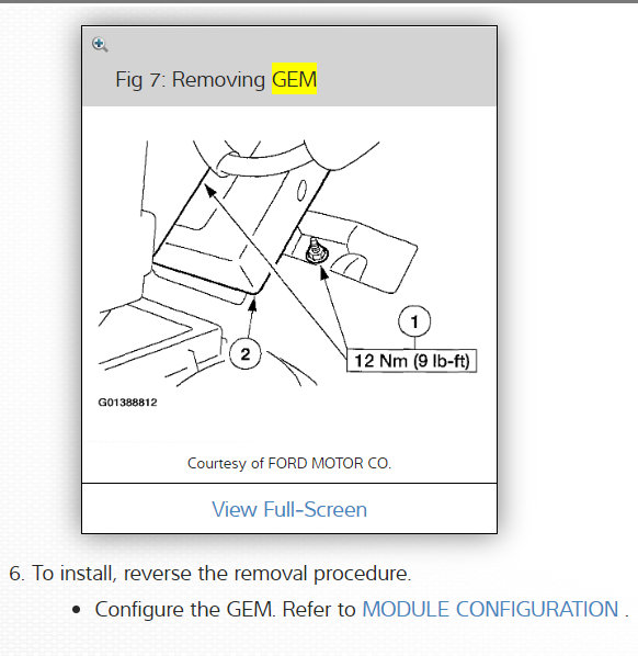

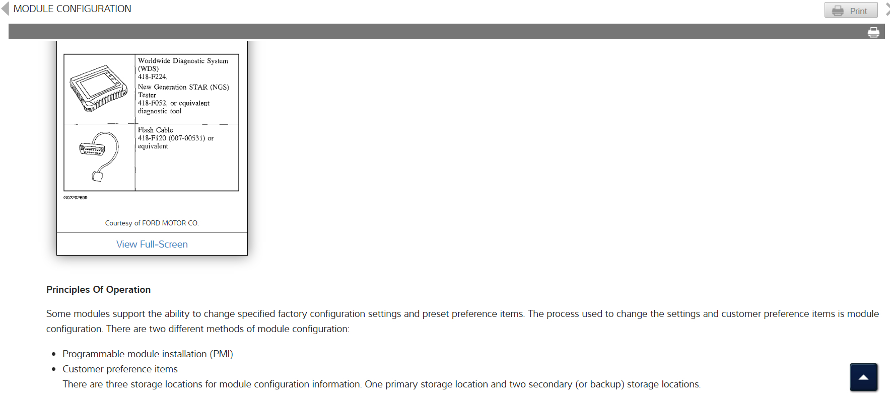

Hello, when turning on hazard lights interior lights starts flashing and small display in the speedometer also flashing. new alternator, cleaned negative cable, all ground cables. still have this problem.
Apr 11, 2019 at 12:21 AM
  • 55,433 POSTS

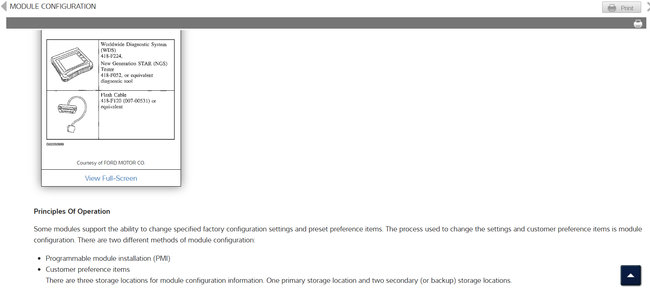

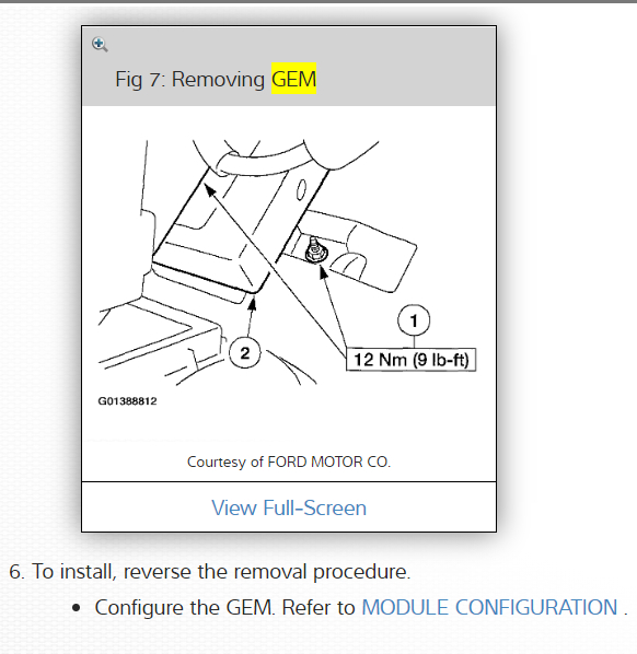

It sounds like the GEM is out. here is instructions and guides to help you change it out to fix the problem. Check out the diagrams (below). Please let us know what you find.
Apr 12, 2019 at 4:13 AM

Also, when i press brake pedal light flashes little bit.
Apr 14, 2019 at 5:20 AM
  • 55,433 POSTS
Yep, these are controlled by the GEM can you try to replace it to see what happens?
