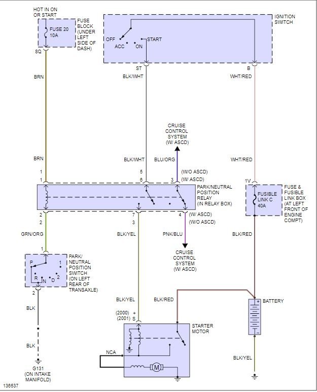

I have an electrical problem. Car will not start or even turn on, but headlights turn on and off, nothing else works. When I mess with fuse box everything comes on but for a quick minute but I cannot find the correct wire, what can this be?

Check the voltage at both sides of the fusible link C in the fuse and fusible link box, located left side under the hood.

Turns out it was a piece of plastic wedged under the 100a fuse which caused it to have this problem.
