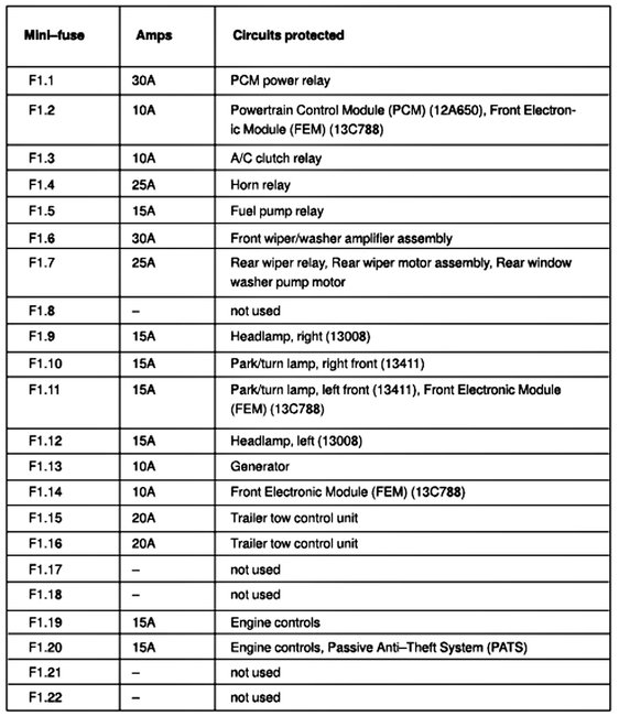

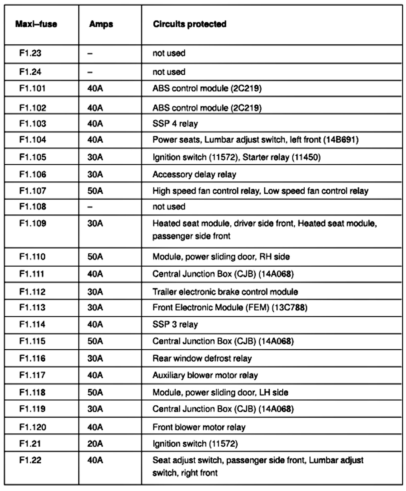

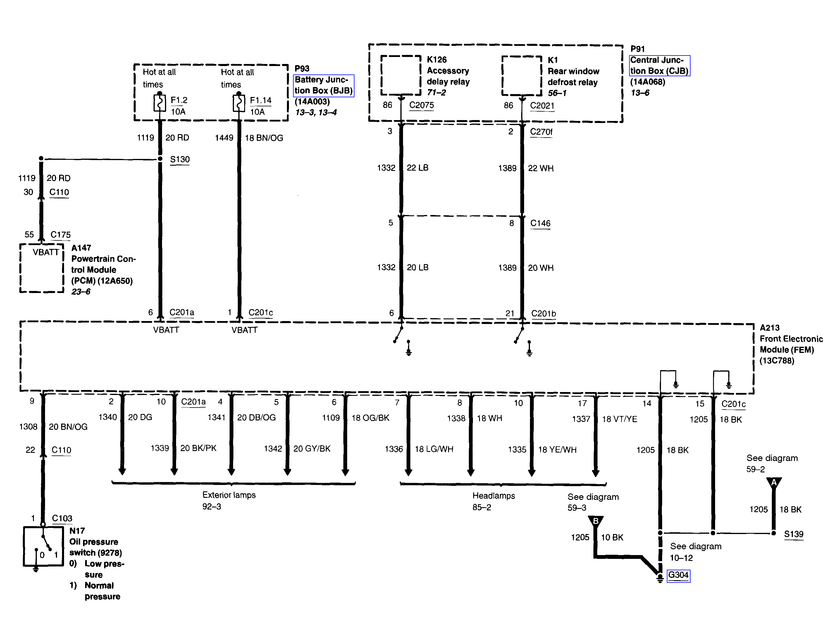

After i shorted a wire changing, radio gauges, windows, air, don't work.what do i do to fix this? i have checked all fuses.
Aug 12, 2019 at 8:37 AM
BMDOUBLE
  • 1,139 POSTS
These circuits are controlled by the FEM,front electronic module. I included the diagram for this module and the fuses that power it. It is important to check the fuses with a volt meter and not a light because there can residual voltage that will light a test lamp but will not be 12 volts.
