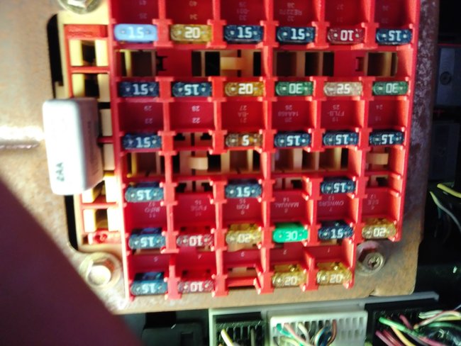

Things that do not work; wipers, windshield washer, lock/unlock, and dome lights.

Also forgot to mention defroster and trunk release. Thanks in advance for the help.

Well, Let's start with me asking if you have checked the fuses? That does seem like quite a few things wrong all at one time,but let's start with the fuses first. I have attached a tutorial explaining fuses. The fuse box is under the dash, left side, near kick panel. Hope this helps and feel free to ask any questions.Thanks for using 2CarPros.

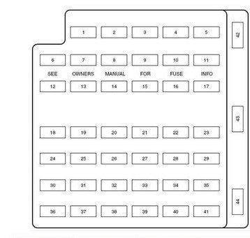

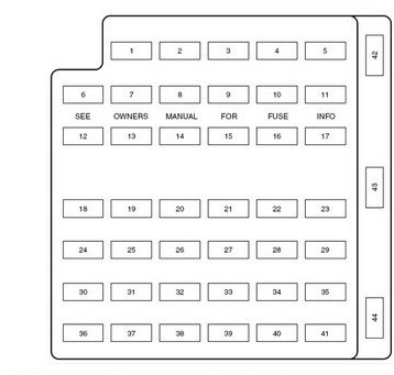

Hello Danny. I did check the fuses underneath dash everything looks good. None are broken the owners manual has a different fuse diagram than what the car has.

Fuses.

This is what owners manual is.

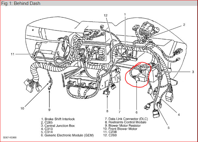

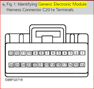

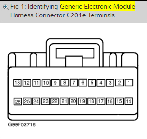

I did some research and believe you are having a problem with your G.E.M. (Generic Electrical Module). It is located under the dash on left hand side. I have attached a picture of the module (circled in red) and the connector (26 pin) that I would like you to check. I would like you to disconnect the connector and check for damaged, loose, corroded, or faulty terminals. I also have a test you can perform if you have access to a Volt Ohm Meter. Hope this helps and feel free to ask any further questions if needed. Thanks again for using 2CarPros.
