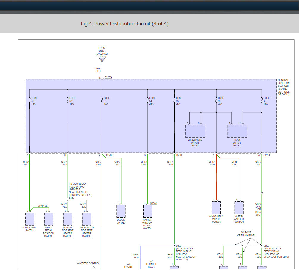

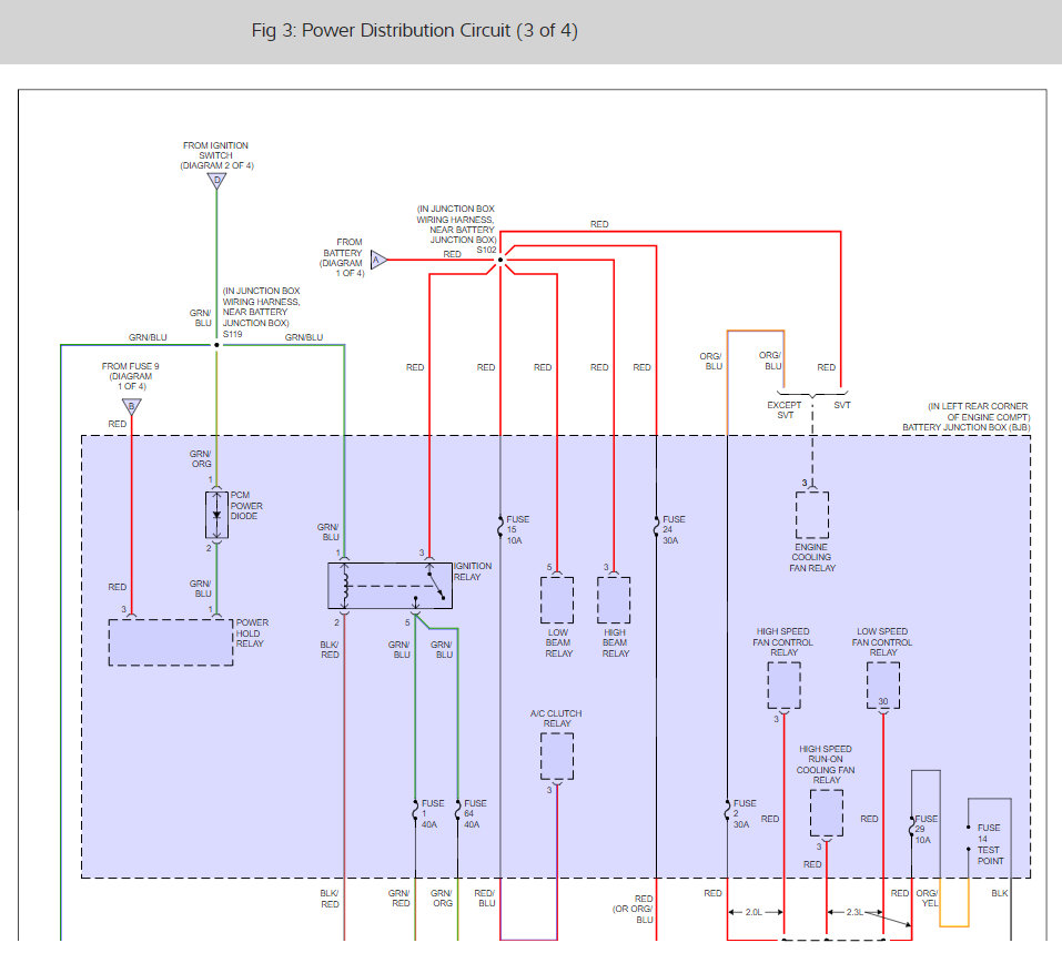

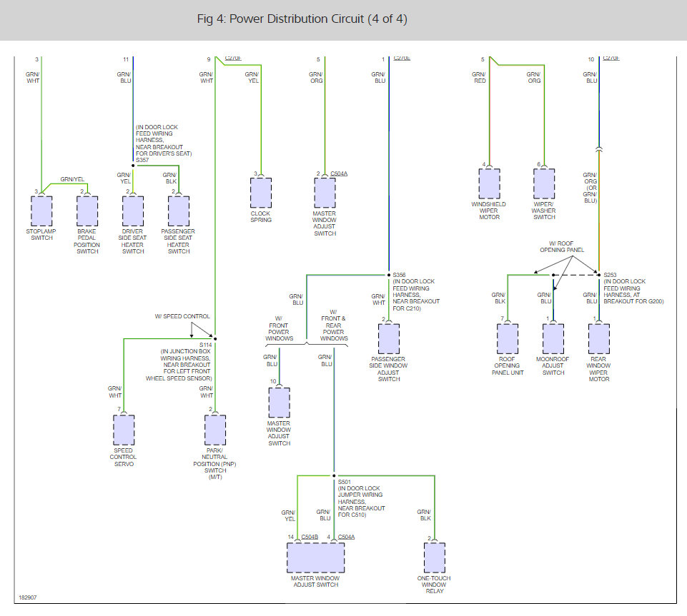

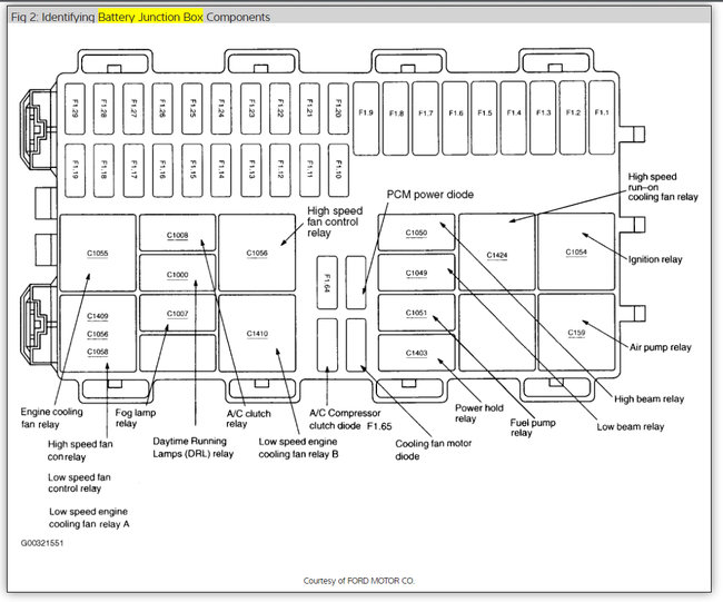

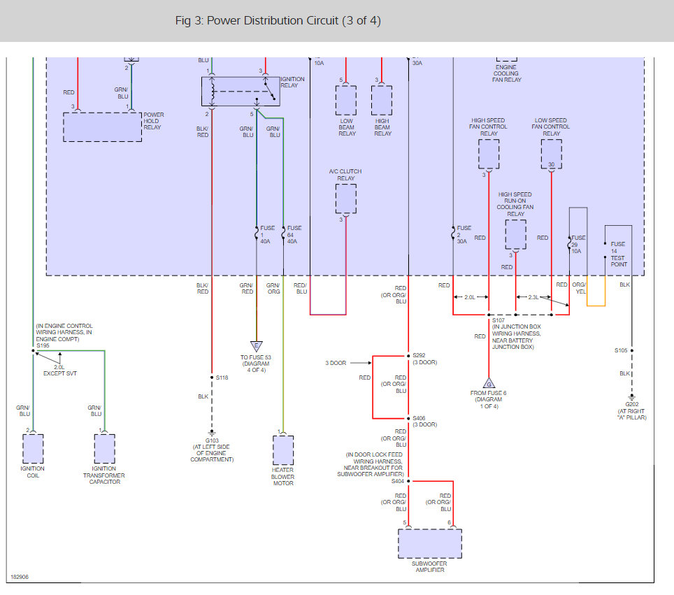

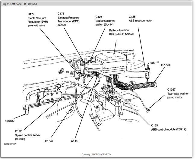

No brake lights, no power windows, no heater blower fan, and car will not come out of park.
Aug 26, 2017 at 10:34 AM
Experienced Mechanic
55,658 POSTS
It sounds like you have fuse #1 40 amp that is out. Here is a guide and some diagrams (below) to help you get the problem fixed.
and
Here are the fuse locations.
Please check it out and get back to me.
