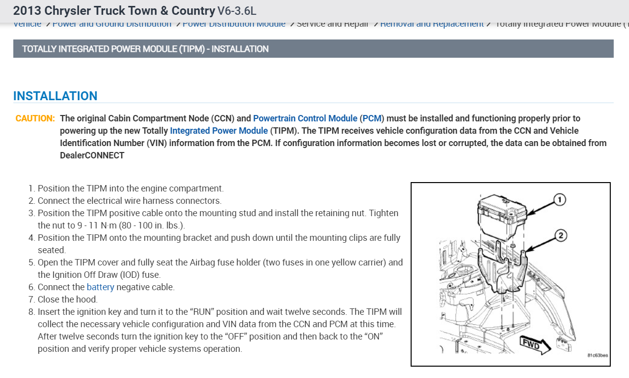

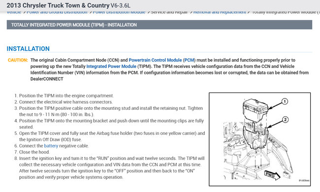

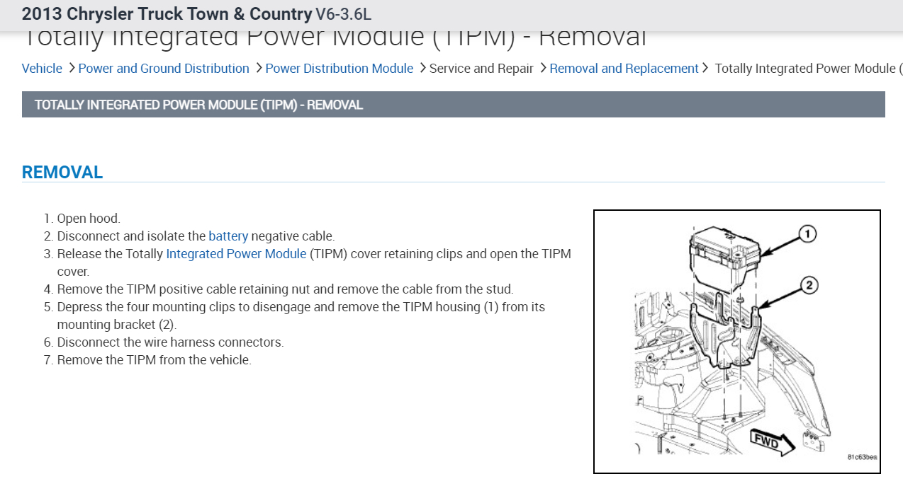

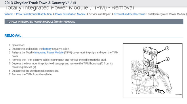

I have no brake lights but everything else in rear lamps work including hazards. nothing works in accordance with the right rear sliding door, buttons on door, overhead or key fob...window included. runs poorly not getting any reading (voltage) from multiple sensors including cam shaft pos, throttle body and map..there isn no power to radiator fan either...each problem came separately... inside fuse box (TIPM) there is no power to fuses M17/ M18/ M23/ M35...while checking rear lamps noticed no ground for tire preasure sensor.. check engine light, tire pressure sensor and traction control lights stay lit..before all these problems front right fog lamp shorted out currently no power or ground to it. I have a list of codes i will attach shortly...I no its a lot but any help would be very much appreciative...thanks

This happens when the TIPM goes out which are a problem on this car, I would get a new unit but first I would do a CAN scan to confirm the failure, you can get a CAN scanner (Controller Area Network) which will work on most cars from Amazon.
https://youtu.be/u-4syLc-ifQ
Here is how to change it out which is easy because the unit self learns once installed. Check out the images (below). Please let us know what happens.
