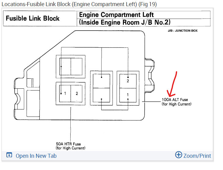

SHAAYA84
Battery mount was loose and hit the positive battery pulse. The car wouldn’t start. I found 2 fuses were blown and replaced both and the car fired right up. The dash is only illuminating door open and airbag light. No indicators light up in the key on engine off position. The radiator fans have not come on. The A/C fan will not blow, no radio, no power locks. I’ve checked all the small fuses under the hood and behind change door in the inside of the car.

Okay, we are going to need to work backwards so bear with me, can you please check the alt fuse 100 amp for power? This guide should help:
It is a fusible link in the fuse panel under the hood, here is the location. Check out the images (below). Let us know how it goes.
