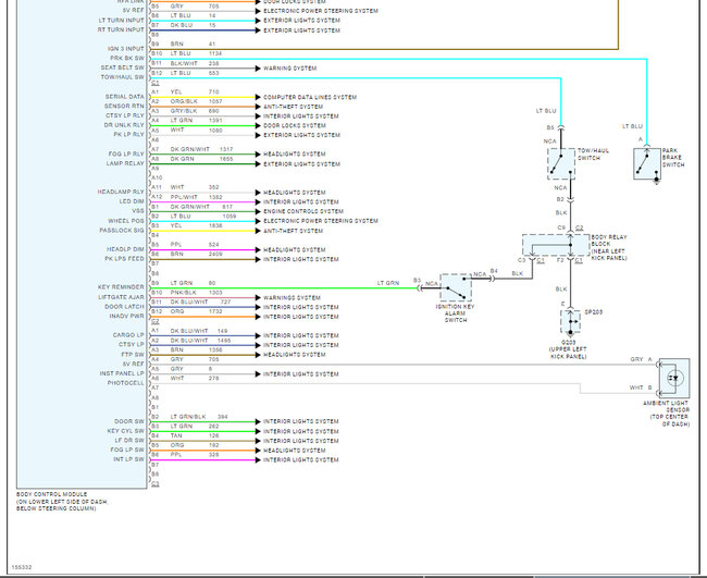

I recently purchased my vehicle listed above and I'm having issues. The daytime running lamps and fog lights don't work. The interior dome lights don't come on when opening the doors, but they do work manually as long as the key is in the on position. Some functions in the cluster don't work. Also, I found a loose connection to the cluster plug and resoldered the joints and found my message center unplugged from the board. After reconnecting it my security light stays on and the brake light keeps coming on and off while driving. I also bought 2 key remotes for the door locks but can't get the module in program mode to program the fobs. Have checked the bulbs and fuses and all are good. I already replaced the BCM, and it didn't fix any of my problems. Help, I'm at a loss and I really do not like dealing with electrical problems. Thanks in advance and any and all help will be greatly appreciated.
Sep 14, 2024 at 2:59 PM
  • 55,394 POSTS

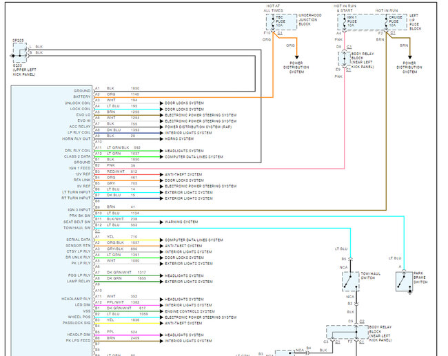

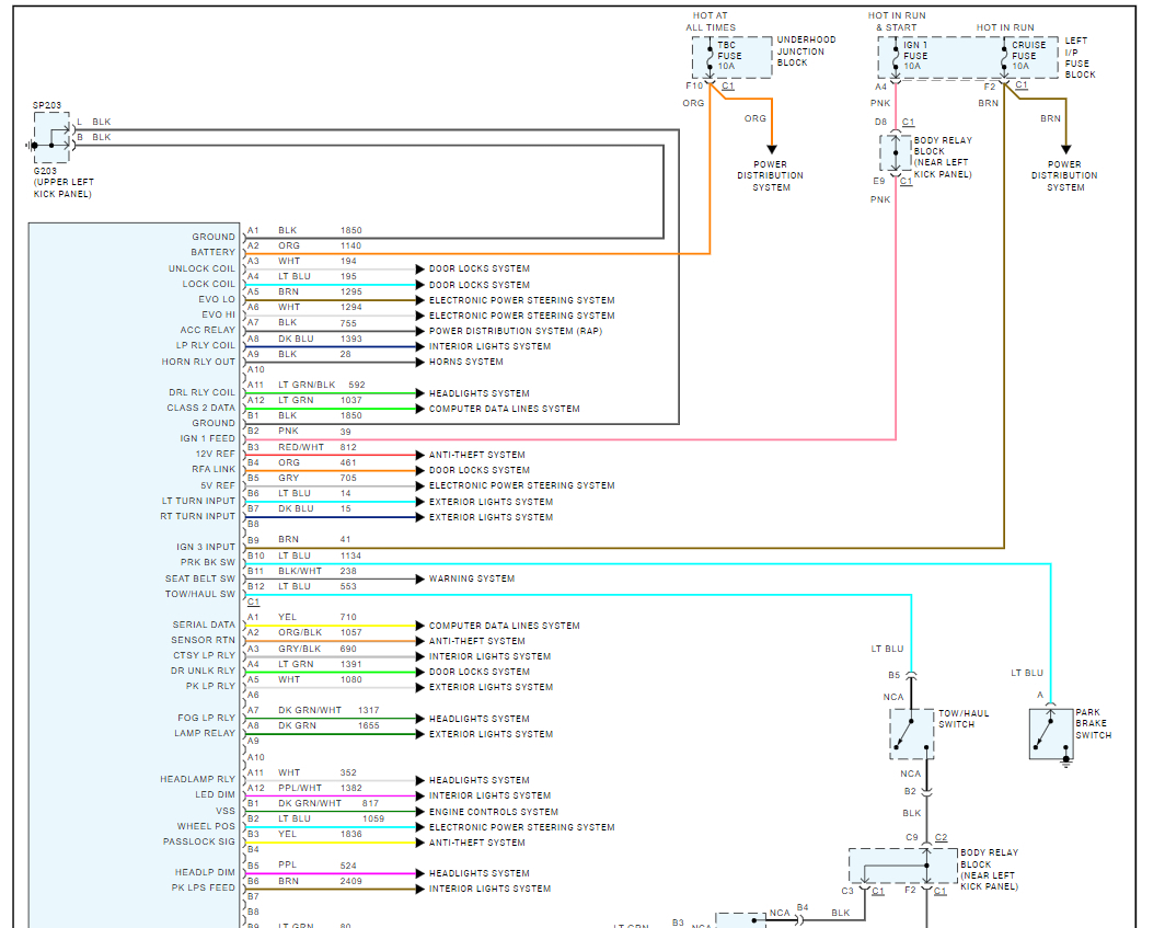

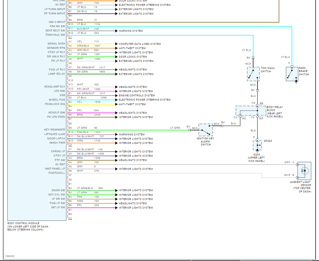

You were correct replacing the BCM which run all of these systems. I would run a CAN scan to see what codes are stored. Also, I would see if the BCM is getting power and a good ground. This guide can help, and I have included the BCM wiring diagrams below so you can see which wires to test for power and ground.
If the power and ground is good here is how to do a CAN scan. You can get a CAN scanner (Controller Area Network) which will work on most cars from Amazon.
https://youtu.be/u-4syLc-ifQ
Run the power test with the key on. Check out the images (below). Please let us know what happens.

It seems like the BCM is bad, but can I ask if the wiring has been tampered with? Here is a guide to help test the wiring for the BCM as well:
Please go over this guide and get back to us.

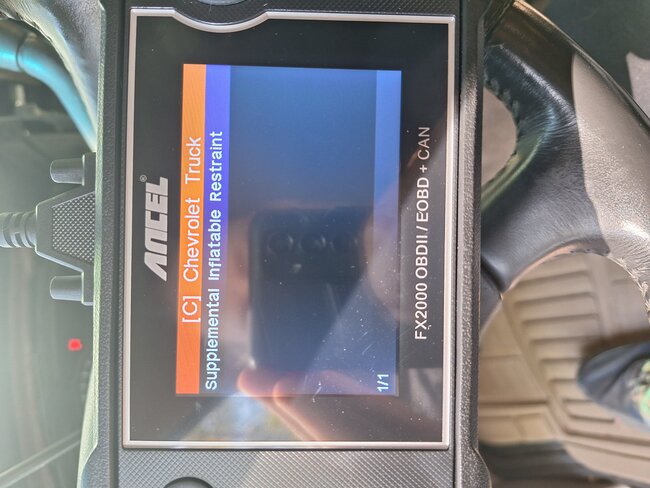

What about the modules showing up on the scan tool? I'm attaching a picture of it for you.

Does this model have a dash integration module and if so where is it located? When I bought the tahoe the blower motor was real noisy. I removed ot and found something had been in there making a nest. I was just wondering if that is where the dim module is around the glove box and maybe there might be some chewed wires. Thanks again for all your help.
Oct 15, 2024 at 5:09 AM
  • 55,394 POSTS
It looks like you may have found the problem, mice like to eat the wiring. You may need to remove the dash and do a main wiring harness inspection.

Ken, I got some news on what I was able to find this evening. I tested battery voltage at the dlc and it was good......I then moved to the bcm and removed the brown plug and tested the power and ground at the bcm and it had no power. I removed the cover for the underhood electrical box and low and behold I found a orange wire broken, chewed, etc. I had to add a price of wire because they were to short like a piece was missing. Now my auto headlights are working, daytime running lamps working, key in switch chime working, bright light indicator in cluster, and a few other things. I still don't have overhead lights when the doors are opened or when you turn them on and fog lights are still inop. Sorry for the long reply. Just wanted to give you a heads up on what I've found so far. Thanks again for the help. I'll update as I'm able to test other things out.
