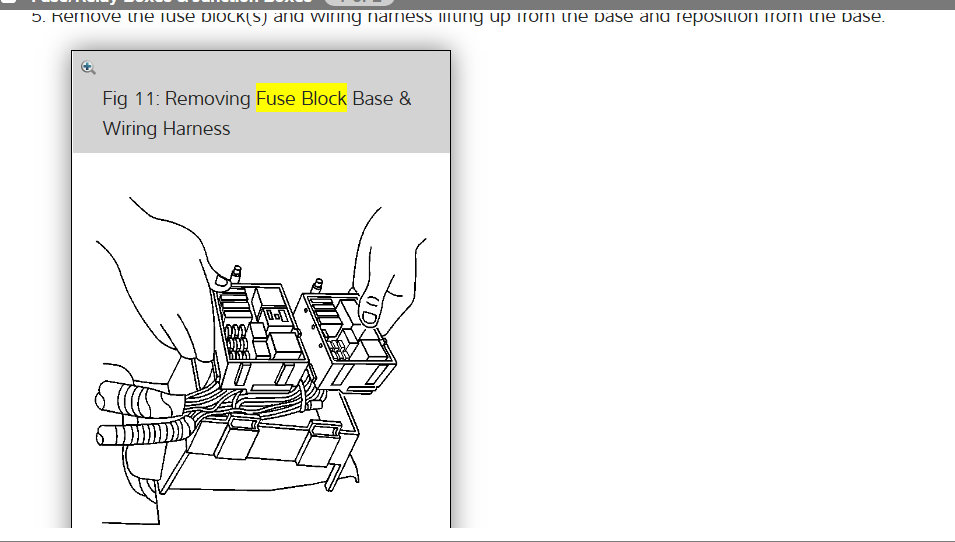

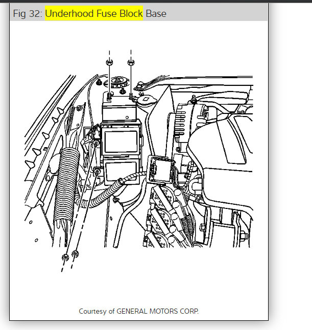

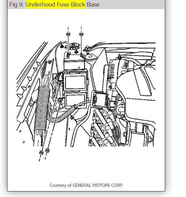

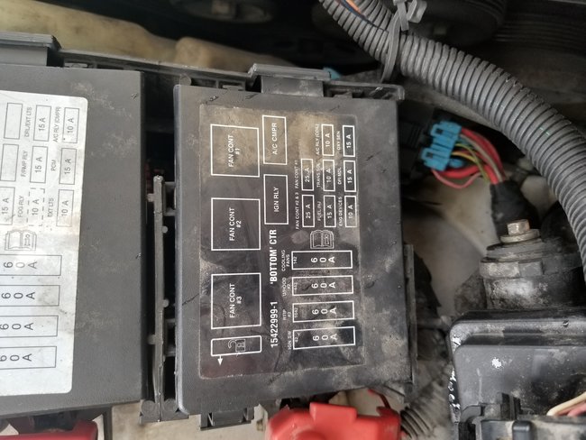

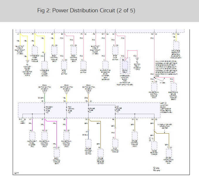

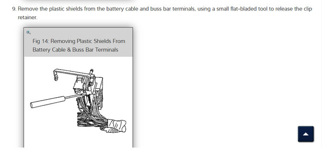

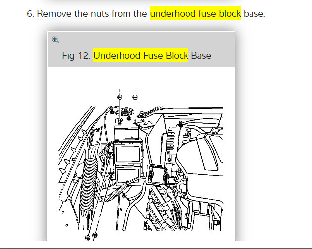

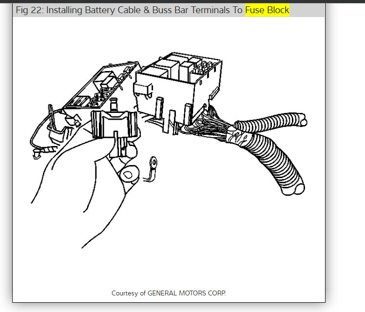

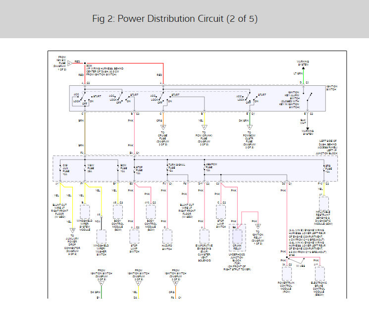

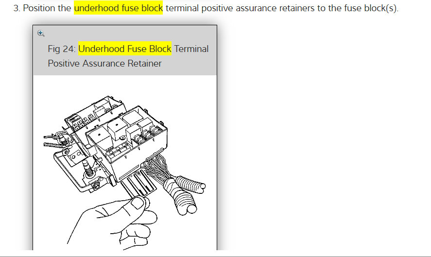

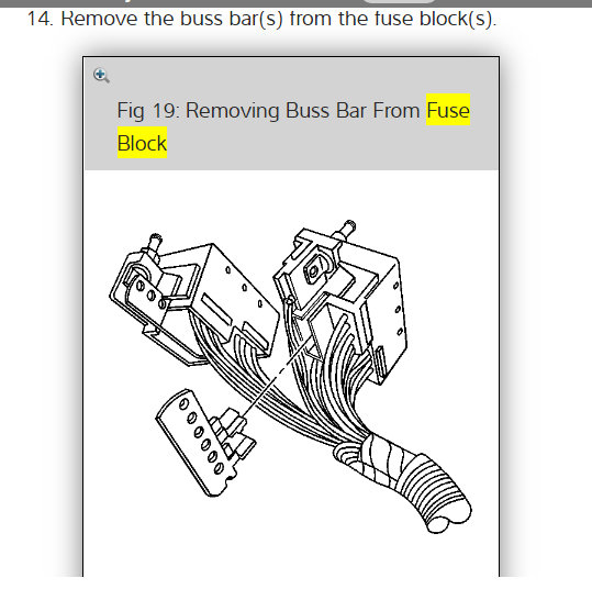

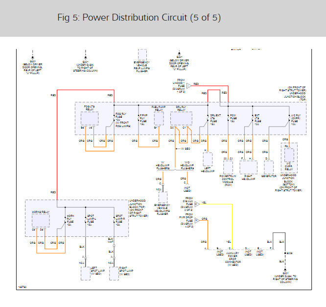

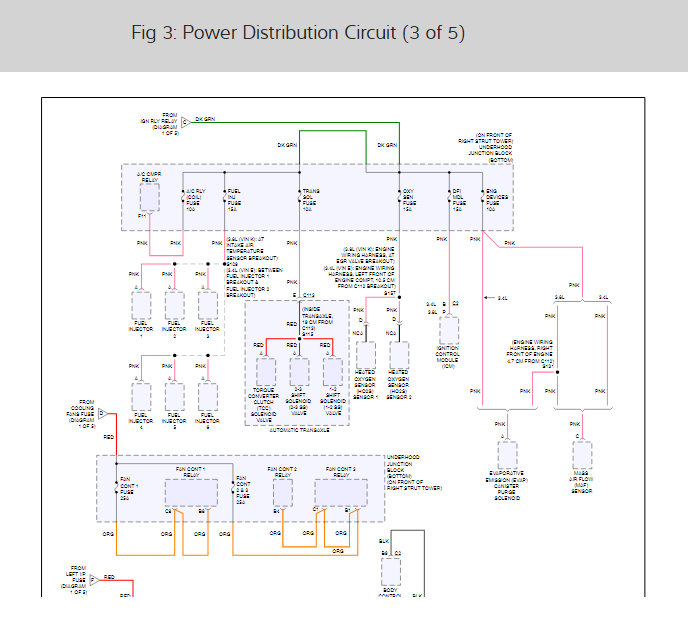

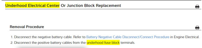

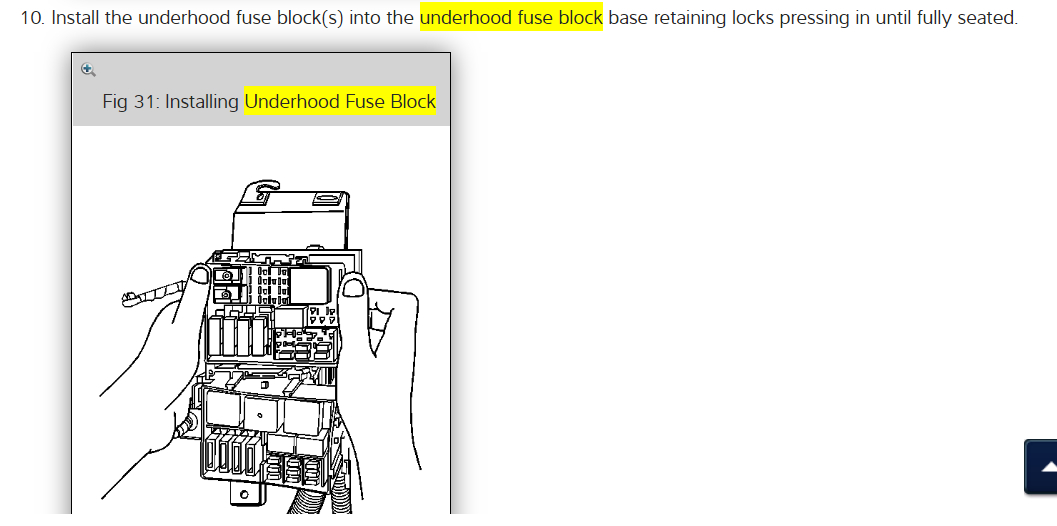

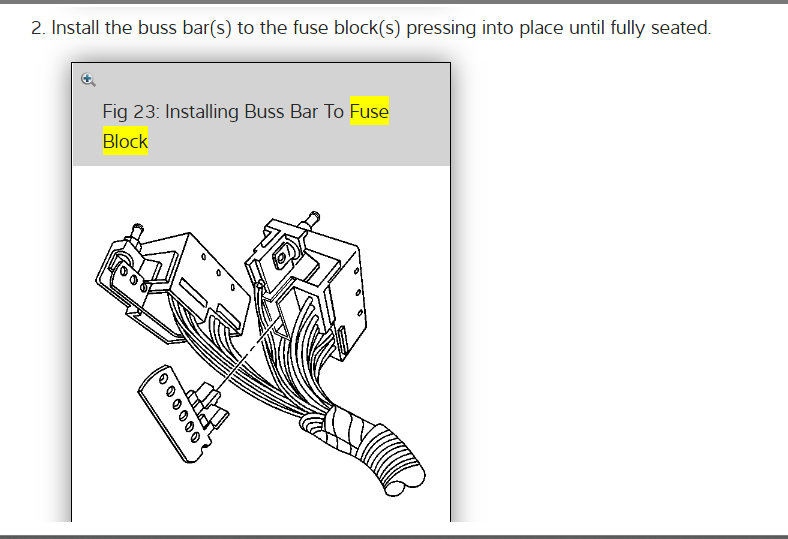

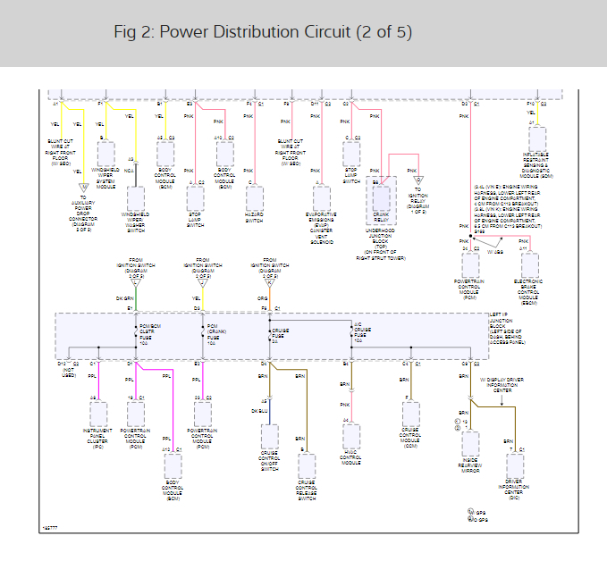

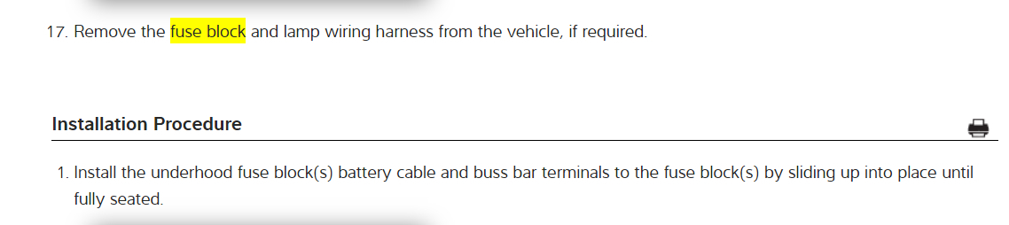

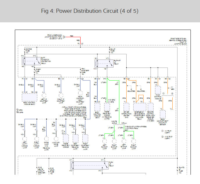

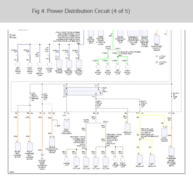

For some reason I have no power going to 6 of my fuses. the bottom 6 on the cover of the fuse box starting with fuel injection and ending with oxygen sensor. All 6 fuses are good. I have power coming from the battery into the fuse box. The rest of the fuses in the box all have power. What threw me for a loop is that one fuse that has no power is ENG Comp which is supposed to supply power for various things such as the MAF sensor. Pulling the connector from the MAF sensor and I tested it for power which it has??? Help
Aug 23, 2019 at 2:19 PM
SCGRANTURISMO
  • 4,897 POSTS

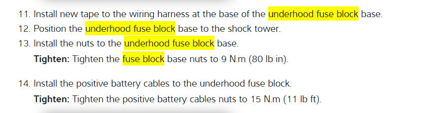

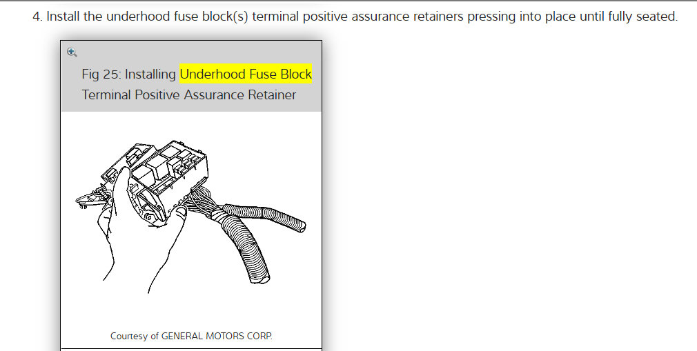

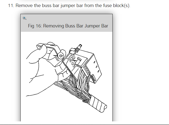

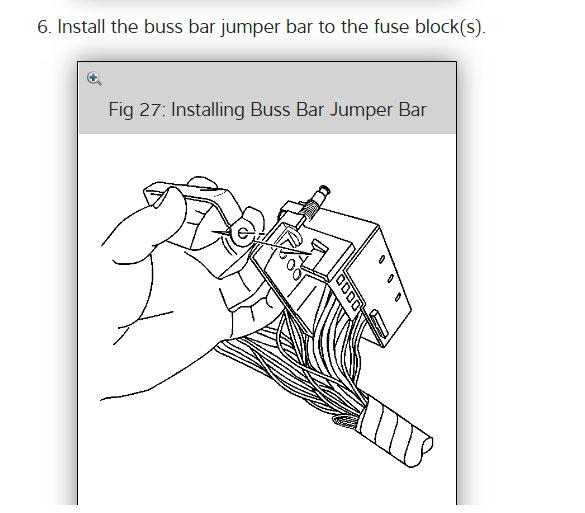

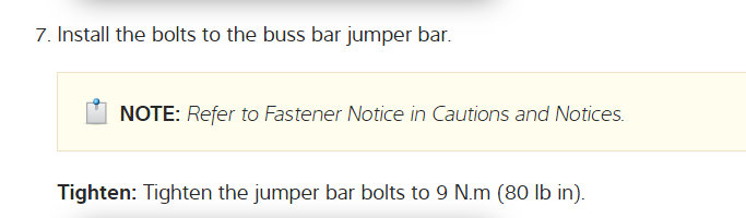

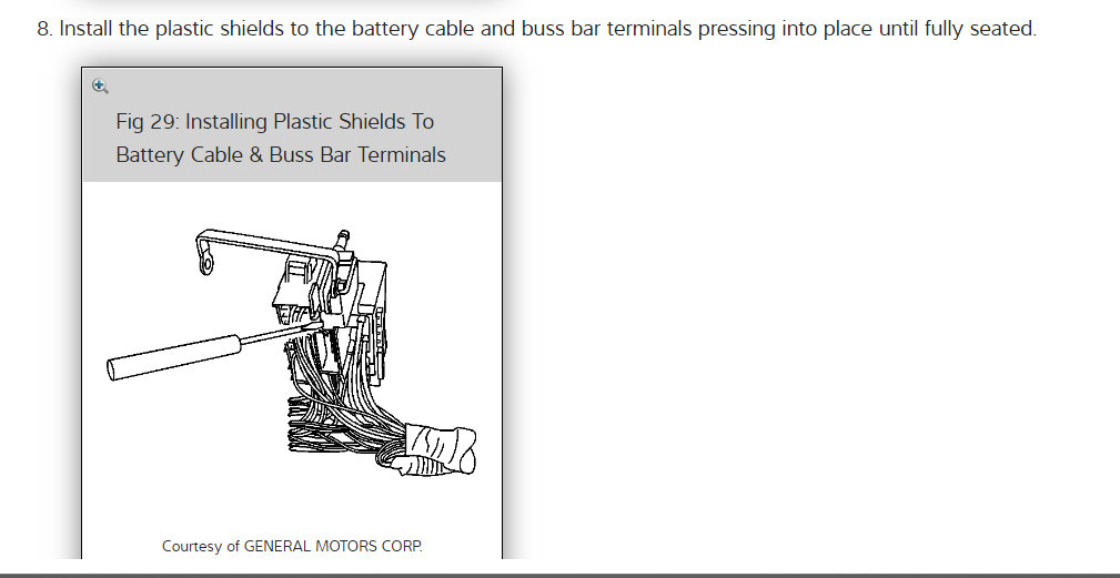

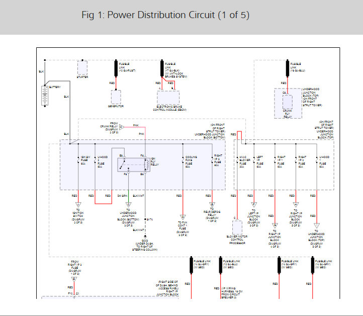

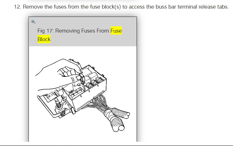

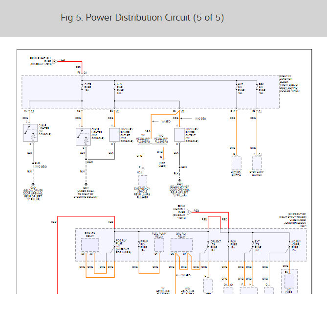

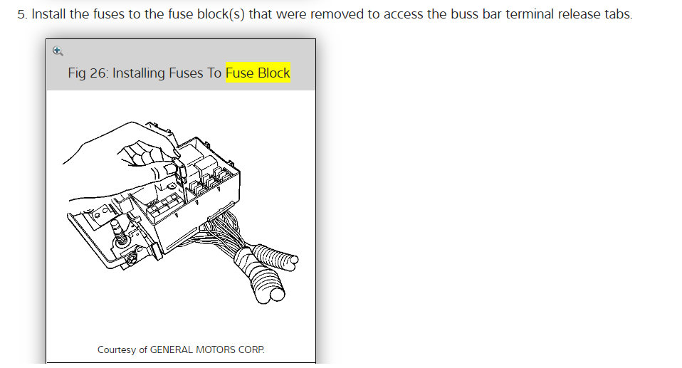

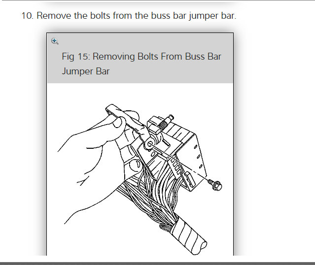

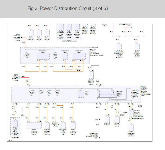

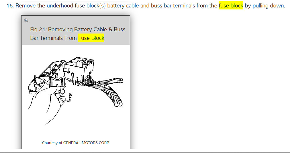

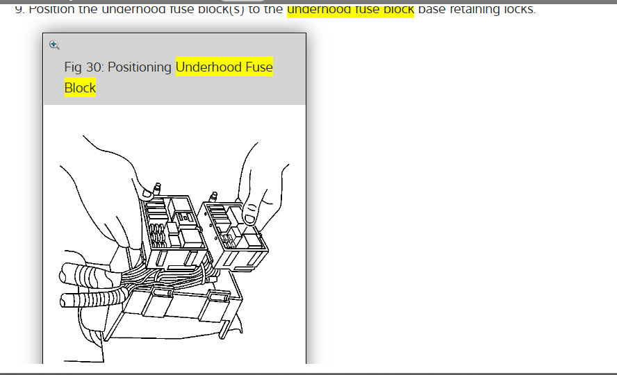

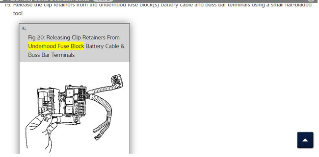

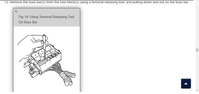

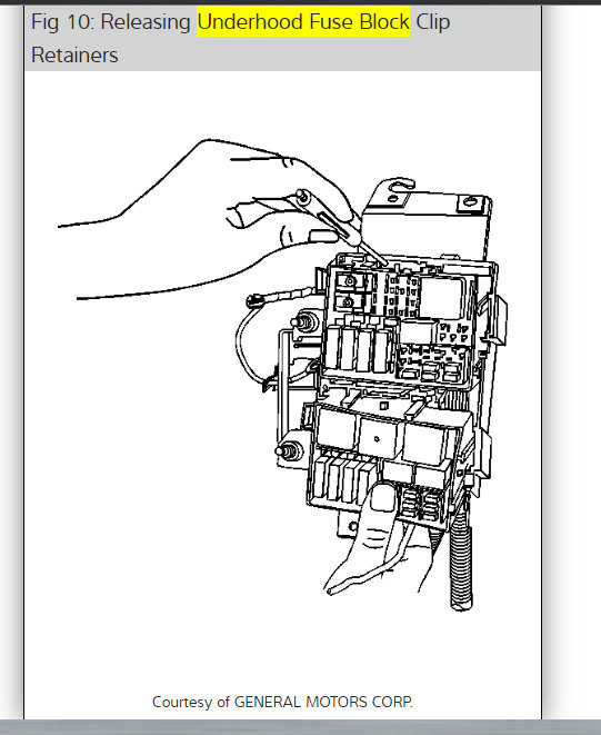

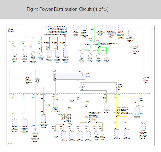

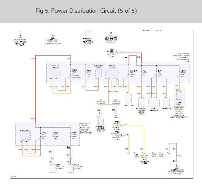

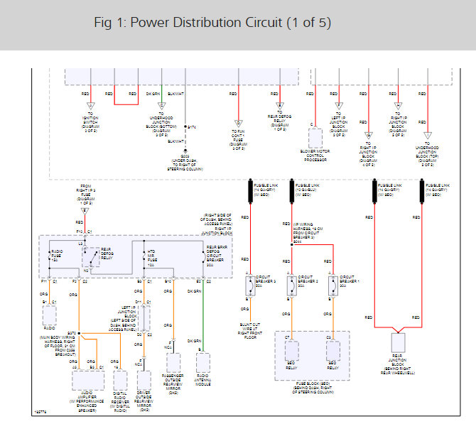

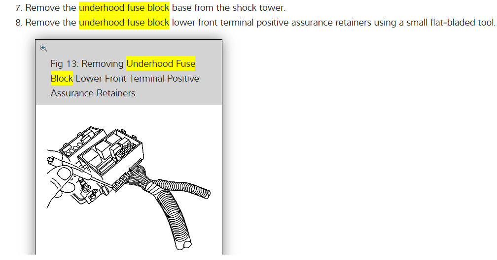

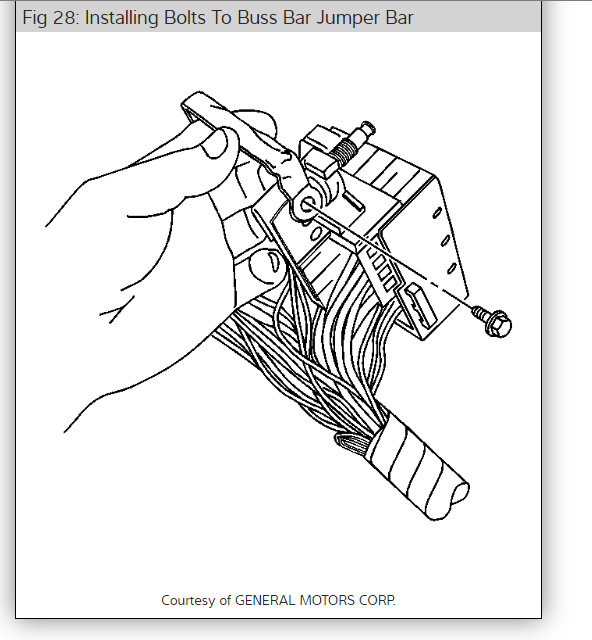

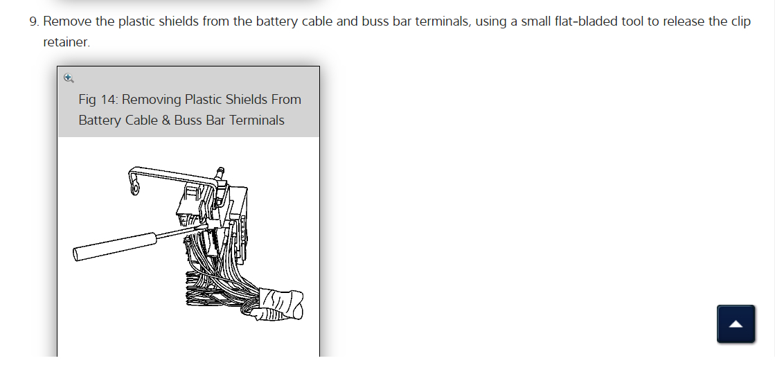

It sounds like you have a bad connection to the bus bar in the fuse box. In the diagrams down below I have included the Power Distribution wiring diagrams for your car as well the instructions for the removal and installation of the fuse box in question. Please go through these guides and get back to us with what you are able to find out.
Thanks,
Alex
