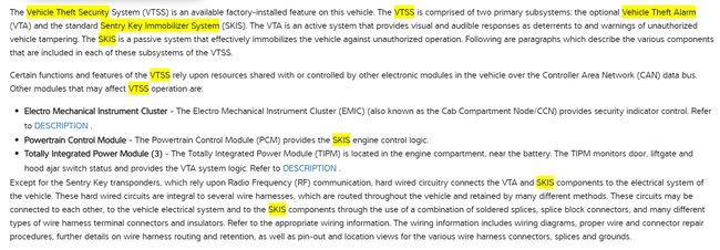

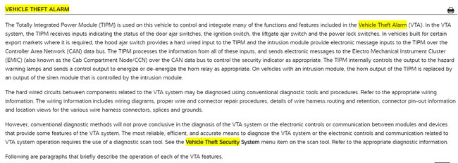

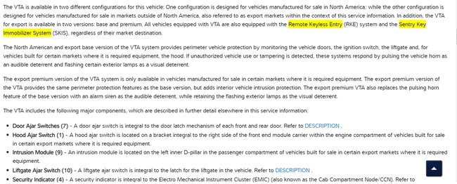

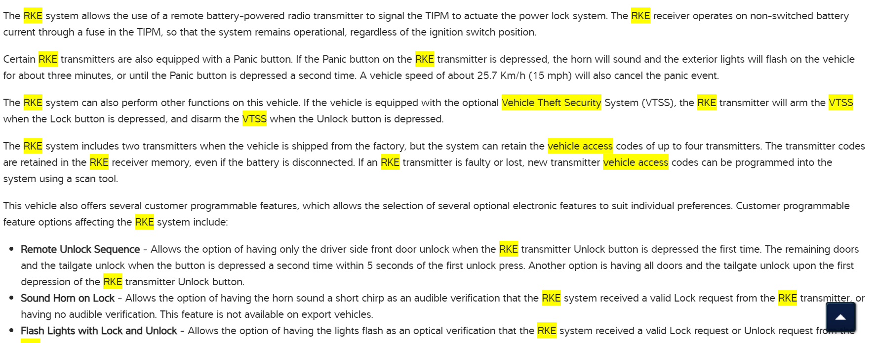

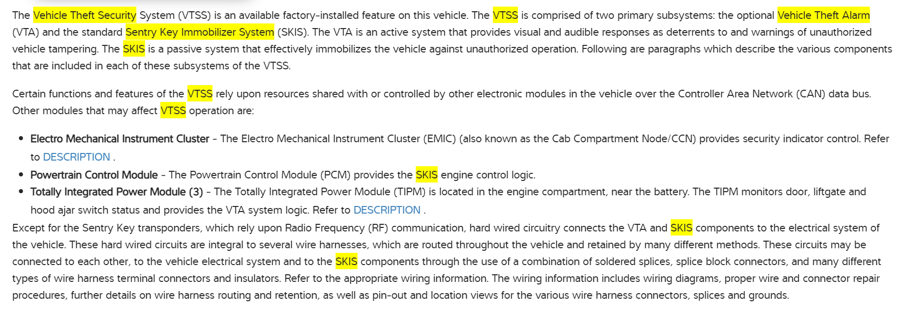

Okay, and you verified the wire colors to make sure it was the security system I assume?
So where do you stand at this point? Did you try starting it yet?
And again, I will add info while waiting for your response.
I added some information on the security system I thought you should have.

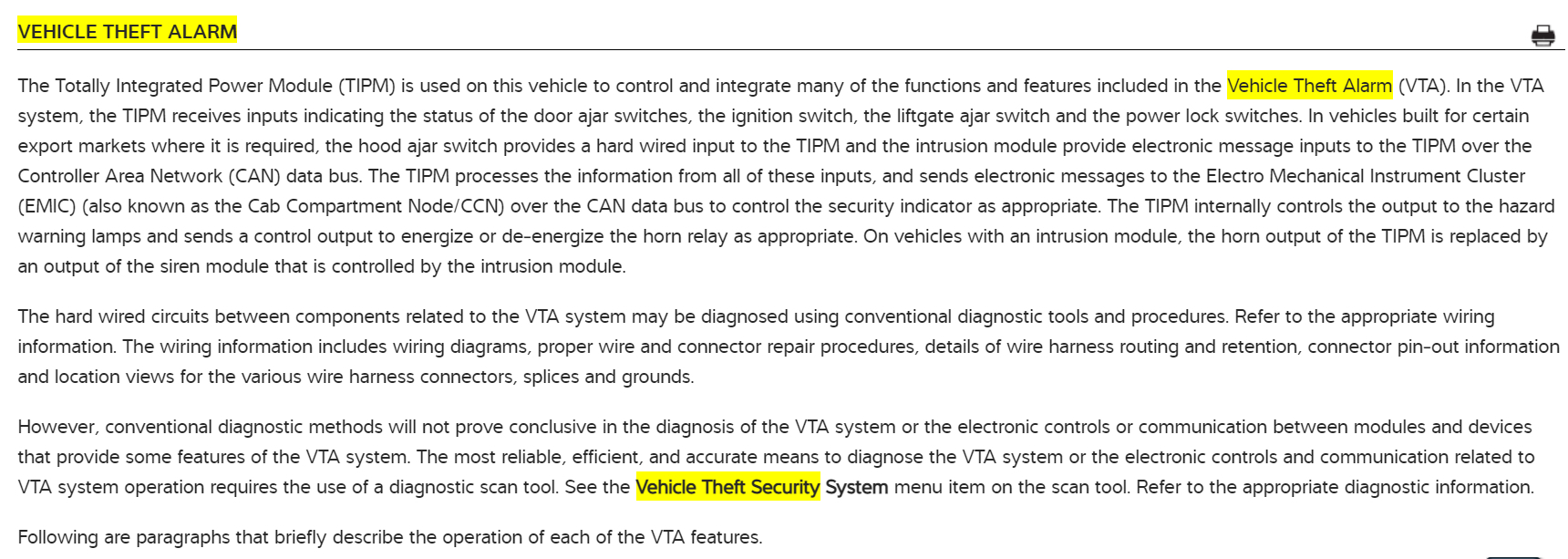

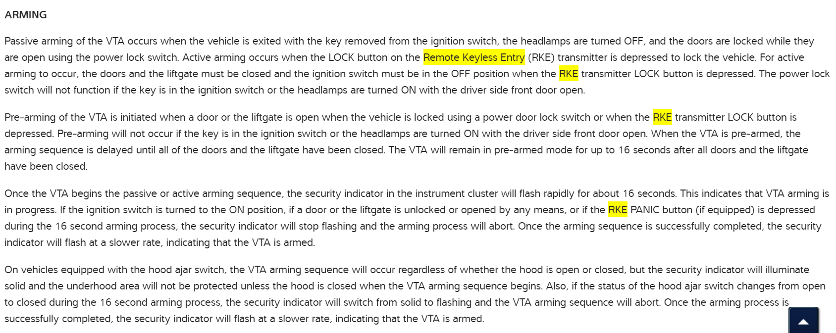

In the fifth page you'll notice it talks about the flashing of the red security light and what it means. After locking the vehicle fully the light will flash a steady slower flash.
During its arming sequence it will flash for 16 seconds fast, then slow once its finished.

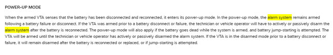

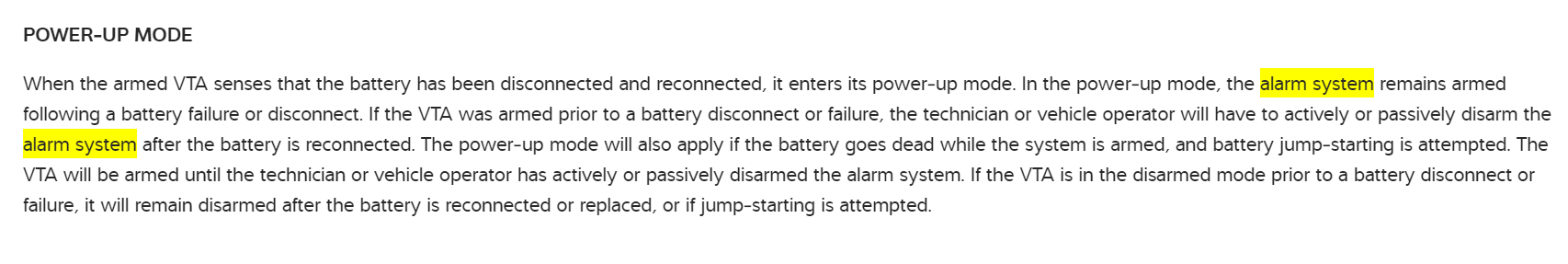

The last page is info on if the battery is disconnected or during a jump start condition.
