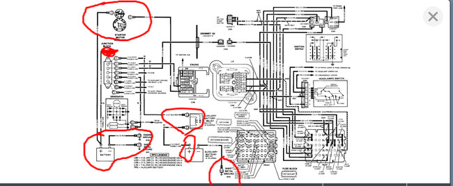

I have the truck listed above k1500 that has an odd issue where if you turn the steering wheel to a certain position, let’s say 11 o’clock on the wheel, all the power in the truck shuts off and if the truck is running it will also shut the truck off turning off power to the fuel pump and probably everything else to. I have replaced the ignition switch on the column (didn’t work) and I have torn the column down to the point where you have to pull the two pins out of the sides of the column and can’t find any issues yet. Is it possible that the rod that goes from the ignition switch to the key lock cylinder is getting caught up or the rod is broken or bent?

TOUGHDIVER
  • 226 POSTS
From your video you supplied us it looks like you are loosing complete system voltage when you turned your steering wheel. I would double check all battery cables, positive side and negative side on both ends. On the engine, frame, body and starter, and Battery. Check and make sure you have a good clean and tight connections.I am including a wiring diagram below and marked the connections to pay special attention too. Also check around the bell housing with a good flash light. I hope this helps you out and please let us what fixed it.
Thank you
Joe Terwilliger
Dec 13, 2019 at 2:01 PM
COLLIN LACOBELLI
  • 11 POSTS
I ended up finding the problem today after finally getting a warm day to look at the truck. I found the frame to firewall ground strap had broken and the block to frame ground strap could not even be found. so I put on new ones and the problem was gone.
