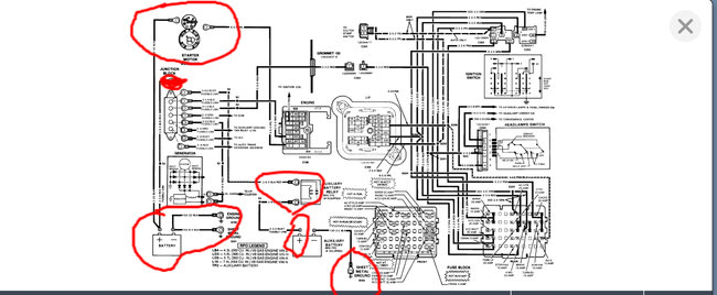

TOUGHDIVER
  • 226 POSTS
From your video you supplied us it looks like you are loosing complete system voltage when you turned your steering wheel. I would double check all battery cables, positive side and negative side on both ends. On the engine, frame, body and starter, and Battery. Check and make sure you have a good clean and tight connections.I am including a wiring diagram below and marked the connections to pay special attention too. Also check around the bell housing with a good flash light. I hope this helps you out and please let us what fixed it.
Thank you
Joe Terwilliger
Dec 13, 2019 at 6:01 AM
COLLIN LACOBELLI
  • 11 POSTS
I ended up finding the problem today after finally getting a warm day to look at the truck. I found the frame to firewall ground strap had broken and the block to frame ground strap could not even be found. so I put on new ones and the problem was gone.
