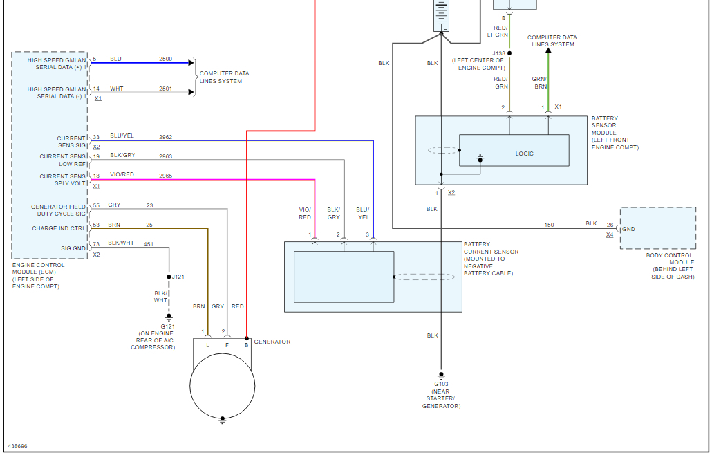

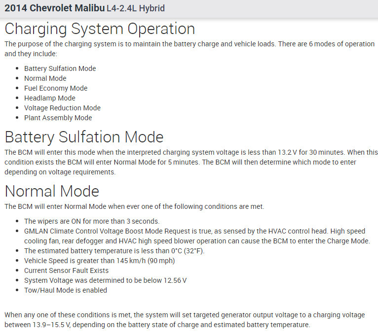

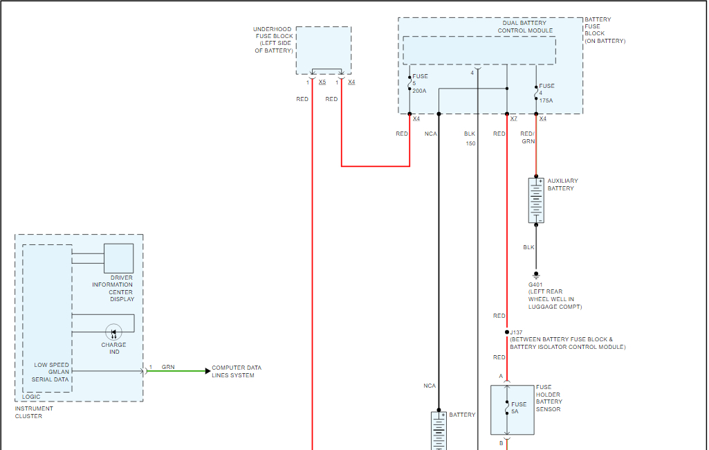

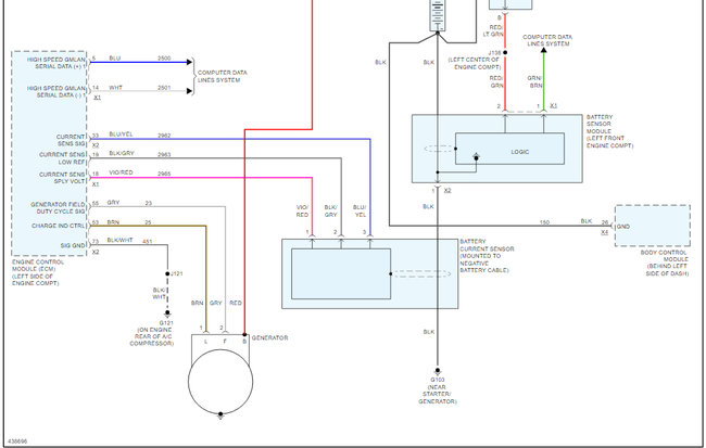

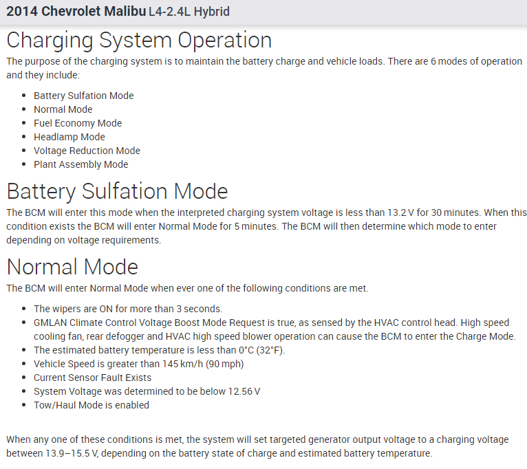

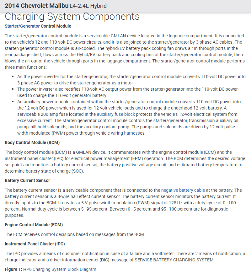

You could have a excessive parasitic draw (current drain) on the battery. Which can be draining it over time and making the battery go bad.
Every circuit with a battery will have little parasitic draw but it becomes excessive due to any electrical circuit (like a glove box light staying on or a shorted out window switch), it will drain the battery faster.
https://www.2carpros.com/articles/car-battery-dead-overnight

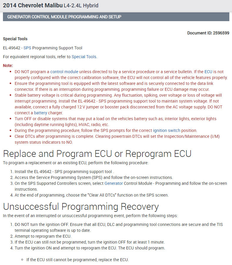

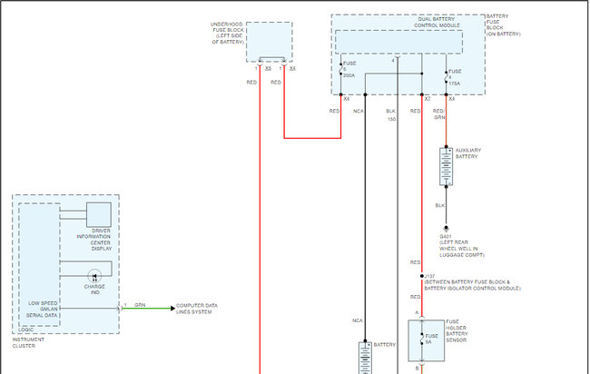

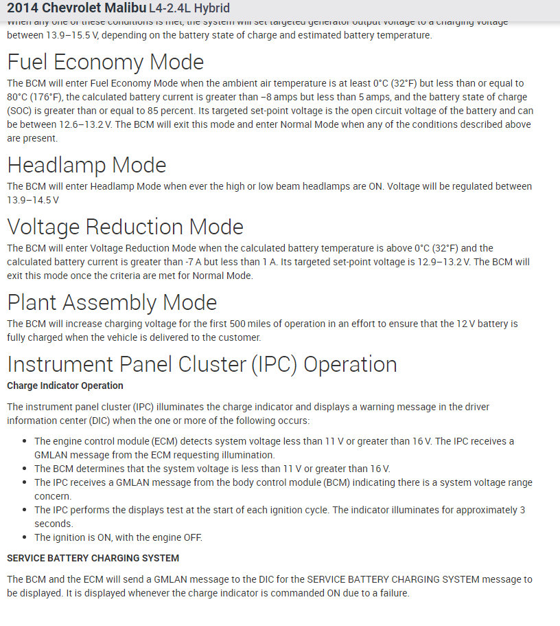

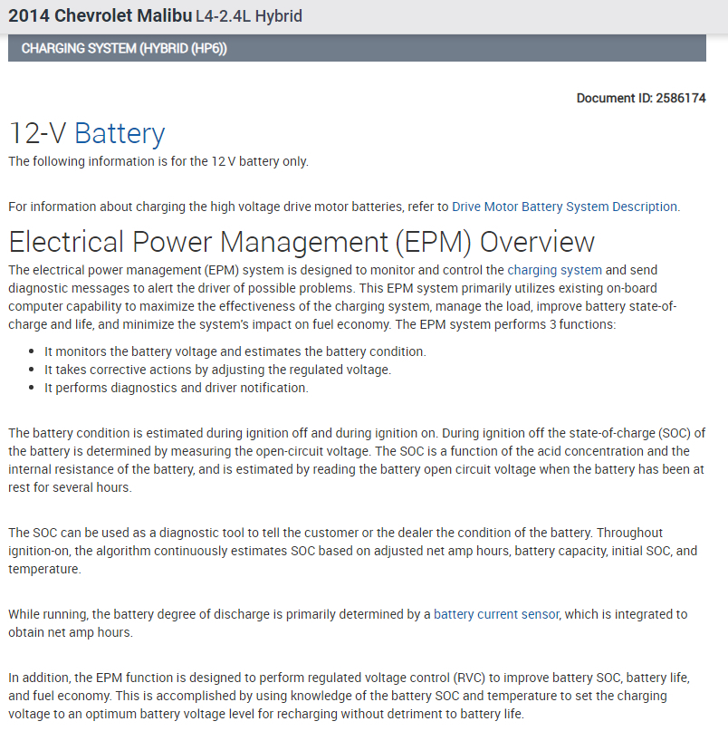

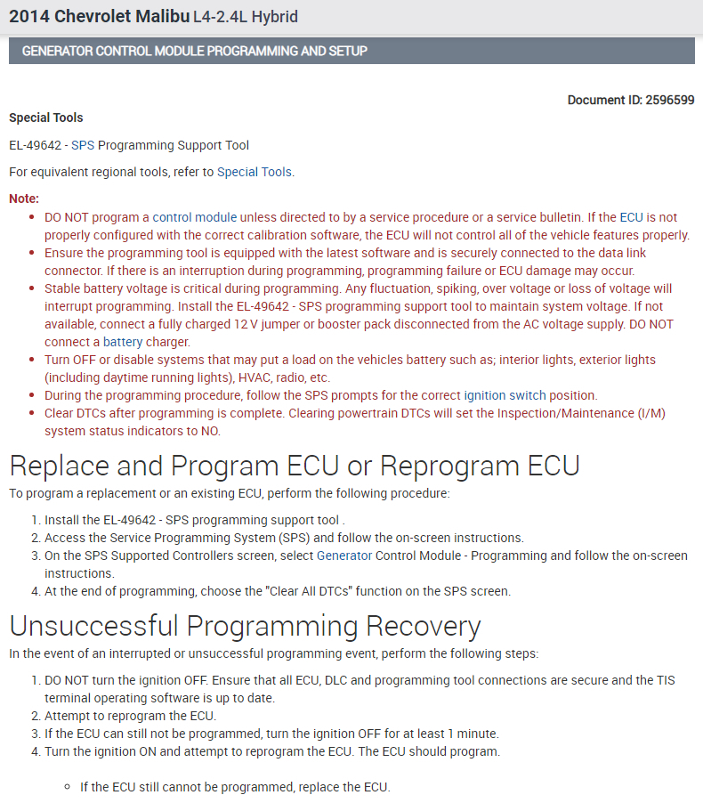

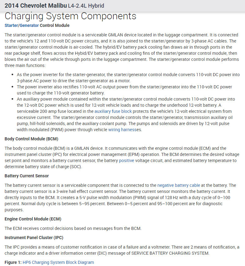

It can also be a wiring issue that preventing the alternator from properly charging the battery.
This can also be due to the control module for the charging system.
Just to clarify, the second time when this happened. Did the alternator tested bad on the vehicle or was the alternator tested out of the car?
If it got tested bad out of the car it could be just a bad alternator.
