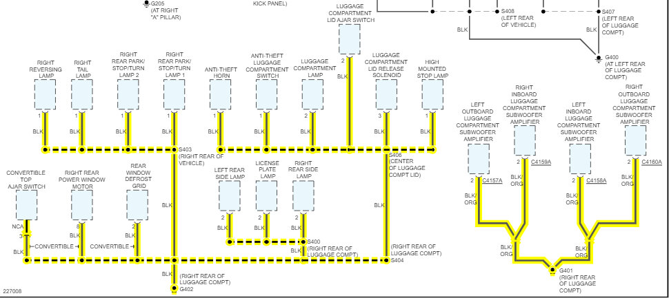

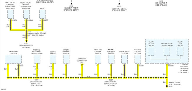

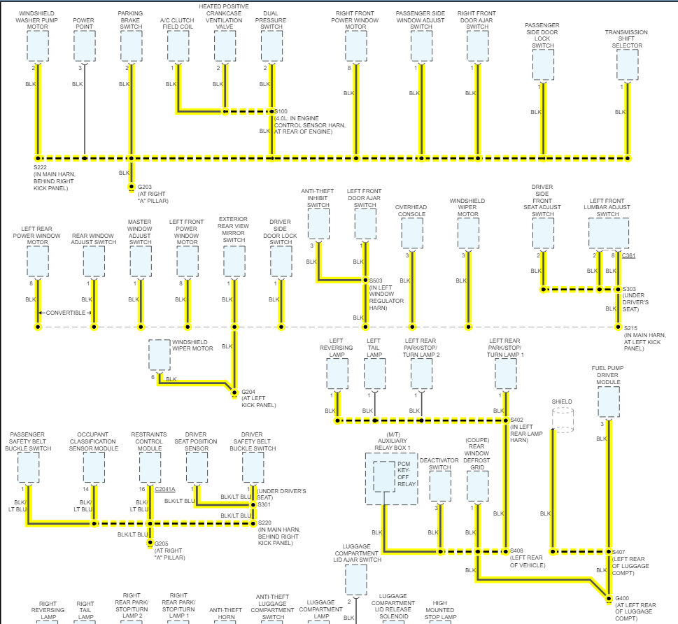

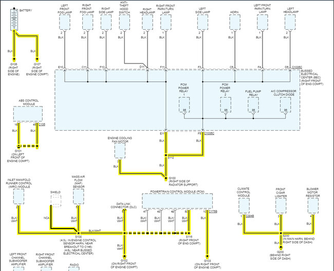

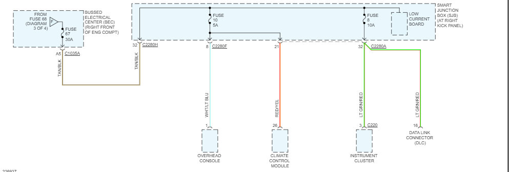

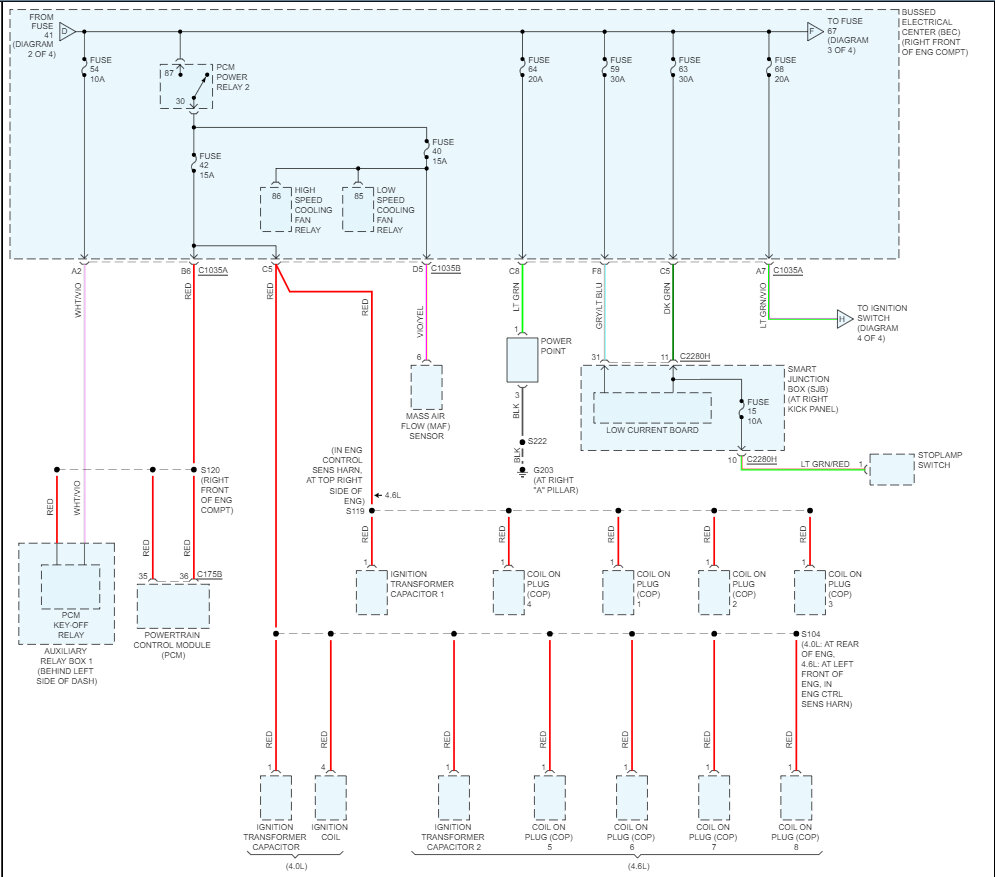

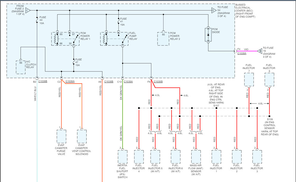

Diagrams 1 and 2 go together, top and bottom, and same for 3 and 4. These are the Grounds for the entire vehicle. Ill post the powers as well. And if you need anything specific, just ask.

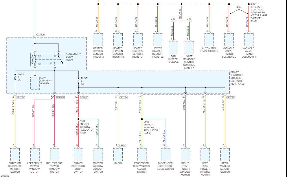

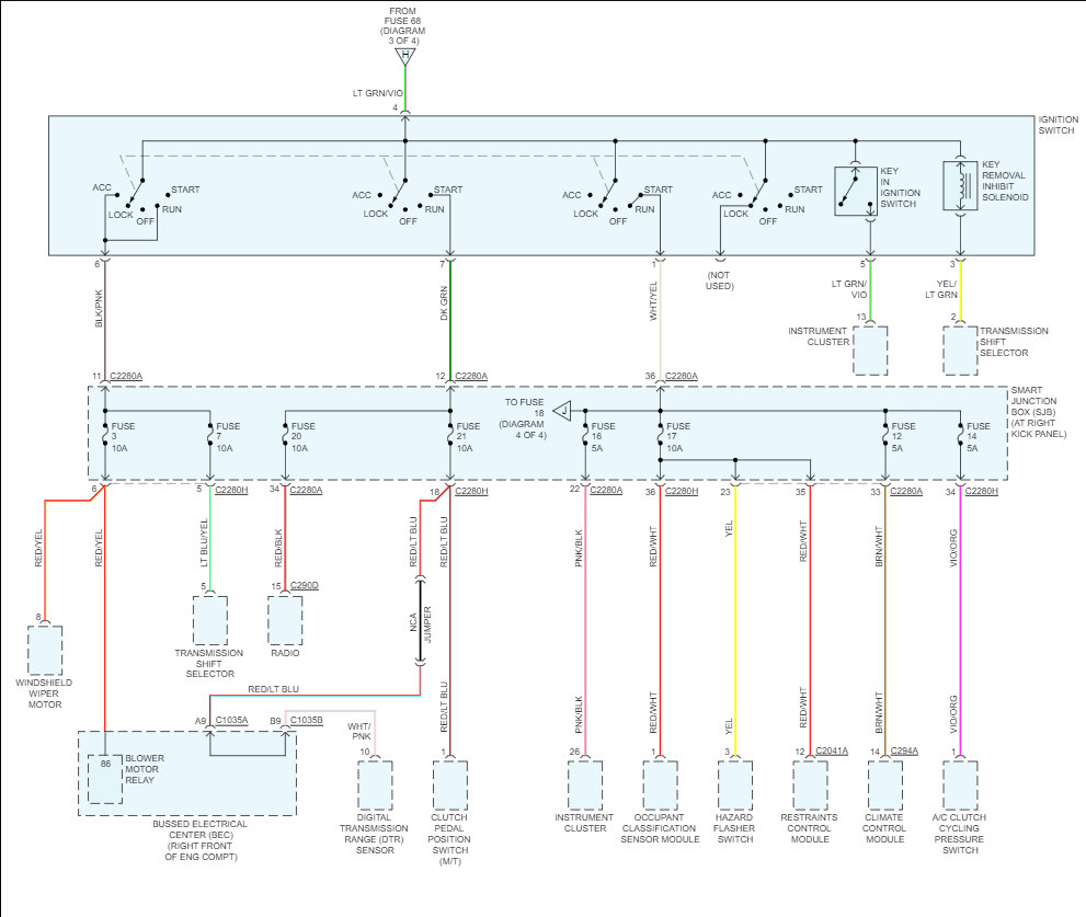

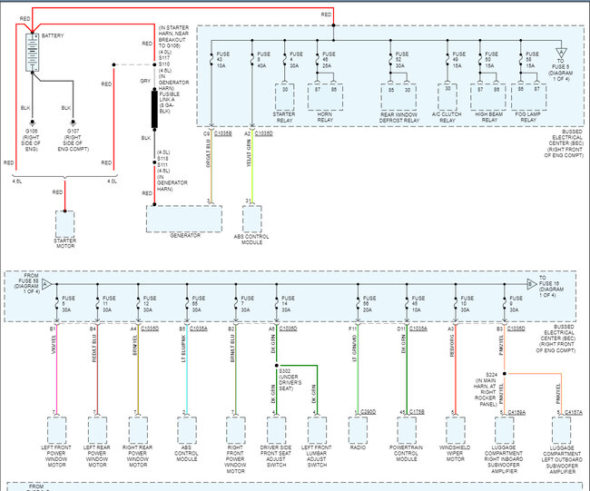

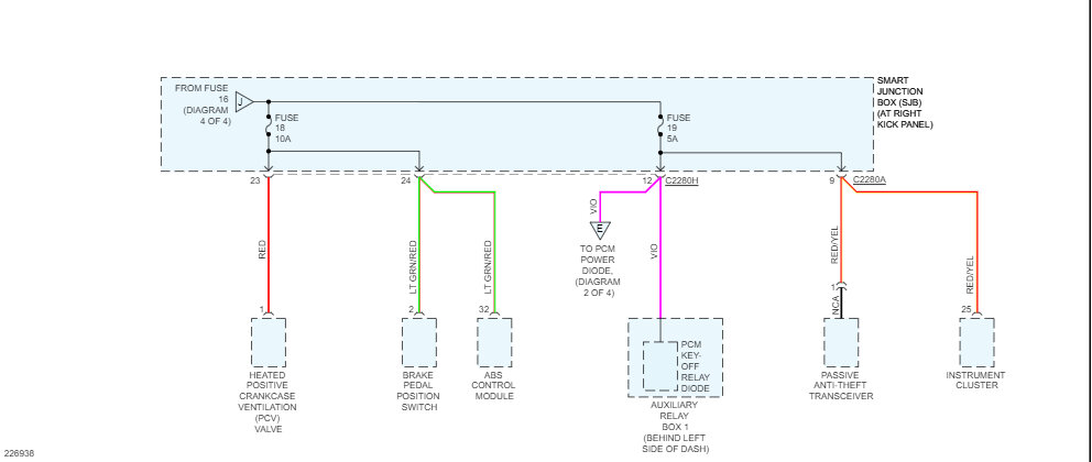

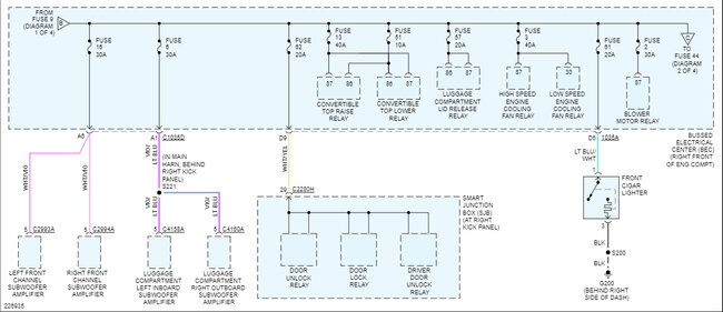

The Power diagrams are 6,7- 8,9 -10,11 -12,13 top and bottom if you want to print them out.
Is the fuse panel youre looking to replace the interior one, on the driver side lower kick panel? This is a Smart Junction box, meaning it is integrated into the vehicles CAN Bus data network, and communicates with the Radio and Instrument Cluster, just something to be aware of. Most times when modules like this are replaced, they need to be programmed or have the data and VIN number from original module uploaded to the new module.
