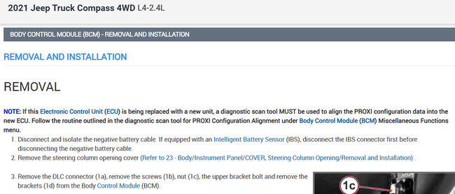

Yep, sorry about that, it sounds like the battery was jumped backwards. Can I ask when you checked the fuses for the system did the fuses have power with the key on?
This guide can help:

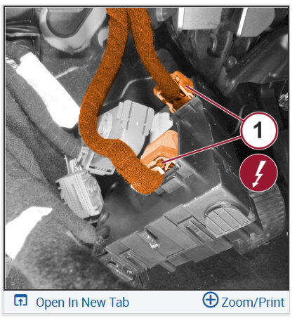

If not, I would check the codes for the CAN because it sounds like the BCM has shorted out. You can get a CAN scanner (Controller Area Network) which will work on most cars from Amazon.
https://youtu.be/u-4syLc-ifQ

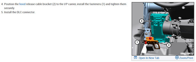

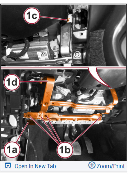

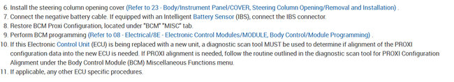

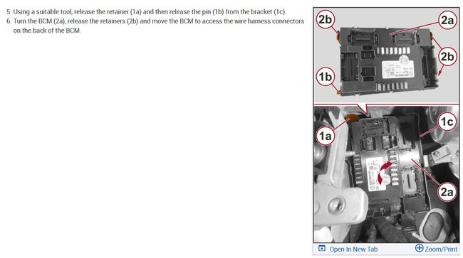

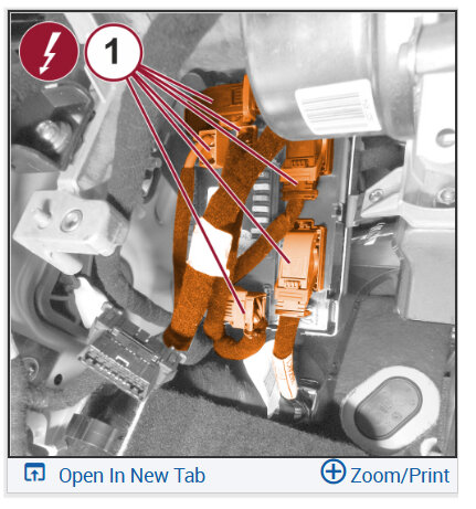

Here is how to change out the BCM, you can get a preprogrammed unit by searching Google or Ebay. Check out the images (below). Please let us know what happens.
