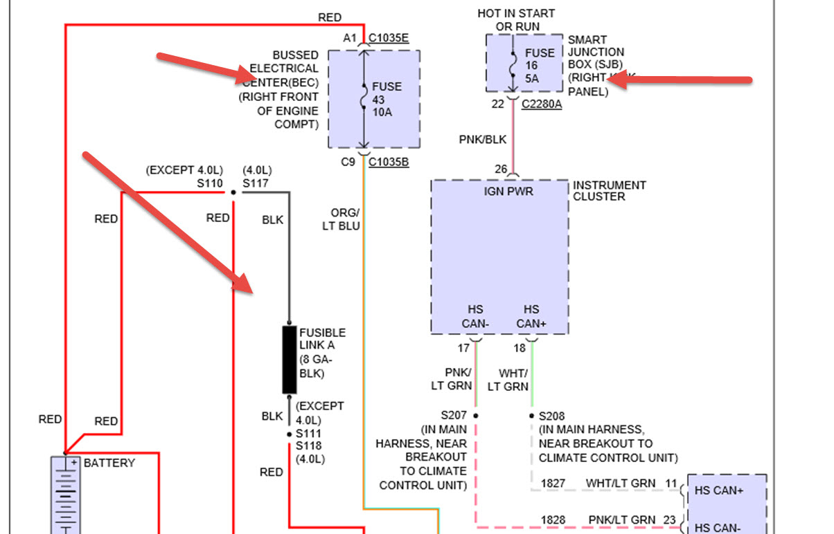

I have replaced the battery and alternator and light for the battery came on and the car slowly started dying down.
Jul 6, 2016 at 9:28 AM
HMAC300
  • 48,601 POSTS
check the fuses and fusible link in picture any of them will effect whether your car charges or not. also recommended replacement of belt and tensioner is 60,000 miles which most of time if bad will not charge at idle or low rpm's. This guide can help us test the alternator
Check out the diagrams (Below). Please let us know what you find.
