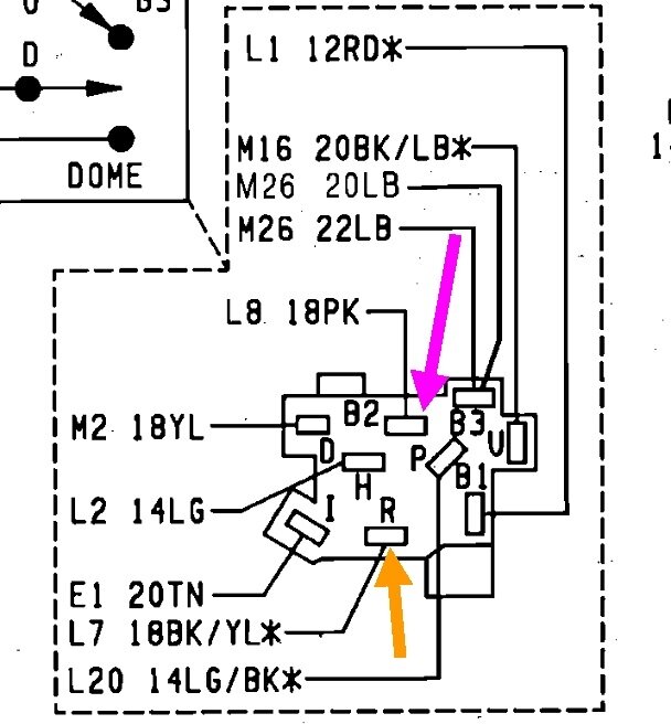

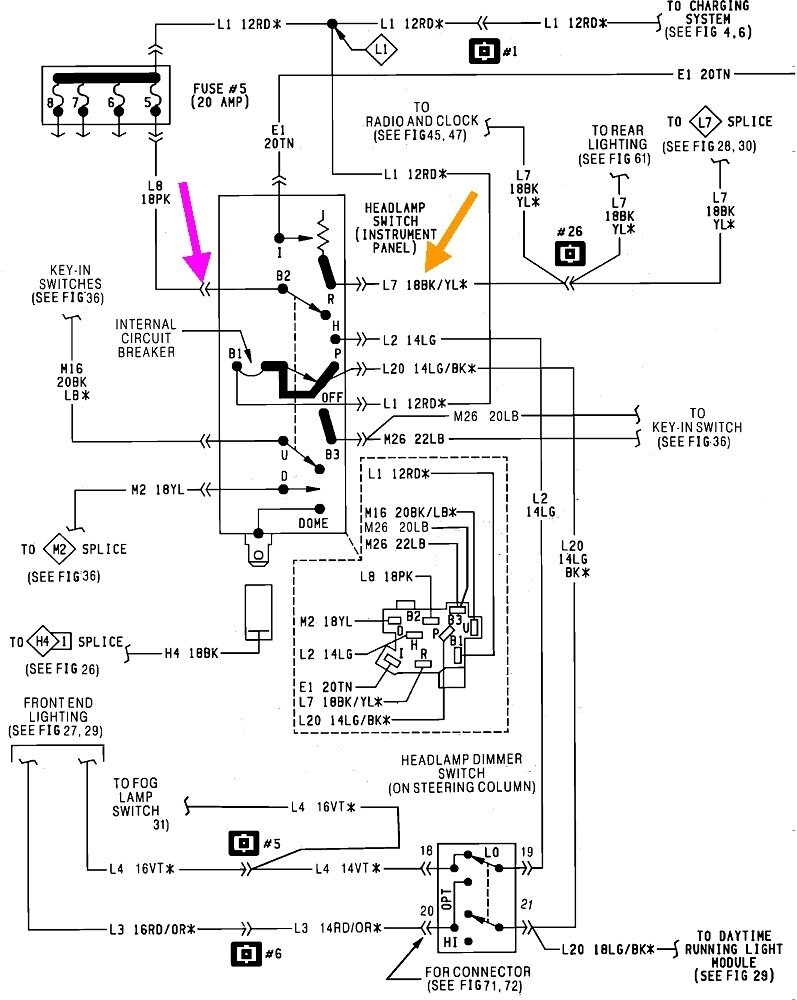

I replaced the headlight switch; it had a lifetime warranty, so I've swapped it out three times trying to fix the issue with my running lights. Whenever I pull the headlight switch all the way out to turn on my headlights, headlights come on, but the running lights do not. If I am pushing the switch back in just a little bit, the headlights will go off, but the running lights will come on. When I originally replaced the switch, I had running lights and headlights working fine. When I mounted the switch back to the dash is when I lost running lights when the headlights were on. So, after swapping the switch out I left it hanging without mounting it to the dash and still headlights come on running lights do not push the switch a little, but headlights go off run lights come on. I found a truck in the salvage yard with the same headlight switch bought it, put it on my truck and I got nothing that switch. So, I put the new one back on it. I thought maybe it might be a ground issue, but I can't find any issue with the ground, and it wouldn't make sense because I am able to get running lights and headlights but not at the same time. This has me absolutely stumped.
Apr 6, 2023 at 11:14 PM
CARADIODOC
  • 34,321 POSTS
You're describing exactly what usually happens when the original switch contacts overheated. The place to start is by inspecting the terminals in the connector and on the original switch, if you still have it. Most commonly two contacts develop pitting from repeated arcing, then the resistance causes heat to be developed. That heat causes resistance, and that promotes more overheating that migrates out to the terminals and causes them to overheat. The repair requires the new switch, and replacement of those two overheated terminals. I prefer to cut out the two terminals and the melted plastic around them, then the plug can be reconnected without them. The two wires will have become hardened for about the first four inches, and solder won't adhere to that. Cut that four inches off, splice in new pieces of the same gauge, then install a pair of universal crimp-style spade terminals, but solder them too for a better connection. Plug those two wires onto the switch individually.
This usually happens to the headlight wires, the two for the "accessory" section of the ignition switch, and to heater fan switches. They can all be repaired the same way. If you don't find those two overheated / darkened terminals, we'll start next with a couple of voltage tests. Do you have a test light or voltmeter?
Let me know what you find.

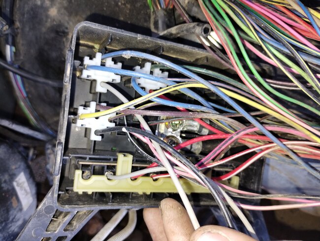

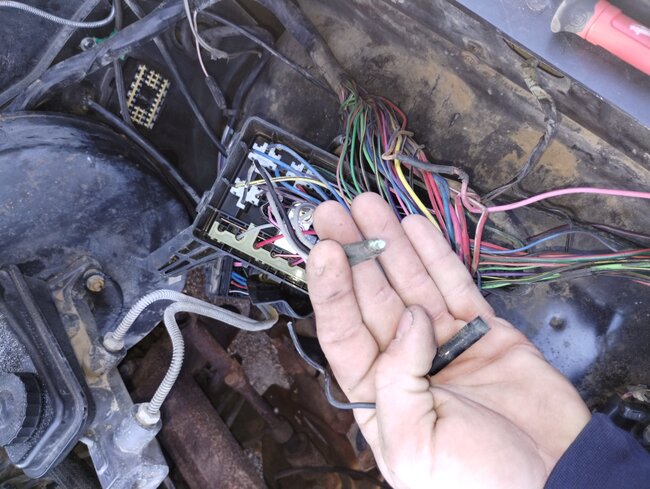

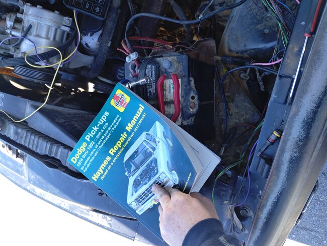

Nowhere in this manual can I get a wire point of reference to either the back of the relay box or for the bulkhead connector. So, I cut back the tape and separated the wires and these three wires and this little black wire what looks like to be a fusible link now whenever I pull back the tape it was already smoked, and it was just kind of laying there on top of the wires. So I bought a manual because I can't find anything online and it seems to be something specific to this model of engine this is a 91 5.2 l LA V8, the three wires go the black to the starter relay the white or light gray wire goes to the 30 amp AC clutch fan fuse, the gray goes to the AC clutch relay. Also, without a passenger side fuse compartment the two things that are mainly different on the engines is the wiring seems to be in a 1990 nothing found on a 91 this summer to this as far as the wiring diagram on the fuse box. Also, this truck does not have a crankshaft position sensor! I need to know the point of reference at least in the book or the bulkhead wire diagram for this specific truck.

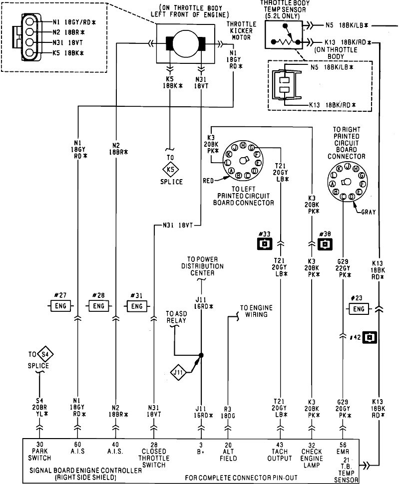

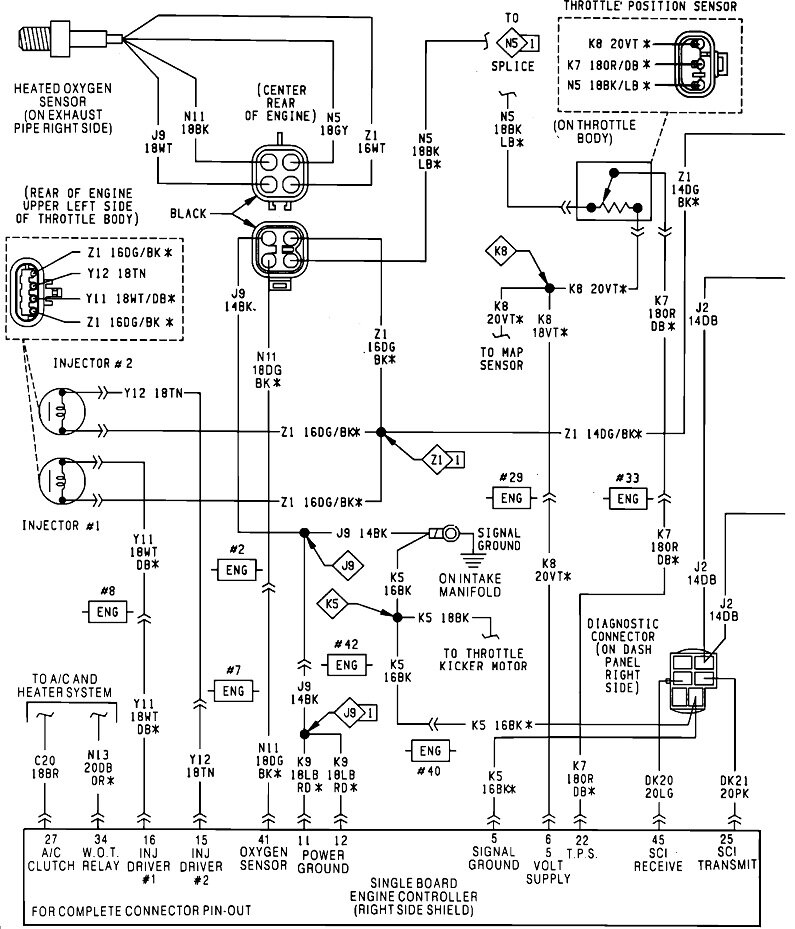

If all you're using is a Haynes manual, I can understand your frustration. They always do very little with electrical stuff. They include only what competent do-it-yourselfers might tackle. Anything you need from the factory manual, I can get online or from a paper manual at home, but I'll need a little time to format them for uploading.
I'll start you out with these headlight diagrams. I had them saved on my 'puter from a previous question. I have them listed as being for a 5.2L.
I'm not sure what I'm seeing in your second photo. Is that a corroded splice? It also looks like it could be a bullet connector, but that wouldn't be near a fuse box.
Apr 12, 2023 at 2:10 PM

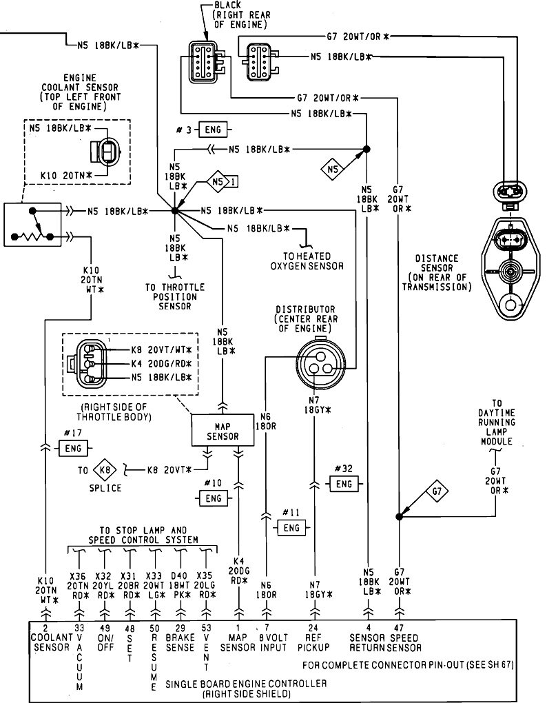

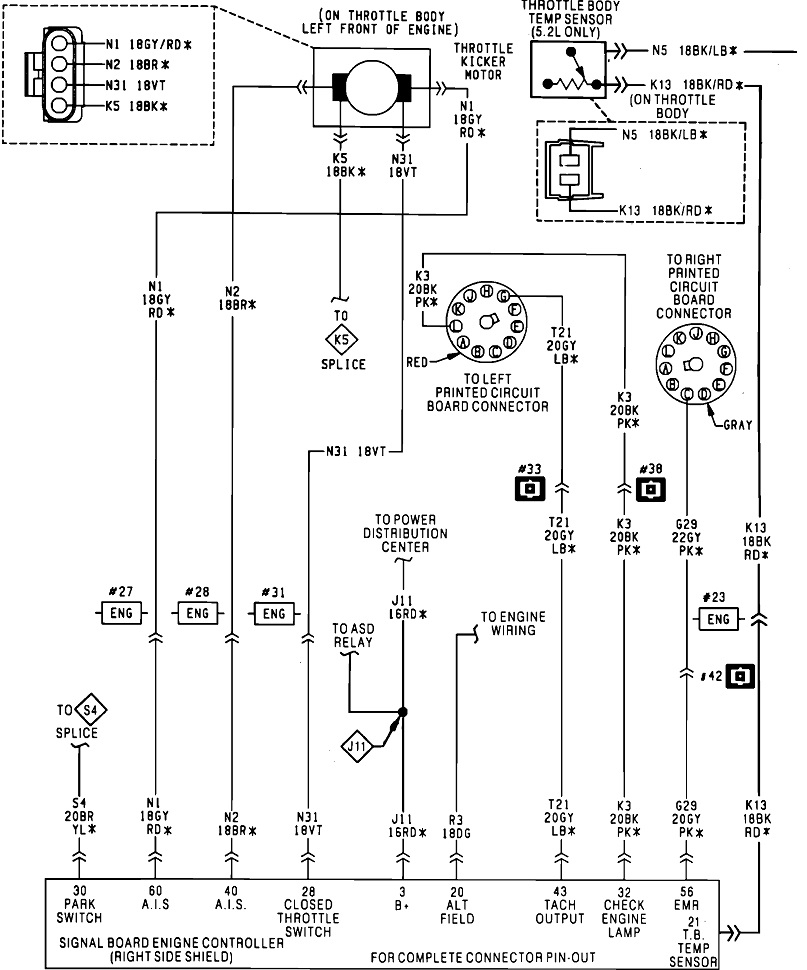

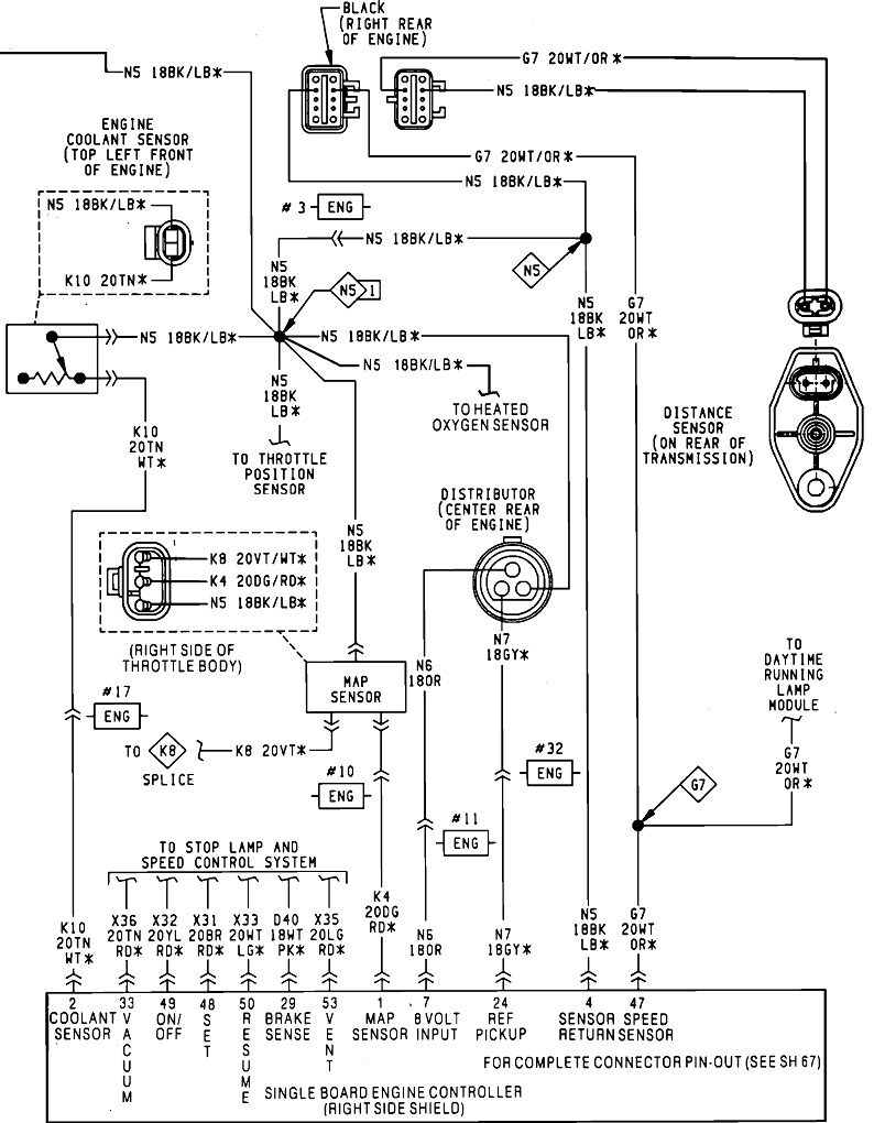

The only ignition timing sensor shown in the manual is the disc under the rotor in the distributor. They call it the "crankshaft position sensor" in some places, but normally that one is referred to as the "camshaft position sensor. Rock Auto shows a crank sensor for a '90 and a '91 model 5.2L. If your truck has that, it will be in the top of the transmission's bell housing, right behind the right cylinder head. If you have that one, I'll look at newer diagrams to find the right one. Another way to tell, if you have a scanner, is to view live Engine Sensor data. The crank and / or cam sensor will be listed with some type of indication as to whether their signals are showing up. I have a Chrysler DRB2 and a DRB3 for all of my older vehicles. Those list each sensor with a "No" when the ignition switch is in "run". They will switch to "Present" during cranking and when the engine is running. If either sensor is not on your truck, they won't be listed on the scanner.

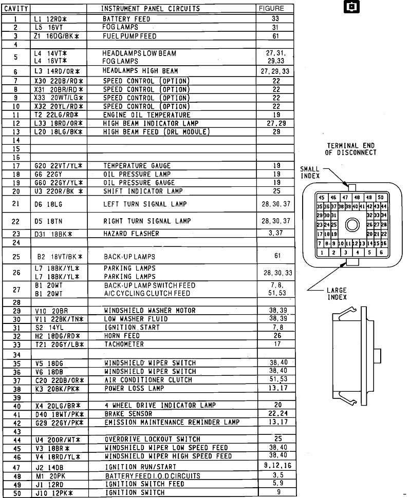

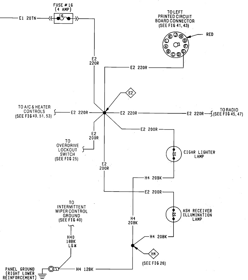

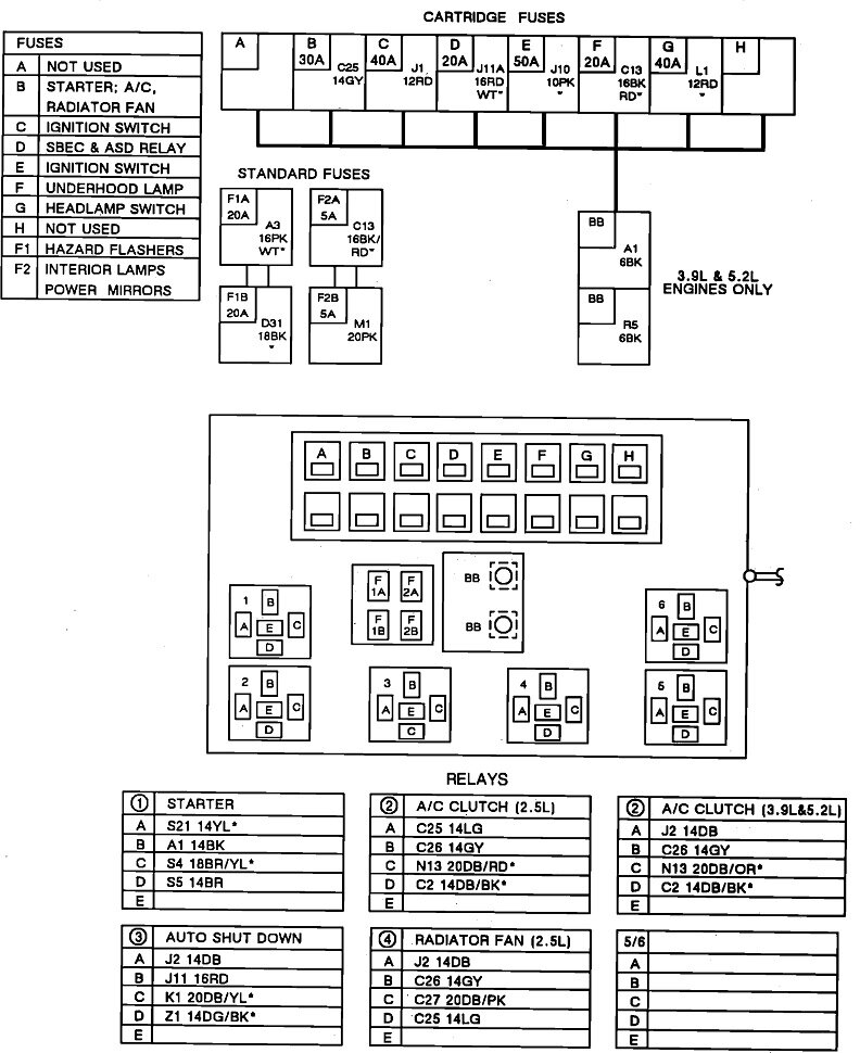

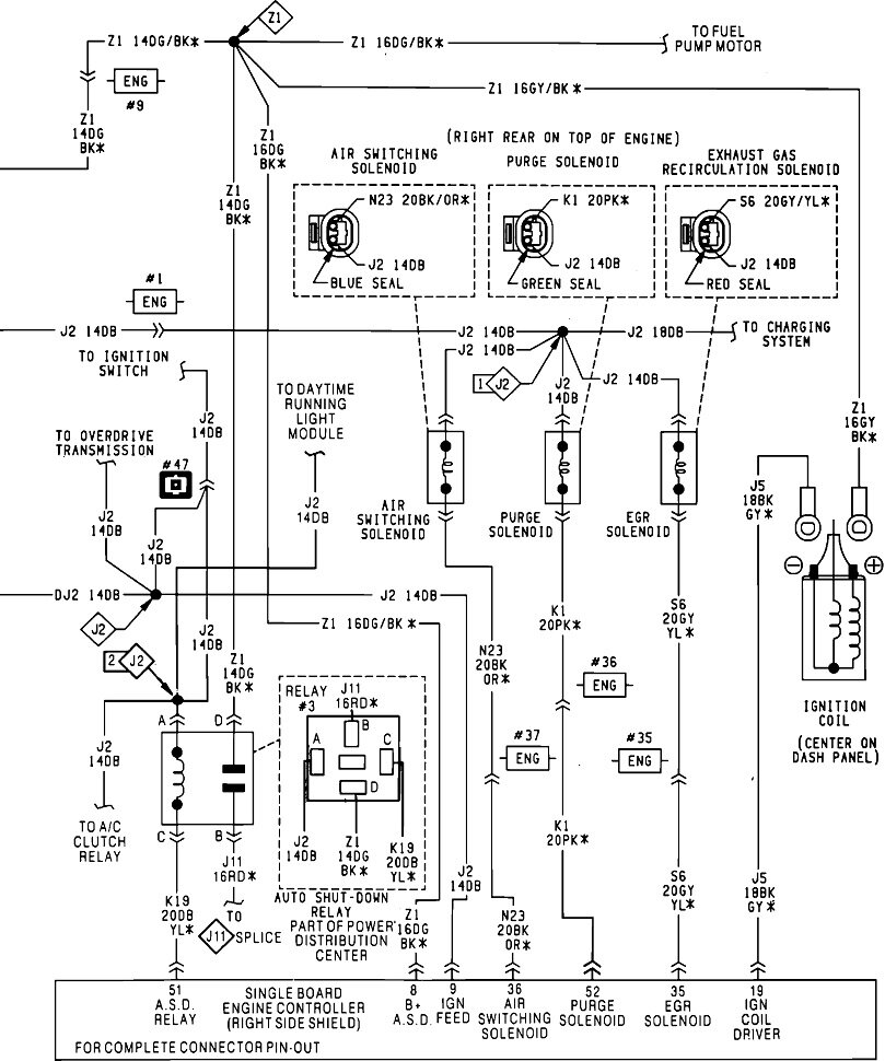

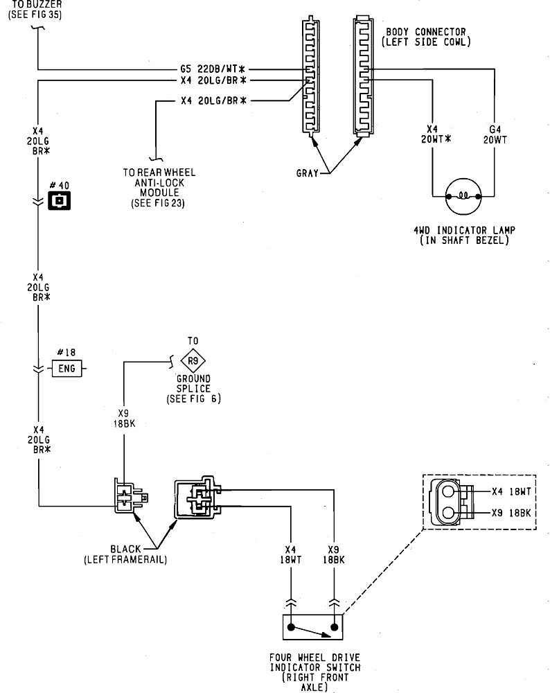

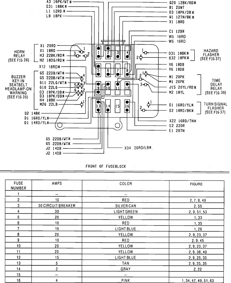

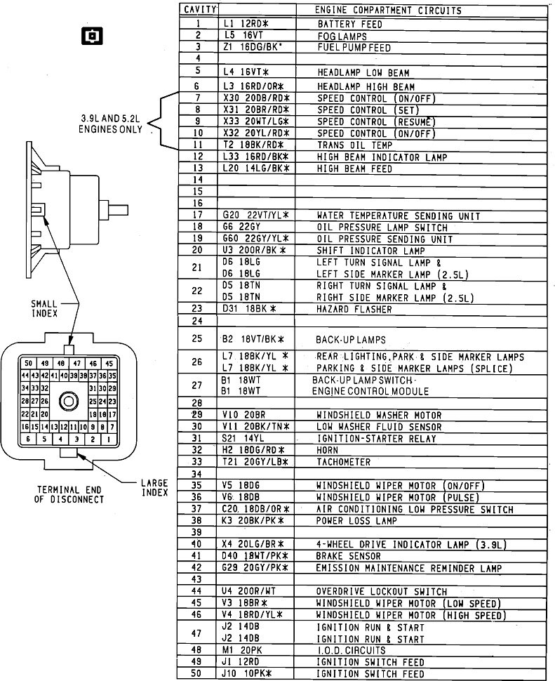

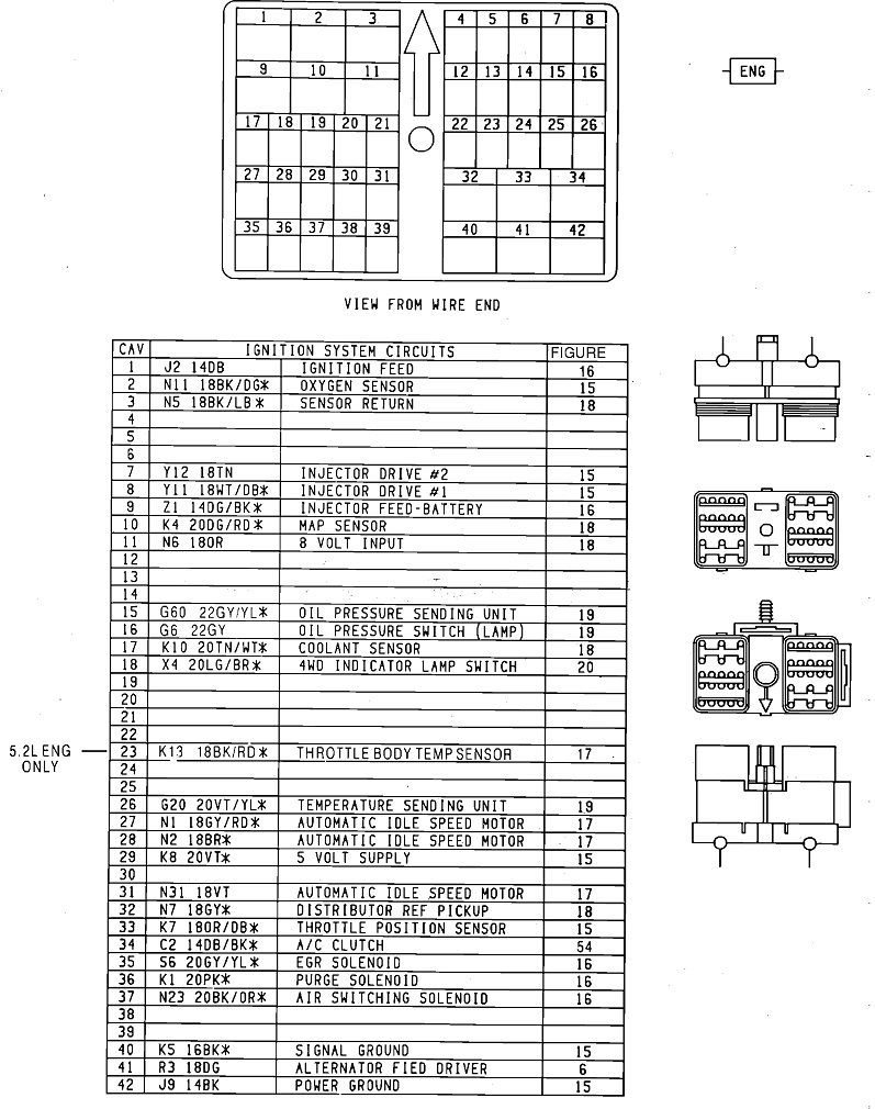

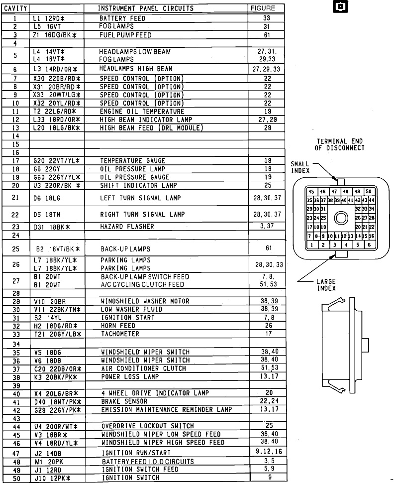

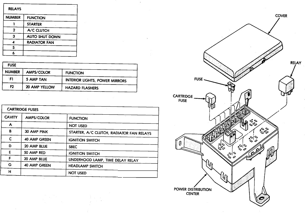

Here are the four diagrams for "Powertrain Management" in case you need them. The next three are for the Power Distribution Center, (PDC). That's the under-hood fuse box. The last two are for what they call the "Junction Box" now. That's the fuse box inside the cab.
Apr 12, 2023 at 2:52 PM

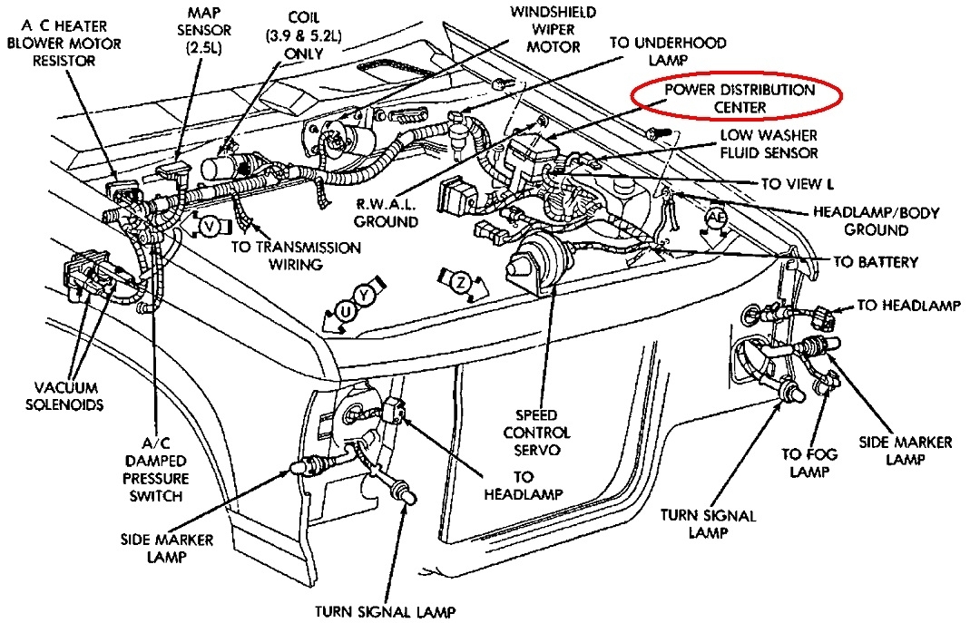

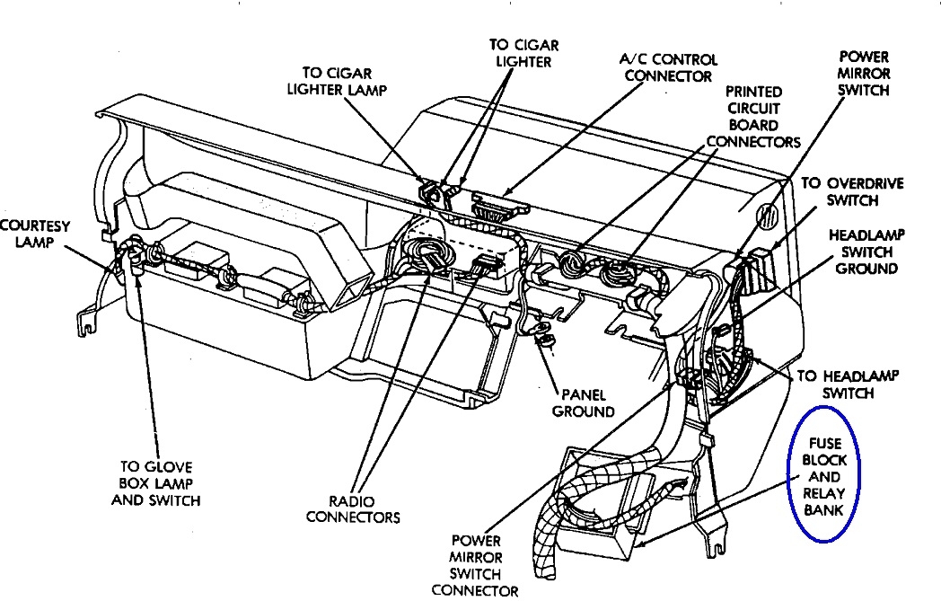

You mentioned the bulkhead connector. Here's the under-hood view, the dash view, and they had the engine connector listed, so I got that one too.
Let me know how far this gets you.
Apr 12, 2023 at 3:02 PM

How far it got me!! Does all the way sound good!? Talk about a lifesaver son, rewired a quarter of the truck maybe about ordered a new computer fixed everything wrong that I can see is wrong and she started up fine, I got headlights and taillights at the same time! Absolutely cannot thank you enough!!
