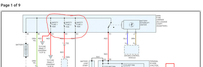

My battery kept draining. So after testing it went ahead and bought a new one. Been doing fine for about a week, but now when I start the car I have no electronics; no gauges, nothing. the car starts up but acts like it's about to shut off for the first 5 seconds. before running normal but still no electronics.
Jul 20, 2020 at 3:25 AM
  • 110,240 POSTS

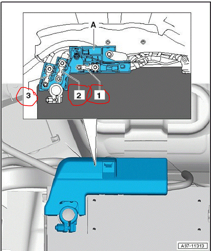

Does anything work? For example, brake lights, turn signals, horn, headlamps and so on? If nothing is working, the first thing I need you to check are the three safety fuses in the main fuse carrier in the trunk. See pic 1. These fuses power many other fuse boxes and components.
If they are good and nothing works, you really need to scan the CAN bus system. The control modules and computers throughout the vehicle are all tied together by this system. CAN stands for computer area network. If there is a break down, it can cause many other problems.

If you look at pic 2 below, I attached a pic of the fuses I mentioned. These are not typical fuses and attach to the battery. I circled them.
Let me know what you find.

Actually found the issue this morning. it ended up being the voltage regulator control module. But thank you for the info it was very helpful.

Okay, we'll figure this out together. Are the main fuses I showed you in pic 2 above good?
Jul 27, 2020 at 1:11 PM
ETHANVAUGHN8
Yes, those are all good. Did some research today and found out there are some more fuse boxes I wasn't aware of. I'm going to check those out this afternoon and see if I can find and issues. Any other suggestions for things I should check?
