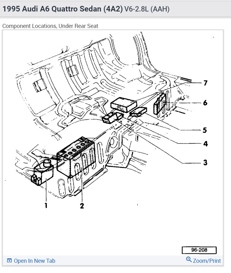

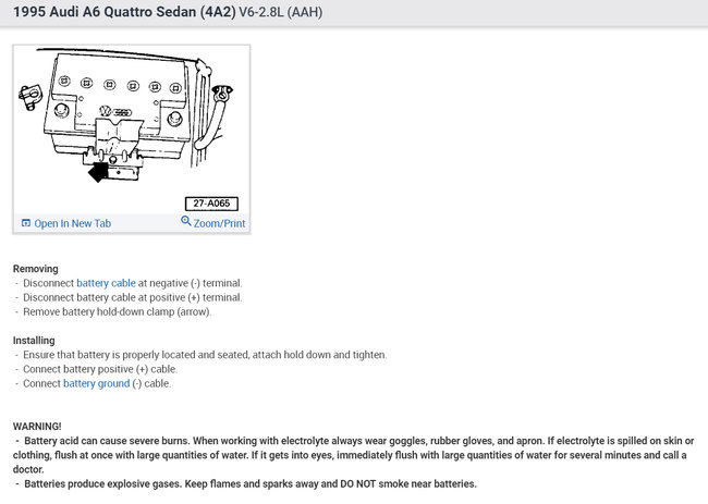

MBGRANT
Where is the battery located on Audi A6 1995 Quattro?
Jun 28, 2020 at 4:38 AM (Merged)
KHLOW2008
  • 41,814 POSTS
The battery is under the back set here isa guide to help you change it and diagrams below to show you on your car.
https://www.2carpros.com/articles/how-to-replace-a-car-battery

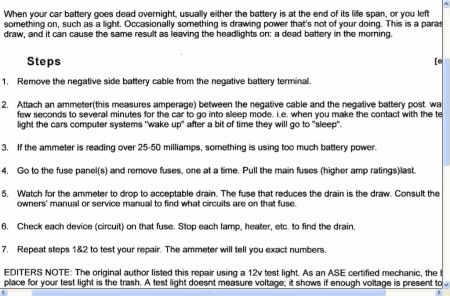

Could be a short circuit causing the battery to drain or the alternator is not putting out
https://images.2carpros.com/forum/automotive_pictures/12900_parastic_draw_1_69.jpg

Follow the above battery drain test to locate the problem area

The battery is new unless its defectice too-The alternator was checked it was okay which am very concern with-something is fishy here-the conclusion is a short somewhere-
Test light cost $7 disconnect the negative battery cable and clip the alligator on the negative cable and pointed end to the battery negative post-Is the test lit -if so start removing fuses one by one everyone that you can find till the light turns off-at this point this is where the drain is.
