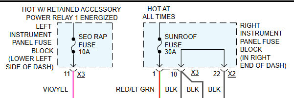

No power to right rear break light and blinker all the way back to the under hood fuse box. No power to sunroof and rear sliding window. Also lower dash lights have no power.

So the brake lights are control by the BCM, so I would check the fuses on it. The sun roof is a stand along unit and has its own fuses which I have included in the images below and a guide to help you check the fuses as well.
The interior lights are run by the BCM as well. Make sure the power is no while checking the fuses. If the fuses are okay on the BCM we need to do a CAN scan, this video will show you how. If the fuses are okay for the sunroof please start a new thread so we can continue. Sorry, we only handle one problem per thread, please post your new question here, you must be logged in.

All fuses check good. I’ve checked them three times now. All three of these things happened at the same time. I have also swapped the under hood fuse box due to corrosion and that didn’t fix the issue either.

There must be some kind of misunderstanding or miss communication. As stated above all fuses have checked good. Power to both sides of the fuses with the truck on. I’m not sure that i am getting power out of my BCM to the fuse box to power the blinker. If i jump the blinker wire to the trailer harness it back feeds the system and all the issues work if i hold my foot on the brake pedal. Back window will open and close sunroof will open and close dash lights will light up. Right rear blinker and brake light will come on.

Sorry, I didn't know if they had power, I know the fuses are good. Now we are getting somewhere :) Please check the fuse #8 60 amp in the fuse box near the battery. Top right of the engine compartment. This fuse feeds the systems that are not working. I apologize for the confusion.

Yep, I would say that too for the interior lights and the right rear tail light, but the sunroof and rear slider window do not go through the BCM. I did notice that both the rear slider and sunroof use the SEO RAP fuse in the left side of dash interior fuse panel.

Can you see if the the SEO RAP fuse has power with the truck on? It sounds like the lights are back feeding the circuit through the BCM.
