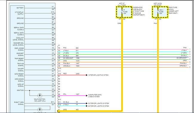

Everything else seems okay. new battery and alternator so far. Also, the door chimes ring even without the key in or lights on. i believe it is one of the body control modules, or the ignition switch. I can't afford a Tech 2 scan at the dealer, not sure that would help. How best to diagnose? I do have the huge service manuals...

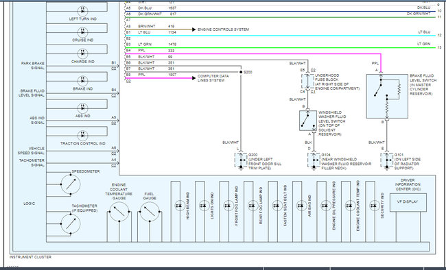

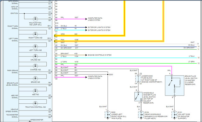

I attached the wiring diagram for the instrument cluster for you.
You need to test the 2 fuses I highlighted for power on both sides when the key is in the on position. 1 fuse is in the under-hood fuse block and the other is in the rear fuse block.
Let me know the results so we can proceed. Hopefully, it is just a failed fuse for you.

Thanks for replying and your interest in my problem. I will test for power on both sides (with key on) of what looks like fuse #7 front, and #12 rear.
