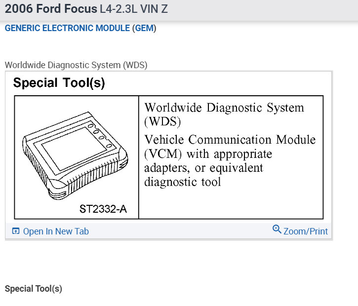

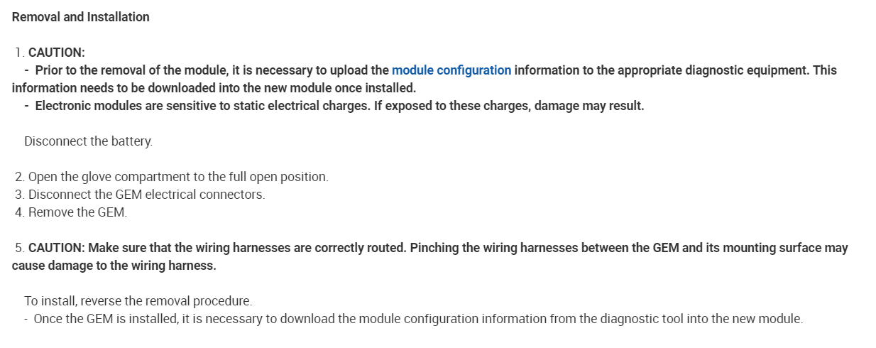

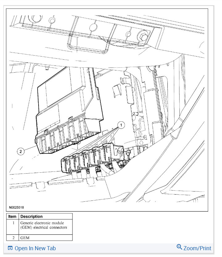

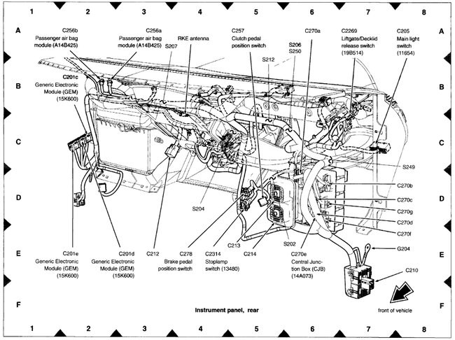

Is the battery good, does it have 12 volts? Also let's check all fuses with the system on.
This guide can help:
You may have had a voltage surge and taking out the GEM. we should do a CAN scan to confirm. You can get a CAN scanner (Controller Area Network) which will work on most cars from Amazon.
https://youtu.be/u-4syLc-ifQ
Here is the location of the GEM so you can check it out and replace it if a code comes up for it, you can get a preprogrammed unit by searching Google or Ebay. Check out the images (below). Please let us know what happens.
