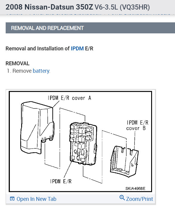

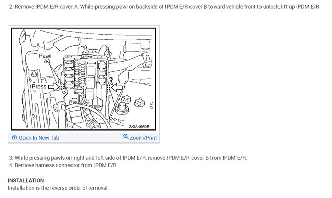

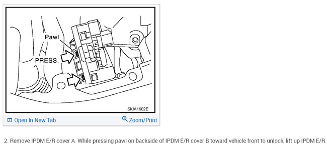

Let's check for power at the fuses in the IPDM because I have seen the IPDM go out and stop supplying power to various accessories.
This guide can help:
Please run this test with the systems on. Here is how to replace the IPDM in case there is no power when testing. Check out the images (below). Please let us know how it goes.
Sep 28, 2023 at 3:52 AM

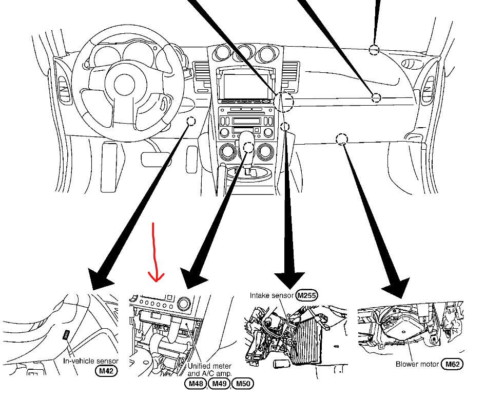

Yep, that was going to be my next thing to go over if the IPDM was okay, both the HVAC and instrument cluster use the Unified Meter and A/C Amplifier, so it does sound like it is bad. I believe a can scan will help confirm the issue. You can get a CAN scanner (Controller Area Network) which will work on most cars from Amazon.
https://youtu.be/u-4syLc-ifQ
Here is the location for the unit which is under the center of the dash. Check out the images (below). Please let us know what happens.

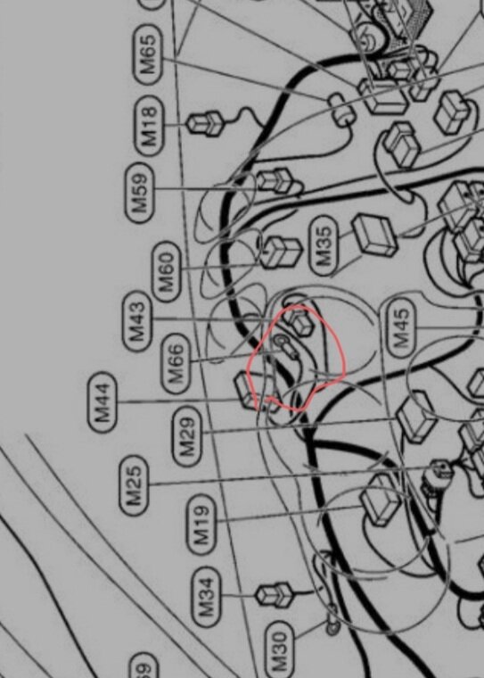

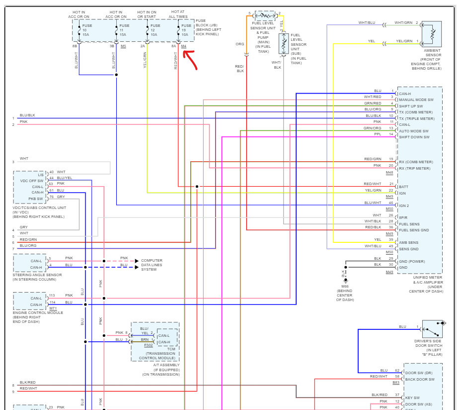

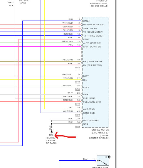

Okay, these systems use a common ground which is the M66 behind the center of the dash which needs to be checked. here is what I am talking about.
Oct 12, 2023 at 3:05 AM

Hi Ken, is that visible and near the unified meter or is it higher up? Thanks
Oct 12, 2023 at 3:12 AM
GAV911
  • 22 POSTS
Also, did you just want me to check it's connected or if it's loose? Thanks Ken.
Oct 12, 2023 at 3:17 AM
GAV911
  • 22 POSTS

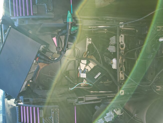

Is this what you mean? Thanks
Oct 12, 2023 at 6:19 AM
GAV911
  • 22 POSTS
Hi Ken, just spoke to Nissan near me and just for a diagnostic test I'm looking at 150 which I think is too overpriced, do you know of a scanner I could buy that will do everything I need on my 350z for around the 300 range? Thanks.
Oct 12, 2023 at 8:55 PM
  • 55,711 POSTS
Yes, I want you to check if the ground is loose or broken off, also check for rust as well. The ground connection must be clean and tight. Scanner capability is all over the map. You will need to do research on the unit to see if you are better off getting the scanner or taking it in for diagnosis.
Oct 13, 2023 at 1:47 AM

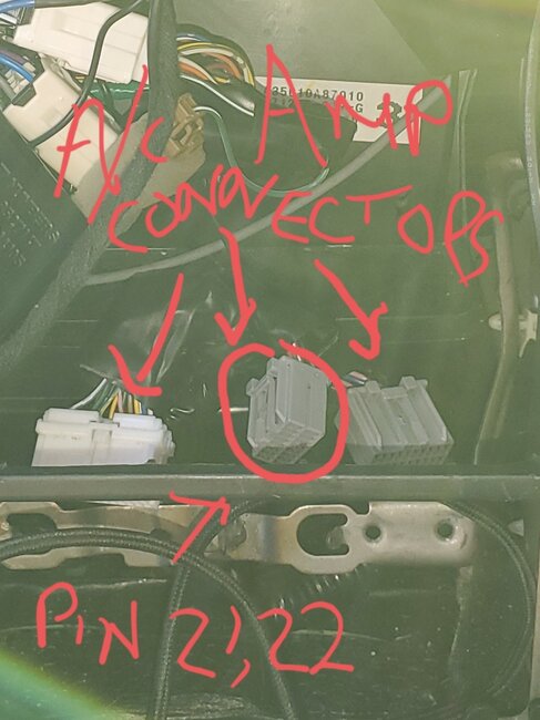

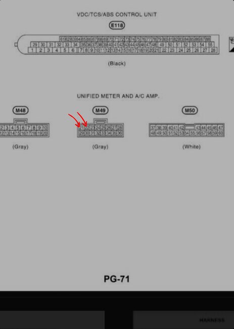

Hi Ken, I took all my centre console out but you can't get to the grounding point m66, I did check all connections and wiggled wires to see if any were loose but all seemed fine. I also put a multimeter on pin 21 and 22 for the unified meter power but there was no reading? I think I did it right lol. Really hope you can help me out Ken. thank you.
Oct 15, 2023 at 1:57 AM
  • 55,711 POSTS

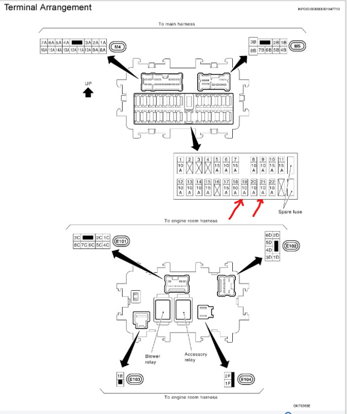

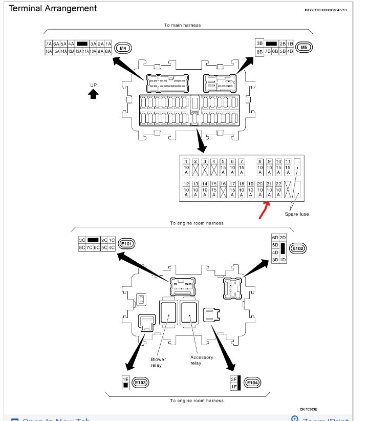

Pin #21 should be battery power with the key on. It gets its power from the fuse #19 from the interior fuse panel. Please use this guide to confirm there is power and that the fuse is not blown:
Oct 15, 2023 at 4:05 AM

I've checked all fuses with a test light in the drivers footwell, by the battery and the IPDM there all good but I put a multimeter on the two arrowed pins while the engine was running, and the ground was touching the gear shift bolt and got no reading of voltage to either pin? Thank you Ken.
Oct 15, 2023 at 4:50 AM

Do you have power at the red/wht wire with the key on? Fuse # 19 is two away from fuse #21.
Oct 16, 2023 at 5:12 AM

Is this the fuses in the footwell, as I'm getting confused with the numbers as 21 is a pin in the a/c amplifier block connector. Do you mean check pin 19 or am I looking for fuse 19? If I'm looking for a fuse, would it be in the footwell, IPDM or near the battery? Thanks Ken.
Oct 16, 2023 at 5:41 AM
  • 55,711 POSTS
It would be fuse #19 in the fuse panel inside the car.
Oct 17, 2023 at 2:28 AM

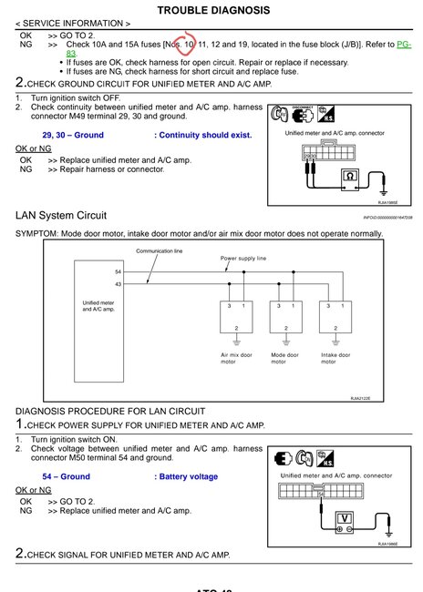

Hi Ken, I downloaded the service manual and had a look through that last night, and I have fixed it all, thank you. I was getting power through fuse 19 but as you can see from this image of the manual it says to also check fuse 10,11,12 which I thought I did but guess what I missed one lol Fuse 10 was only coming on one side of the fuse, so checked it and blown!! Changed it and presto everything is working again. Thanks again for your time and help really has saved me £350 the dealership wanted for a diagnostic.
Oct 18, 2023 at 2:15 AM
