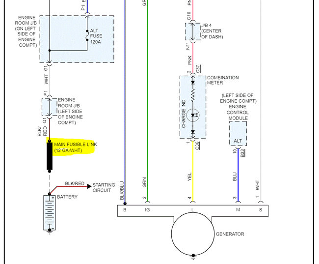

I recently replaced my tensioner and drove my car and it was running great, but the battery light came on and wouldn't go off. So, I replaced the serpentine belt and the alternator but as I was connecting the alternator, I heard a spark and noticed I forgot to disconnect the battery cables and now only the dash lights and dome light and headlights work but nothing else. When the switch is in the "on" position the battery indicator light is not on. Is this possibly an electrical issue that can be easily resolved? Please, I need my car to get around in.
Mar 25, 2022 at 11:44 AM
  • 110,248 POSTS
There are several fuses related to the alternator. I would suggest starting with them. However, one specifically stands out. There is a fusible link between the battery and the fuse box. I would think a smaller fuse before it failed, but anything is possible.

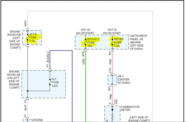

I attached the wiring schematic below for your reference. I highlighted the fuses to check and the fusible link.

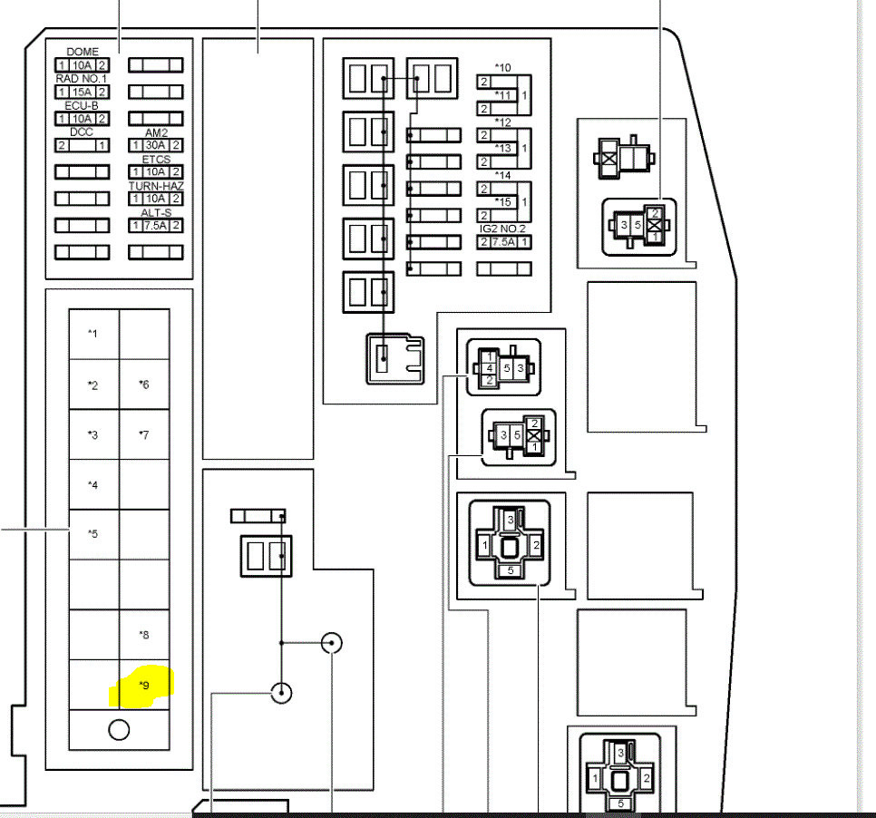

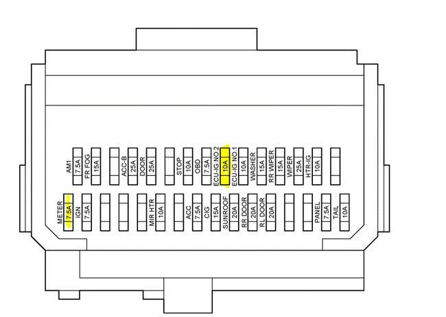

Pic 3 shows the location of the link and fuse in the under-hood fuse box to check. Pic 4 shows the fuse panel in the vehicle.
When you check the fuses, it will be important that you also confirm there is power to and from it even if the fuse is good. If there is no power, I will have to work backward to determine the power came from and if there is a fuse before it that may have failed.

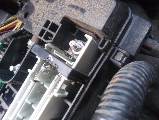

Hi Joe, I finally got it I took the plastic cap off the fusible link and checked the highlighted section and that was it so I just put a flathead screwdriver in between it, and it cranked right up. but how do I fix that section without replacing the whole link?

Hi Cory, the link should be replaced with the same exact size/amperage. There really isn't a way to fix them that one would consider safe simply because it is designed to fail before damage to the wiring or a fire can start.
If possible, take a pic of the failed part. Also, see if there is a part number on it and I'll do my best to get you fixed up.

Joe, I hope nothing happens but I soldered it.

If you soldered it, there is no way of telling how much amperage is required for it to fail again. If something fails or shorts, it may not fail and cause other electrical damage or even a fire.
Do me a favor. Take a pic of it and upload it for me to see what was done. I'm concerned of a short that can't cause link failure.

Here it is.
Apr 16, 2022 at 10:07 AM
CORY WEBSTER
  • 16 POSTS
Picture is not the best but I haven't had any problems yet and it looks better in person, but I am concerned now that you have told me that.

I don't mean to make you worry. I just don't want something to happen. Listen. I looked at the pic and see what you did. I also see a somewhat long portion of the original fusible link is still intact. In my mind, that undamaged section should fail as designed because it is still original.
However, if you were a family member, I would still want you to replace it. I hope that makes sense. I feel it's okay for a while, so don't worry, but I would like to see you replace it when you can.
