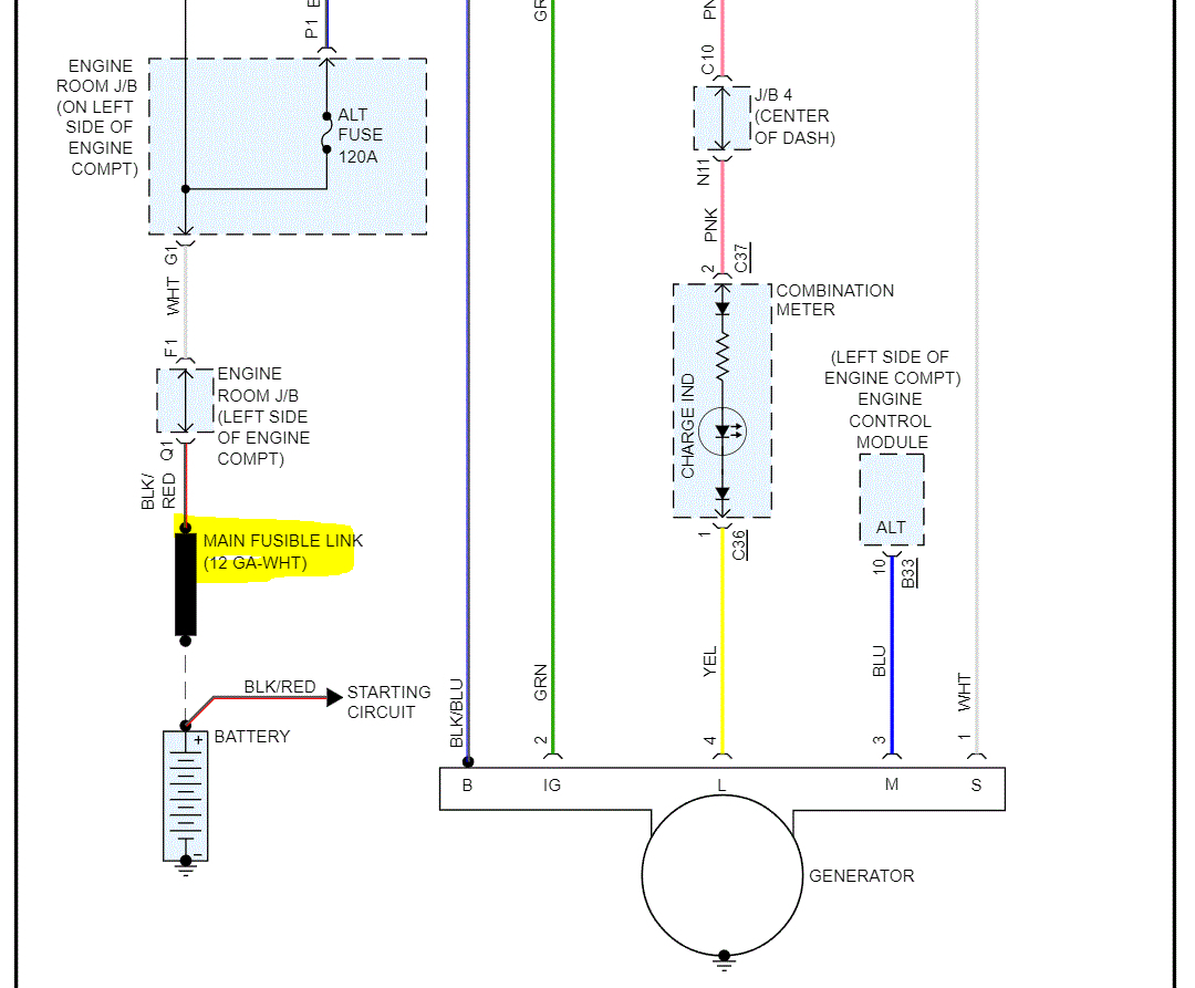

I recently replaced my tensioner and drove my car and it was running great, but the battery light came on and wouldn't go off. So, I replaced the serpentine belt and the alternator but as I was connecting the alternator, I heard a spark and noticed I forgot to disconnect the battery cables and now only the dash lights and dome light and headlights work but nothing else. When the switch is in the "on" position the battery indicator light is not on. Is this possibly an electrical issue that can be easily resolved? Please, I need my car to get around in.

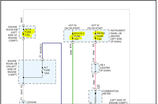

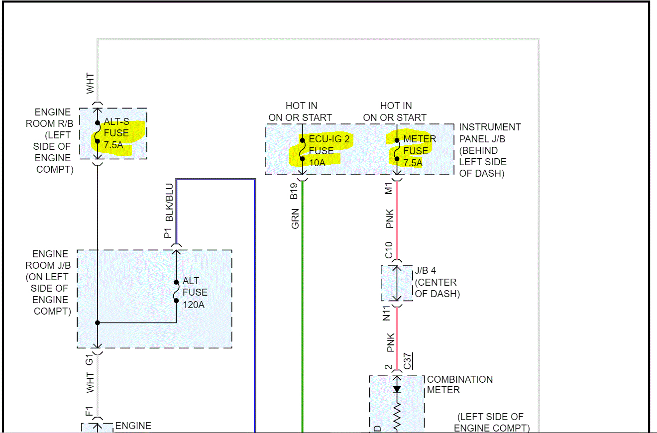

There are several fuses related to the alternator. I would suggest starting with them. However, one specifically stands out. There is a fusible link between the battery and the fuse box. I would think a smaller fuse before it failed, but anything is possible.
I attached the wiring schematic below for your reference. I highlighted the fuses to check and the fusible link.

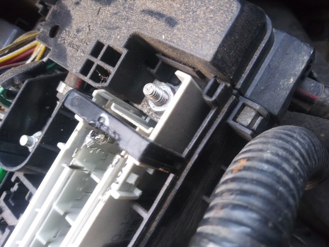

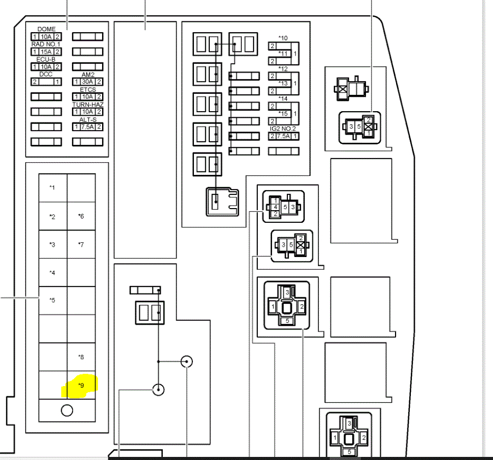

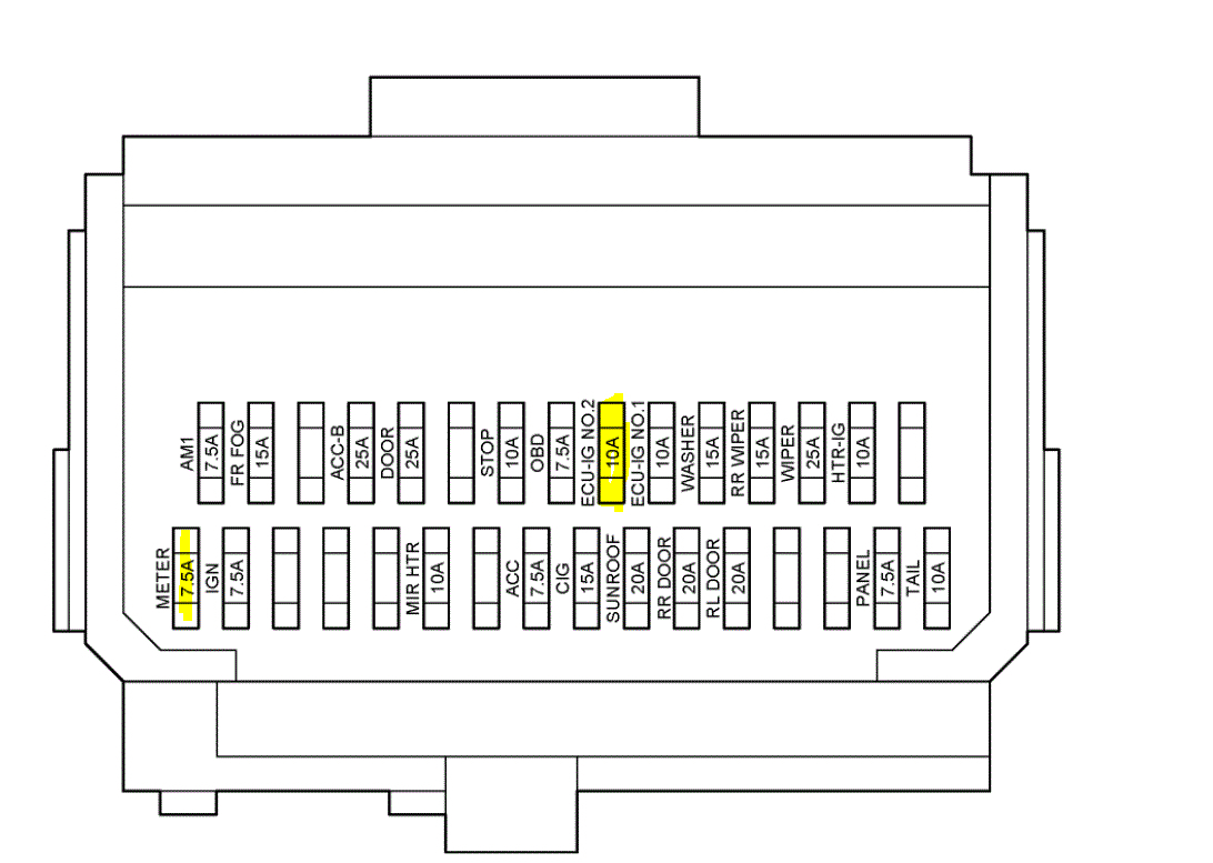

Pic 3 shows the location of the link and fuse in the under-hood fuse box to check. Pic 4 shows the fuse panel in the vehicle.
When you check the fuses, it will be important that you also confirm there is power to and from it even if the fuse is good. If there is no power, I will have to work backward to determine the power came from and if there is a fuse before it that may have failed.

Hi Joe, I finally got it I took the plastic cap off the fusible link and checked the highlighted section and that was it so I just put a flathead screwdriver in between it, and it cranked right up. but how do I fix that section without replacing the whole link?
Apr 9, 2022 at 5:54 AM
  • 110,244 POSTS
Hi Cory, the link should be replaced with the same exact size/amperage. There really isn't a way to fix them that one would consider safe simply because it is designed to fail before damage to the wiring or a fire can start.
