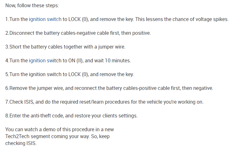

My key fob stopped working along with my high beams, turn signals, power gas door release, intermittent and low speed wipers, temperature gauge, door locks, electric rear gate open, air condition, auto headlights. Replaced batte5with AGM Battery, occasionally I get day-time running lights going on and off.
Oct 14, 2021 at 12:19 PM
  • 110,194 POSTS

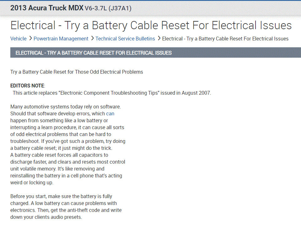

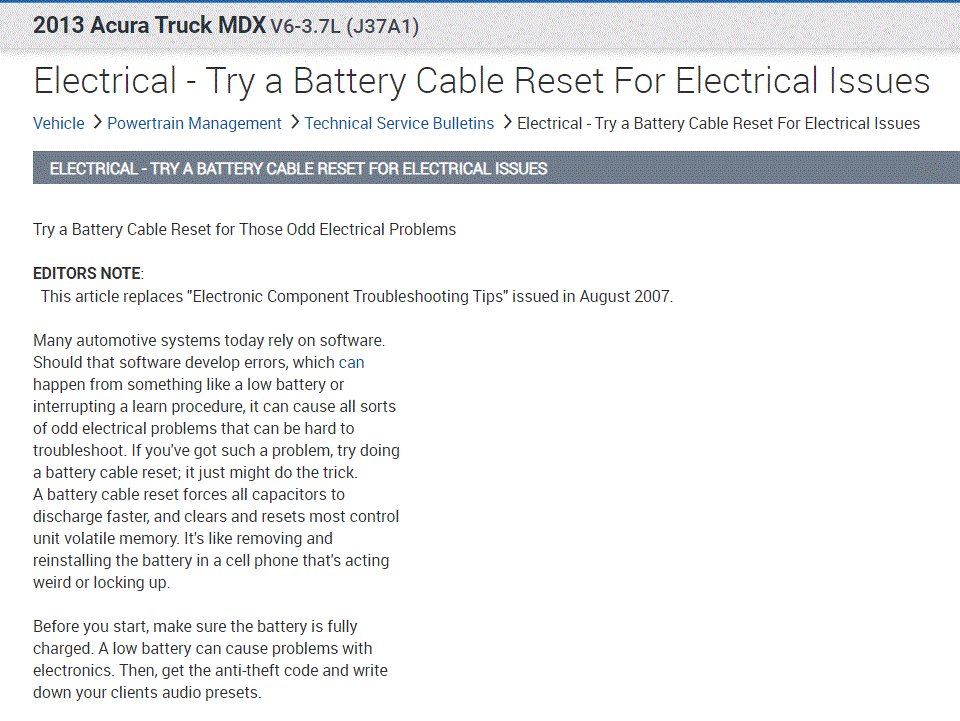

Wow, it sounds like everything has stopped working. I doubt that many fuses failed at one time or if one wire caused it. Let's try a battery cable reset.
I need you to read through the attachments below and perform the procedure indicated.
