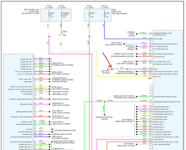

Need Help Diagnosing Electrical Issue - 2012 Nissan Micra XV Diesel
Symptoms:
After ~40 minutes of driving, speedometer drops to 0 while driving
Power steering becomes extremely light (no resistance)
Key warning light appears on dash
Car starts jerking during throttle changes
Car won’t turn off unless I hold the stop/start button for a few seconds
Fault Codes (when issue appears):
B2629-00 Vehicle Speed
B2615-00 BCM
C1606-01 - EPS Motor
What I’ve done so far:
Battery,ipdm and alternator checked — working fine
After heating up, the issue returns exactly the same
If cooled down and restarted, all works normally again
Main Question:
Is this more likely to be the Vehicle Speed Sensor (VSS) or the BCM (Body Control Module) failing when hot?
Any tips for diagnosing or testing further?
Thanks!
Jun 1, 2025 at 6:17 AM
  • 55,732 POSTS

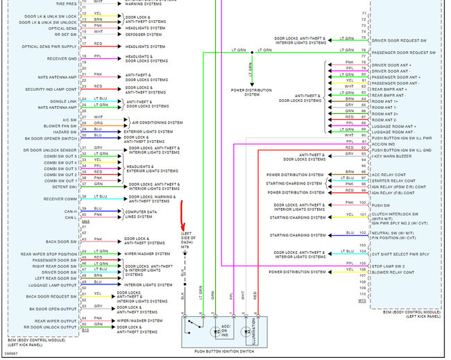

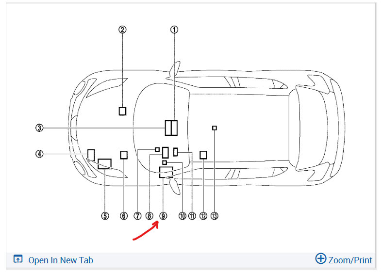

These codes are the main problems, but I would replace (or have tested) the BCM first in case it fixes the other codes as well. I have also seen the instrument cluster go out and back feed into the BCM as well, did this car have water damage?
B2615-00 BCM
Here is the BCM location, also a bad ground car cause this as well, here is a guide to help test the connections and the wiring diagrams as well. Check the fuse again for the BCM as well.
