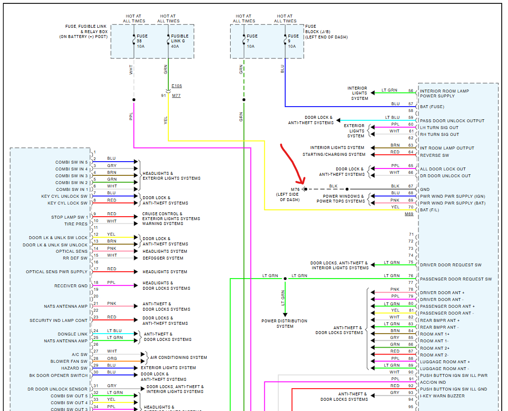

Jun 1, 2025 at 6:17 AM
  • 55,433 POSTS

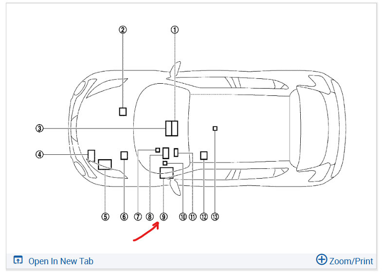

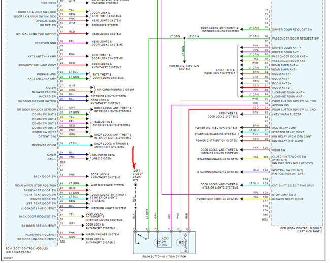

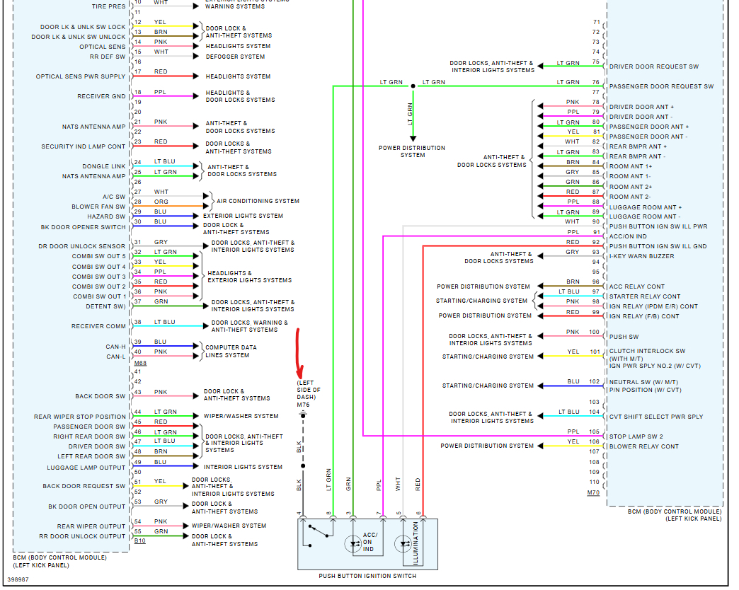

These codes are the main problems, but I would replace (or have tested) the BCM first in case it fixes the other codes as well. I have also seen the instrument cluster go out and back feed into the BCM as well, did this car have water damage?
B2615-00 BCM
C1606-01 - EPS Motor
Here is the BCM location, also a bad ground car cause this as well, here is a guide to help test the connections and the wiring diagrams as well. Check the fuse again for the BCM as well.
