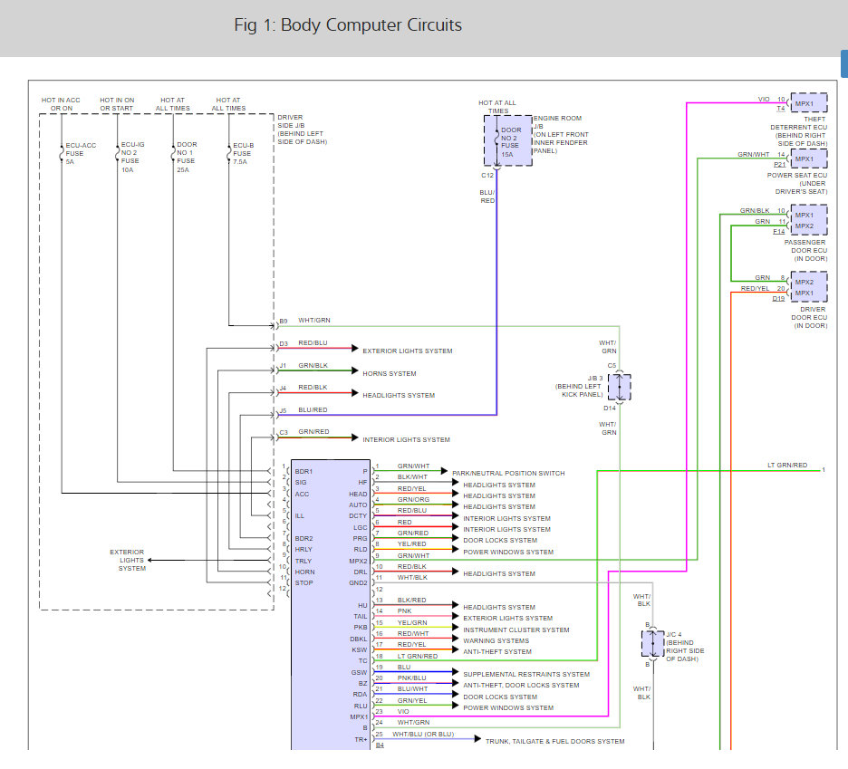

I have the truck listed above 1500 model. My Wiper blades does not work. My dome light is dim. When ever I apply the brakes my dome light goes out, the instrument cluster goes out, the cigarette outlet stops working. Thanks in advance for any help.

Check the fuses, sounds like a ground problem. you can try a jumper wire from the chassis to the ground of the vehicle, this might not be on the inside of the vehicle. check the ground wires from the fenders to the frame and body. As I said to check is run a ground wire from the negative side of the battery to the frame , engine and under the dash. If there is a good battery you should see where the problem might be.
Mar 15, 2018 at 2:28 AM
  • 55,776 POSTS

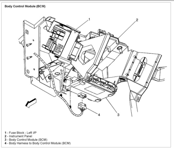

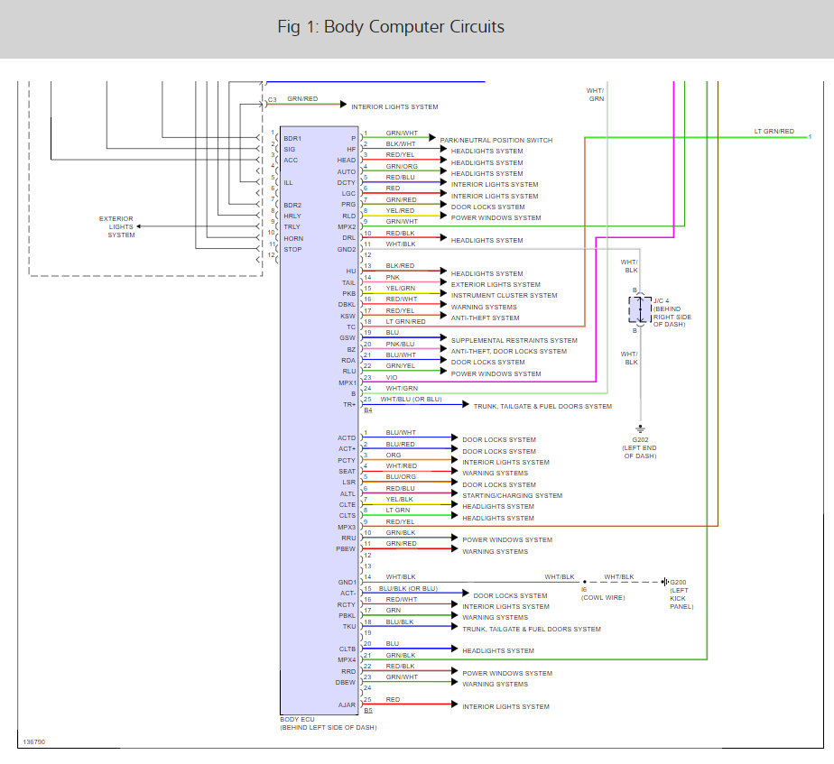

Any water damage, flood for this truck? It sounds like you have a BCM that is out. Here is the location and wiring diagram so you can see how the system works and test the wiring before replacing the BCM which will need to be programmed in:

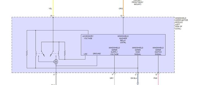

Sorry for the late reply. Note the diagram, yellow wire is voltage for motor, black wire is ground. I cannot rule out the wiper switch itself.
