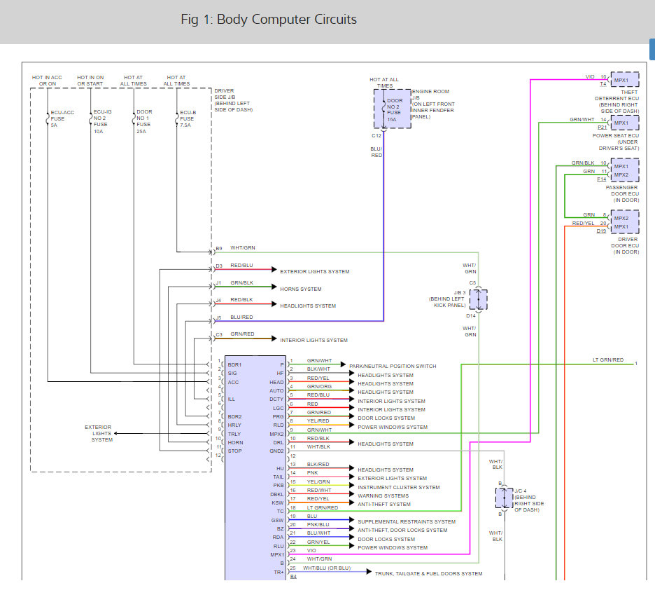

I have the truck listed above 1500 model. My Wiper blades does not work. My dome light is dim. When ever I apply the brakes my dome light goes out, the instrument cluster goes out, the cigarette outlet stops working. Thanks in advance for any help.

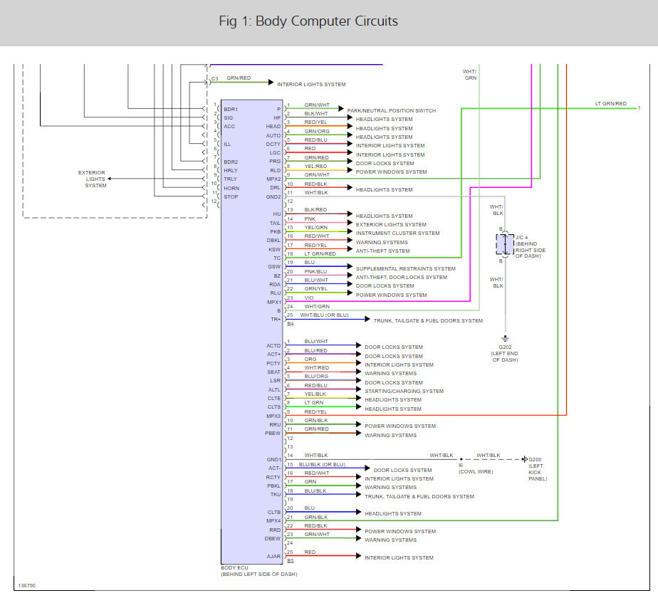

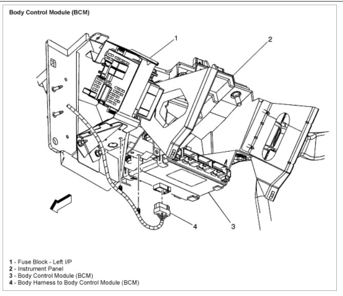

Any water damage, flood for this truck? It sounds like you have a BCM that is out. Here is the location and wiring diagram so you can see how the system works and test the wiring before replacing the BCM which will need to be programmed in:

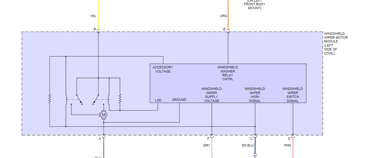

Sorry for the late reply. Note the diagram, yellow wire is voltage for motor, black wire is ground. I cannot rule out the wiper switch itself.
