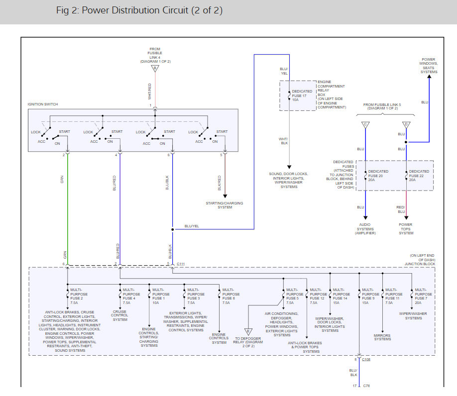

Stereo, Interior lights, door locks and clock stopped working
2002 MITSUBISHI ECLIPSE
127,000 MILES • 2.7L • 4 CYL • 2WD • AUTOMATIC
ORRENJ
I checked all the fuses. What else could it be?
Jan 28, 2020 at 1:48 AM
  • 55,423 POSTS
It sounds like the ignition switch could be out. to be sure with the key "on" do you have power coming out of the green wire at the ignition switch? here is a guide to help you with the wiring diagrams so you can see how the system works:
Check out the diagrams (below). Please let us know what you find.
