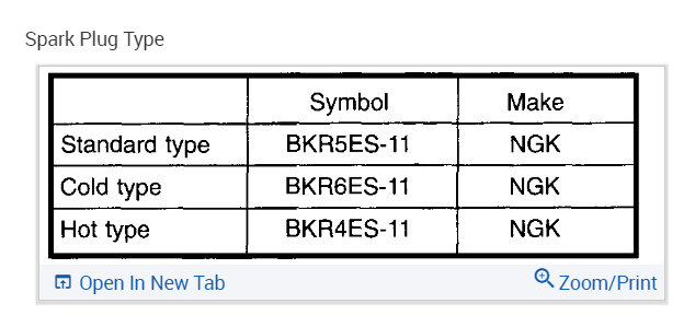

So, the tachometer is going crazy. doesn't seem to affect transmission. it's just going haywire. What could be the cause?
Feb 3, 2023 at 10:01 PM
  • 55,691 POSTS

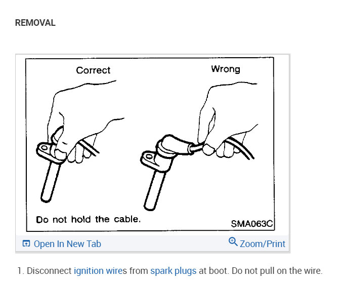

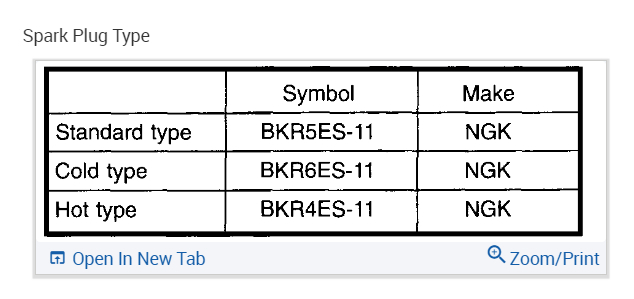

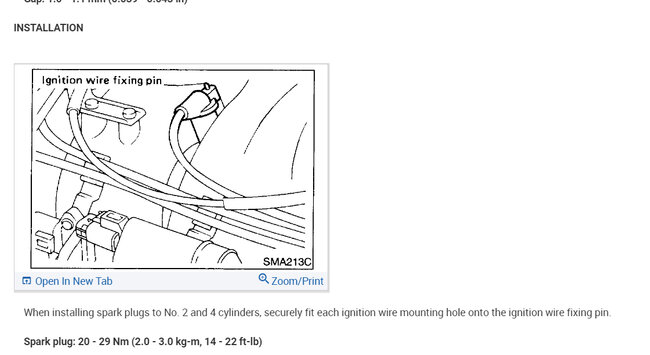

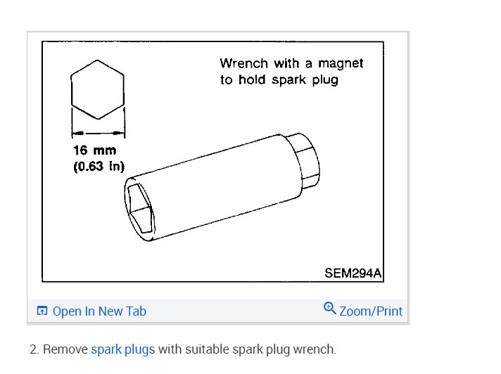

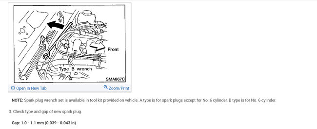

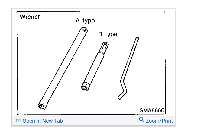

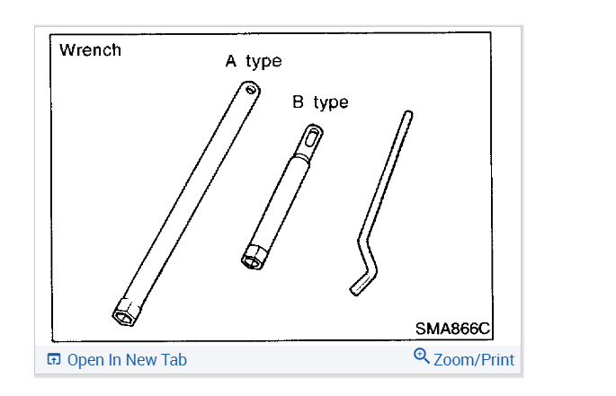

This can be caused by one of two things either the ignition system is back feeding into the tachometer circuit or the tachometer itself is going out. Can I ask if the engine is misfiring? If it has been a while, I would change out the spark plugs, cap, rotor and spark plug wires. Here is a generic guide to help walk you through the steps with instructions below for your truck.
https://www.2carpros.com/articles/how-to-change-spark-plugs
Check out the images (below). Please let us know what you find.
