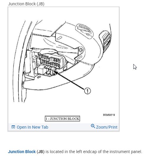

Okay, If the clicking is in relation to these issues then we need to consider that a relay that is clicking on and off. Take a look at the attachment of the junction block. I am hoping we can remove this cover and listen for the clicking coming out of here and then even if you can try to feel the relays when they are clicking. If it is one of these then you can feel it when it is going on and off to try to narrow it down.
Is there any chance that the noise could be coming from under the hood and it just sounds like it is coming from the dash?

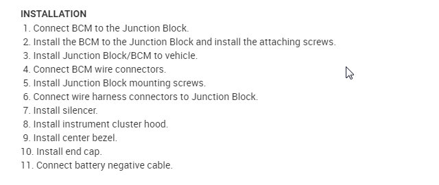

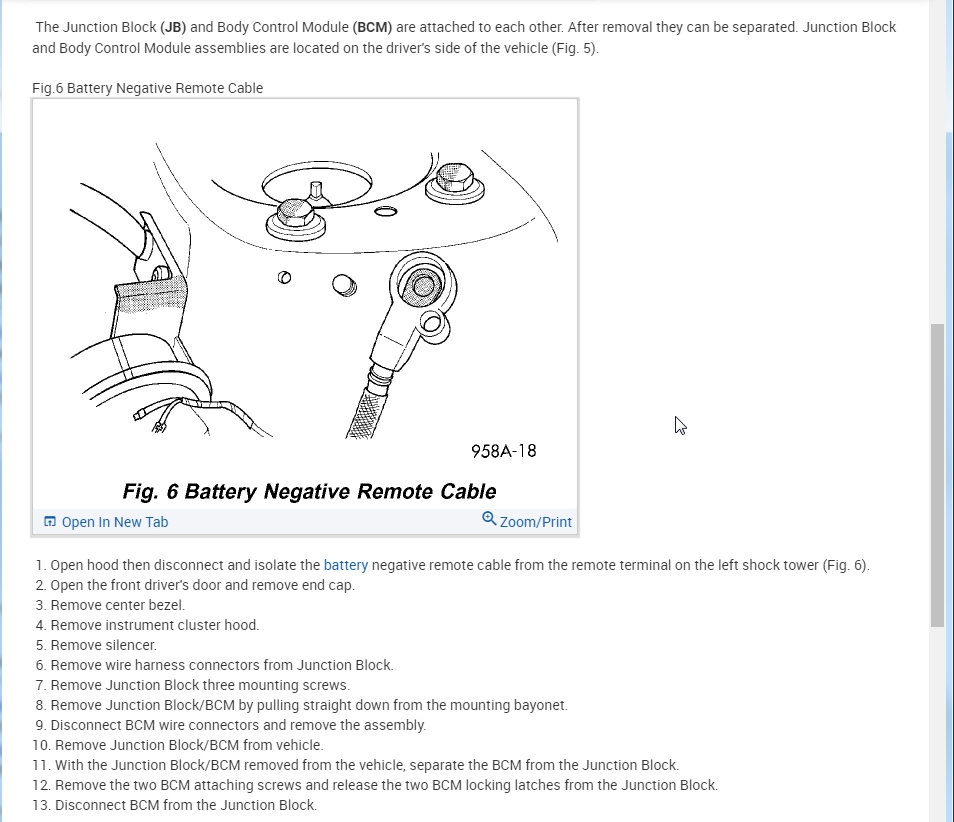

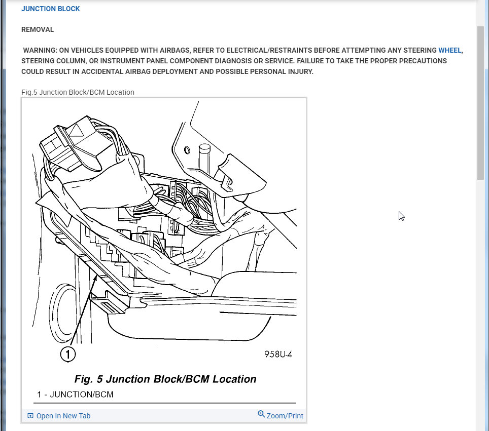

The only thing that I can find that would make sense is the junction block/BCM. It is actually located on the firewall between the engine and behind the dash. I attached the instructions on this but all these components are run through this junction block and BCM so it is the only thing that makes sense.
I attached the location and repair process for your review.
