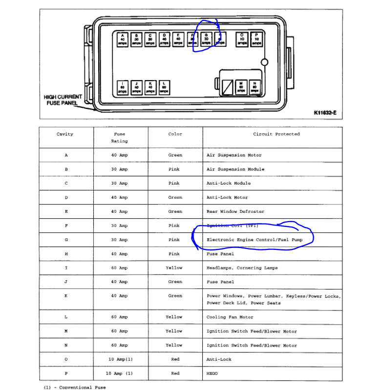

30 amp EEC and fuel pump fuse keeps popping
1992 LINCOLN CONTINENTAL
88,000 MILES • 3.8L • 6 CYL • 2WD • AUTOMATIC
BRANDONDBENTON87
  • 14 POSTS
The 30 amp EEC and fuel pump fuse under the hood keeps popping and has flow of 12 volts with the fuse removed the other side shows 2 volts on the voltmeter. what should i check now and are there any wiring diagrams available?

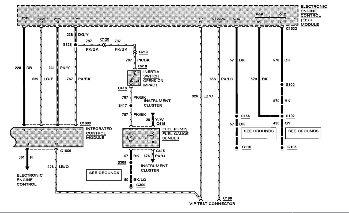

Good evening,
I attached a wiring diagram for you to view.

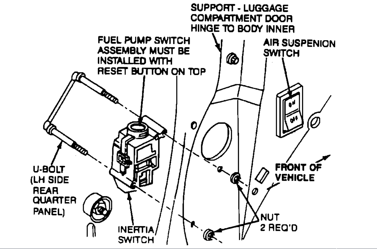

I would disconnect the inertia switch and see if the fuse still fails.
If it does, it could be the fuel pump. If it does not then it could be the ECM or wiring at the ECM.
The inertia switch is located on the LH side of trunk, below air suspension electronic control module.

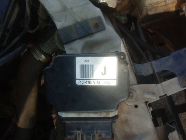

It ran for like 30 seconds then the fuse popped when i revved it up i unplugged the inertia switch with the key out it blew the fuse right away there is a computer mounted above the radiator fan that vibrated and made a noise for a second any suggestions where to look next.
Oct 23, 2020 at 7:32 AM
Okay, then it is not the fuel pump.
Unplug the fan controller and see if the fuse still fails.
That is the piece on top of the radiator shroud.

Unplugged the fan controller tried to start it would not start but did not blow the fuse. plugged it back in started it and it blew the fuse instantly. could there be an issue with the wiring or is the fan controller the issue?
Oct 23, 2020 at 8:12 AM
The fuel pump relay is part of the module. That is why it would not start.
It is a very common failure.
Replace the module.
Oct 23, 2020 at 8:13 AM

F1d7 aa is the part number i think.
Oct 23, 2020 at 11:49 PM
No, there are a lot more numbers.

This is it is this the module you were referring too.
Oct 24, 2020 at 1:46 AM
BRANDONDBENTON87
  • 14 POSTS
Could you check and see if the one on O'reilys.com is the right one and let me know please?
Oct 24, 2020 at 1:47 AM
If you were sending a picture, nothing came through.
Please try again.
Oct 24, 2020 at 1:51 AM
BRANDONDBENTON87
  • 14 POSTS
F1DF-12B577-AA
