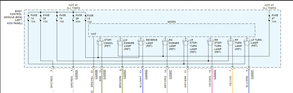

In my 2012 Lincoln mkx I’m currently experiencing issues with the brake lights/turn signals in the rear not working. Also the interior touch screen/climate control panel is dead. Also the rain sensor I believe because wipers are off but continue to operate. Everything else works great! Vehicle is in amazing shape so hate to get rid of it but I’m stumped. Changed fuzes and checked battery. Did research and thought it was turn signal switch until the interior controls went. Baffled please help!!

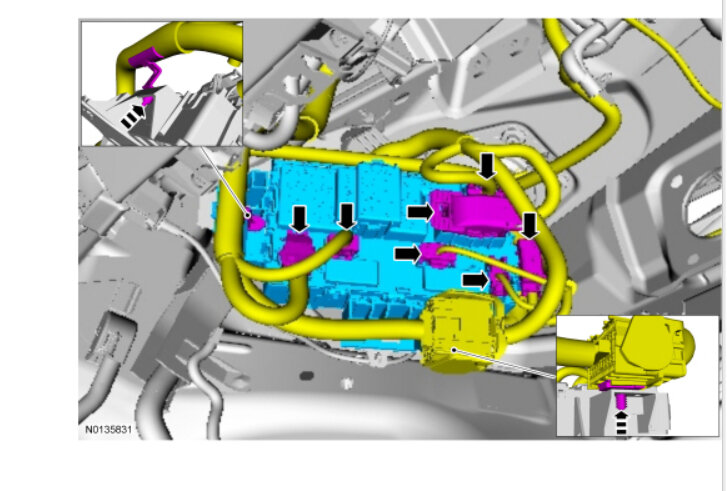

Did these three problem all show up at once? So these are controlled by the BCM so there are fuses on the BCM as well we need to check, here is a video to help and the fuse locations below.
https://www.youtube.com/watch?v=G-xNK79Wa-w
if the fuses are okay I would run CAN scan to check the BCM
CAN SCAN - https://youtu.be/u-4syLc-ifQ
Check out the images (below). Please let us know what happens. Ken

They did all happen pretty much at once. Within 24 hours for the most part other than the brake lights.

Yep, chances are the BCM is bad, I would check the electrical connector for corrosion which I have seen before especially after a wet winter. Disconnect the battery first and remove the electrical connectors. The BCM is up under the ash on the driver side. Also, did you get the chance to do the CAN scan? Check out the images (below). Please let us know what happens.
