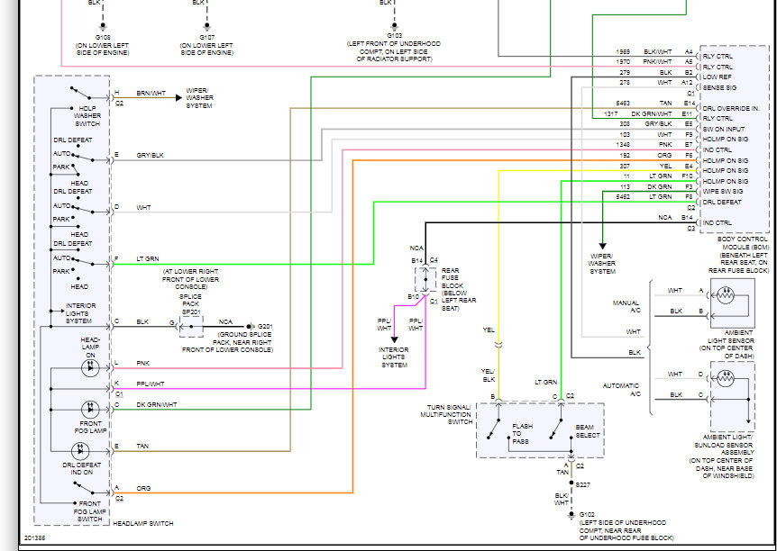

Last night I replaced a burnt out brake light bulb on the driver side and checked that it was working. This was while car was turned off. When I turned on the car a few minutes later, I noticed that the driver side headlight is out, which it wasn't before the brake light bulb swap. I don't know if it is an important piece of information, but the lights are set to auto. Coincidence or something else? Someone suggested to me I might have a "dead short." What is that and how do I find it?

The brake lights are on a different circuit, so chances are it is a coincidence. Have you replaced the headlamp and are both still working?
Take care and God Bless,
Feb 27, 2021 at 10:51 AM
More than likely it is a coincidence. The reason is, the tail light and head light are completely separate systems. So I would just figure out why the headlight is not working at this point.

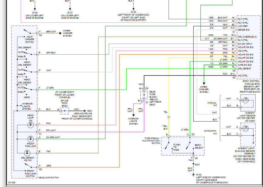

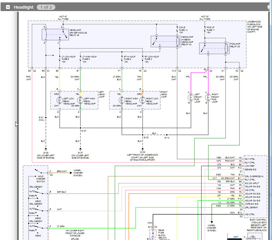

I attached the wiring diagram below for your review.
https://www.2carpros.com/articles/how-to-replace-a-headlight-bulb
Let's run through this info and let me know if you have questions.
