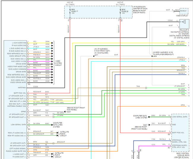

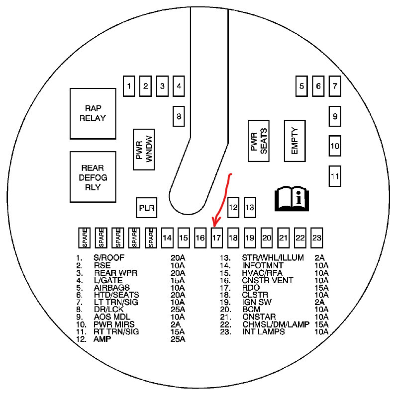

I just purchased this vehicle listed above. I was trying to install a radio when I checked the power wires for power. The 12-volt constant has no power, and the red ignition wire has no power. I tried grounding a test light and a multi meter to the battery itself, still no power from either yellow nor the red wire. I checked the fuses having to do with the radio. All fuses are good. I checked battery fuses and ignition fuses and relays, they're all good. And I cannot find an adapter plug for this vehicle. It's like the power wires don't line up. Please tell me how I can get power to red and yellow wires for the radio.

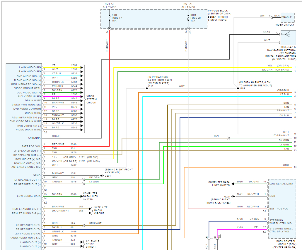

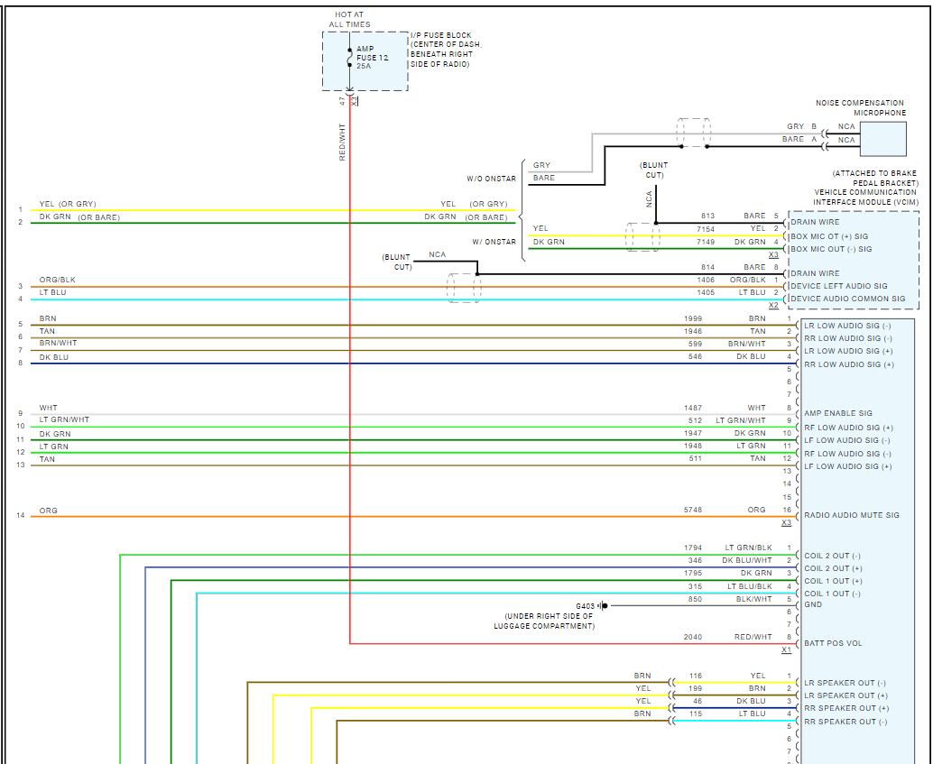

There is only one power wire to the radio which is red/wht which is fused by the RDO fuse #17 in the fuse panel in the center of the dash to the right side of the radio. Here are the radio wiring diagrams so you can see how the system works, and which wires go to where to help with the new radio installation. Check out the images (below). Let us know if you need anything else.

All the fuses relating to the radio are good. The radio fuse, the Amp fuse is also good. There is just no power coming from the constant 12 volts or the red switch wire going to the radio. I tried grounding a multimeter to the battery to check power inside the vehicle. Still no power. All fuses are good including fuse #17. That's for the radio.

and there is no power at the red/wht wire, correct? you can see by the wiring diagrams above the red/wht wire comes from the fuse panel right from the RDO fuse. Has the wiring been modified?

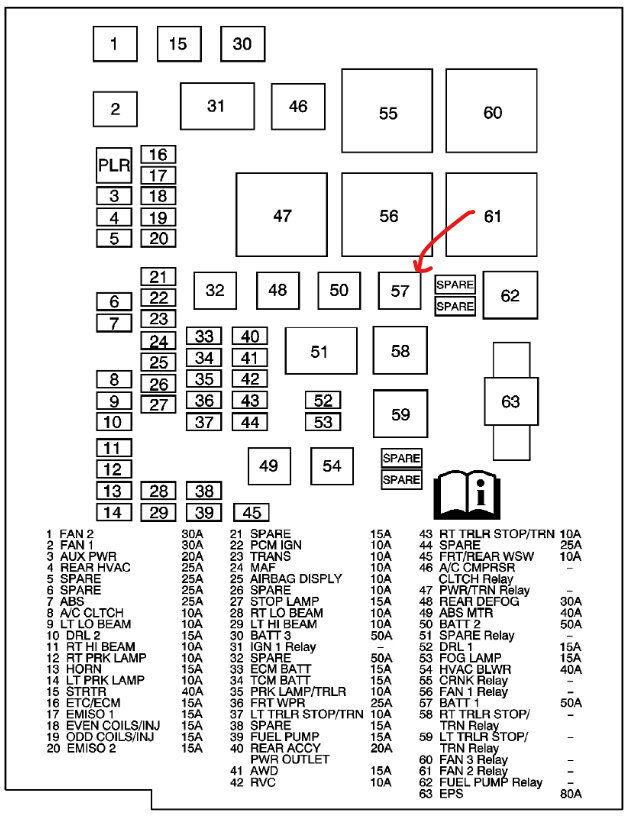

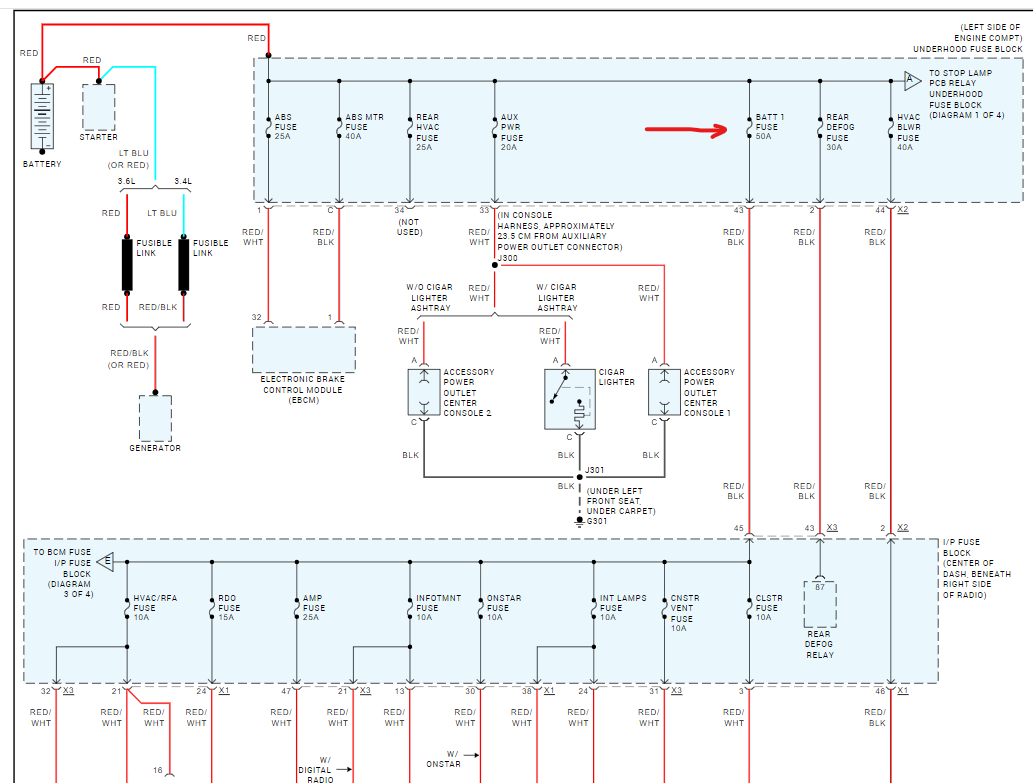

There is no power coming to the radio plugs at all. I have no idea if the wiring was modified or not. I just bought this vehicle about two weeks ago. I grounded a test light to the battery to test for power. There is absolutely no power getting to the wires for the radio but there is ground but no power at all. All fuses are good for battery, Amp and radio.
May 22, 2024 at 6:56 AM
  • 55,395 POSTS
Okay, thanks for the clarification. Let's check the 50 AMP Batt1 fuse in the under-hood fuse panel here is the location. Check out the images (below). Let us know how it goes.
