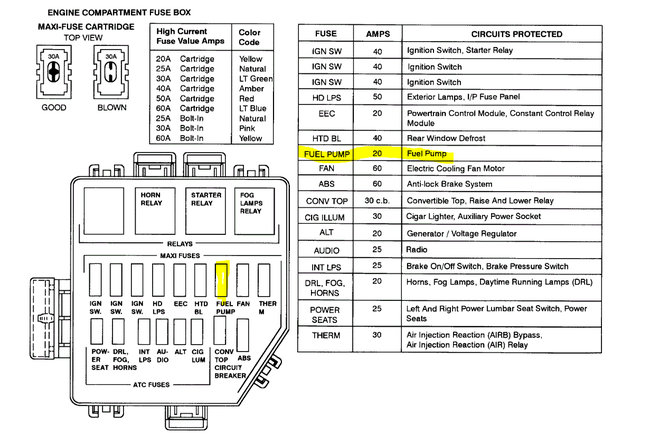

Upon moving it, it just shut off. Checked the fuses and one was blown so I replaced it, but it continues to blow the fuse when I try starting it. I think my fuel pump runs on it. I don't have the right diagram for my fuse panel. The guy I bought it from gave me a 1996 owner's manual and my mechanic told me what I have is not right. Could you start by providing the correct diagram for my car listed above? Then I'm going to help in trying to figure out where I have a short and how to fix it. It is blowing the fuses on the same blade of each fuse I try.

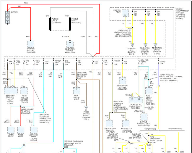

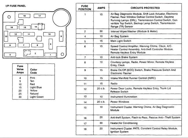

Fuses are located in both the engine compartment and the interior (instrument panel) of the vehicle.
If you look below, I attached both fuse boxes and legends. The first one is for the under-hood box. Pic 2 shows the inter panel.
Let me know if this is what you needed or if you have other questions.

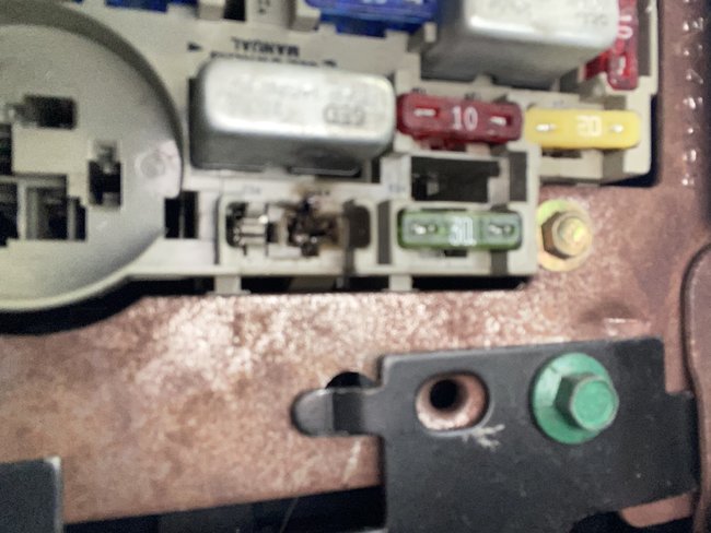

So, I got a multimeter and a light test instrument. I'm going to use the troubleshooting guides you have on the website to try to find my problem. I want to mention that before it started to blow this fuse the one right next to it was getting so hot it melted the fuse when i had the cooling fan wired into it. I have not reconnected that and so far, that fuse seems okay. I also noticed before replacing the thermostat the motor for the cabin vents wasn’t kicking on everytime. I feel like this is all related. My knowledge is very limited with electrical so I may need detailed instructions on how to fix it if i am able to find the problem. If it is the inner fuse panel that needs replaced i am definitely going to need wiring schematics. Also, can you tell me why i would have two different color 30A fuses in the inner panel? The one that keeps blowing every time i try to start it is a different shade of green. Also, what is the difference between ATO and ATM fuses? I thought it was size but i realized that there are also ATM blades the same size as the ATO blades that are installed.

Could you mean ATC fuse and not ATO? The ATC fuse is a blade-type fuse just like an ATM. The only difference is the physical size of the fuse. The ATC is an older design and slightly larger.
As far as the fuses are concerned, if one was getting hot, it could have caused damage to the fuse panel itself. Also, if you need to replace the box, don't worry. They have plug connections under them.
Where the fuse was causing the box to melt, inspect it and make sure none of the connectors are not touching.

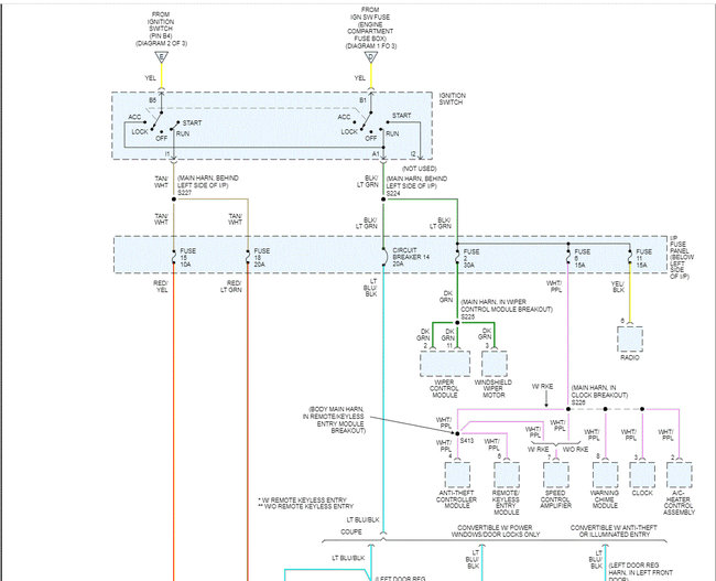

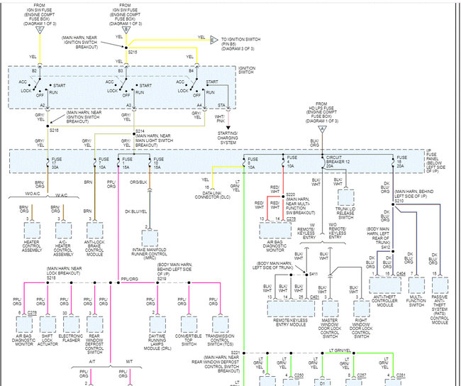

Thank you for the info. I realized yesterday that it is blowing the fuse when i turn the key just to auxiliary before even trying to start it. According to the diagram, slot 18 and is used for the ignition switch, CCRM, and PATS ( i don't have this). When you say connectors do you mean the ones that plug into the back of the fuse panel? Sounds like a good place to start. However, slot 17 which was getting hot with the cooling fan hooked up, appears to be okay since i removed that. The odd thing is it was fine for two years like that up until the thermostat went bad. Originally it was on a toggle, but we felt it was better to wire so it would go on and off with the ignition rather than relying on me to remember to turn it off. I'm thinking i might go back to the toggle now though.

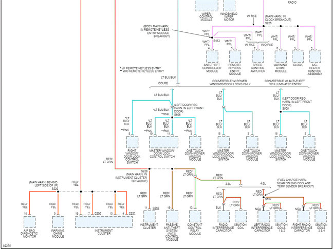

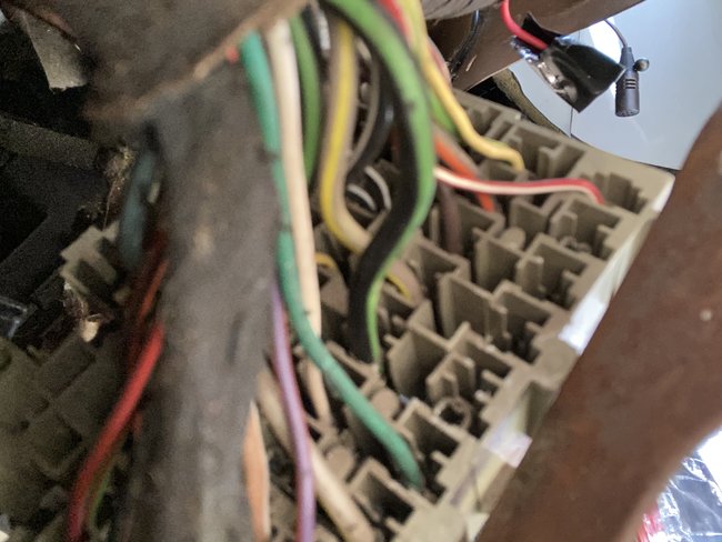

Okay, so I'm down to the inner fuse panel. But of course, it appears all the wires are wired directly into it rather than connectors (see image) I apologize but this is all the further i can pull it down right now until i figure out how to loosen the harness. So, i think i might need the wiring schematic with the labels for the wires. I may have a few things going on but i would feel more comfortable if i could label the wires. The second photo is what happened to 17. 18 is the one that blows when i turn the key to auxiliary. As you can see, you it isn’t out of the realm of possibility that I may need a new fuse panel. I haven’t gotten a look at the wires yet. Was hoping to find the schematics before i do. Thanks in advance.

  • 110,248 POSTS

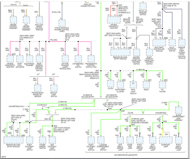

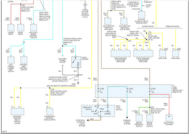

No problem. I attached the wiring schematic below for the power distribution circuits. Take a look through them and let me know if you have questions or if I can help.
