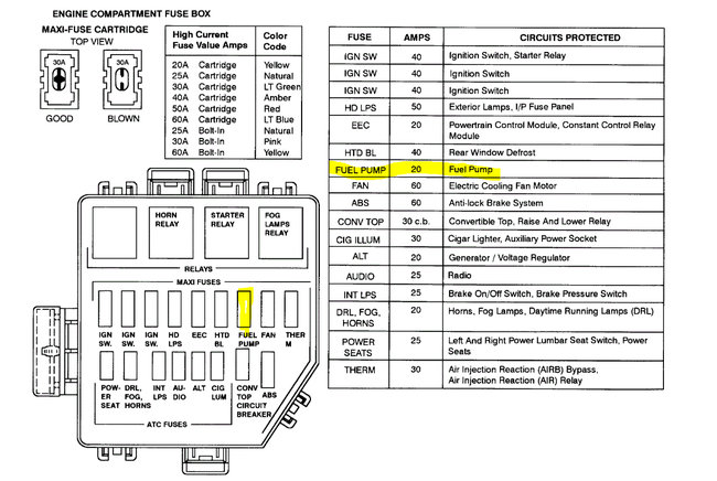

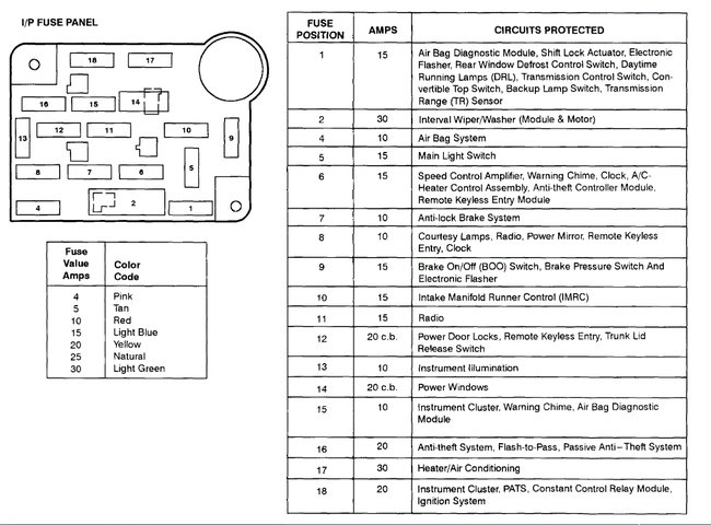

Upon moving it, it just shut off. Checked the fuses and one was blown so I replaced it, but it continues to blow the fuse when I try starting it. I think my fuel pump runs on it. I don't have the right diagram for my fuse panel. The guy I bought it from gave me a 1996 owner's manual and my mechanic told me what I have is not right. Could you start by providing the correct diagram for my car listed above? Then I'm going to help in trying to figure out where I have a short and how to fix it. It is blowing the fuses on the same blade of each fuse I try.
May 3, 2022 at 8:48 PM
  • 110,244 POSTS
Fuses are located in both the engine compartment and the interior (instrument panel) of the vehicle.
If you look below, I attached both fuse boxes and legends. The first one is for the under-hood box. Pic 2 shows the inter panel.
Let me know if this is what you needed or if you have other questions.

Thank you for the info. I realized yesterday that it is blowing the fuse when i turn the key just to auxiliary before even trying to start it. According to the diagram, slot 18 and is used for the ignition switch, CCRM, and PATS ( i don't have this). When you say connectors do you mean the ones that plug into the back of the fuse panel? Sounds like a good place to start. However, slot 17 which was getting hot with the cooling fan hooked up, appears to be okay since i removed that. The odd thing is it was fine for two years like that up until the thermostat went bad. Originally it was on a toggle, but we felt it was better to wire so it would go on and off with the ignition rather than relying on me to remember to turn it off. I'm thinking i might go back to the toggle now though.

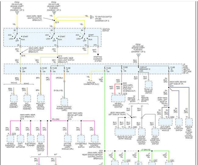

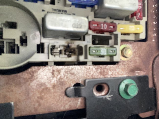

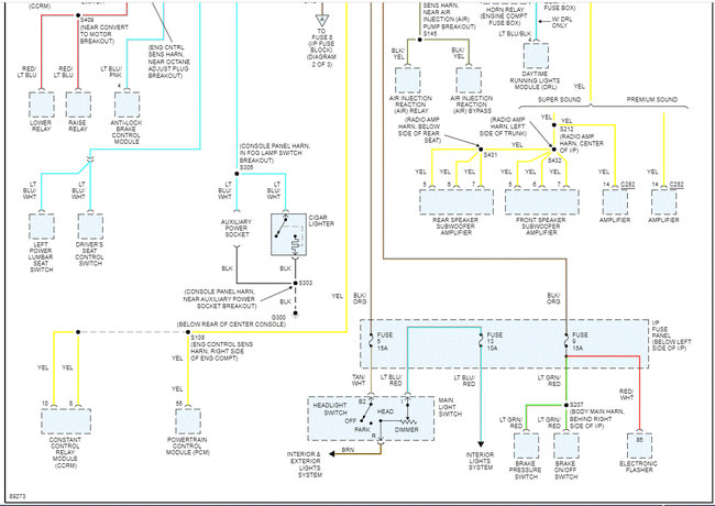

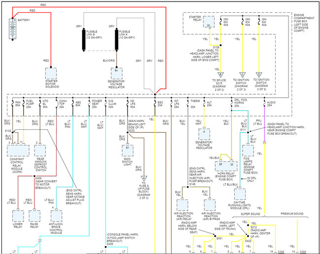

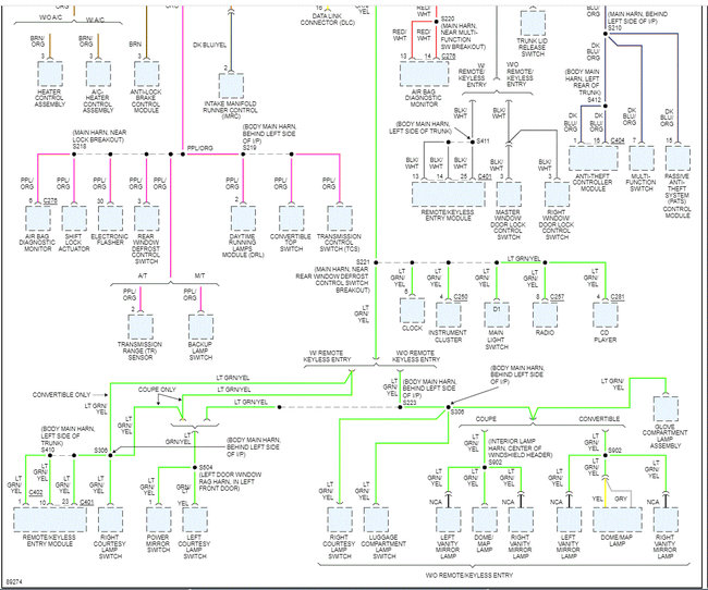

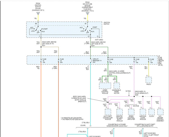

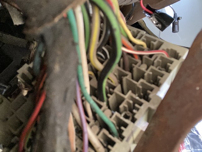

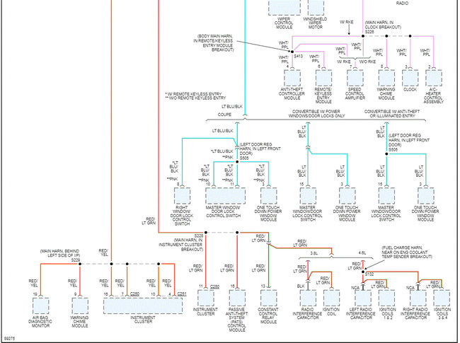

Okay, so I'm down to the inner fuse panel. But of course, it appears all the wires are wired directly into it rather than connectors (see image) I apologize but this is all the further i can pull it down right now until i figure out how to loosen the harness. So, i think i might need the wiring schematic with the labels for the wires. I may have a few things going on but i would feel more comfortable if i could label the wires. The second photo is what happened to 17. 18 is the one that blows when i turn the key to auxiliary. As you can see, you it isn’t out of the realm of possibility that I may need a new fuse panel. I haven’t gotten a look at the wires yet. Was hoping to find the schematics before i do. Thanks in advance.
May 9, 2022 at 7:57 AM
  • 110,244 POSTS
No problem. I attached the wiring schematic below for the power distribution circuits. Take a look through them and let me know if you have questions or if I can help.
May 9, 2022 at 11:37 AM
