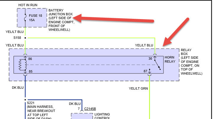

Driver window just stopped operating. All other windows work as do locks. Think I changed the right fuse. Also horn is not working. Put new fuse in still nothing. I believe that they ton different circuits. Thank you for any help you can provide

slam door and see if it works if not then wiggle harness while trying to operate window if it works with a wiggle the harness is broken if it works when you slam door hard it's the motor.finally have it scanned for codes for a bad module in driver's door. for horn check items in pic if still not working have scanned for codes to see if clock ring is problem in steering column.
