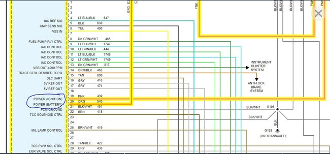

Will not start after battery cable that goes to the fuse box touched another piece of metal
1997 PONTIAC GRAND PRIX
144,000 MILES • 3.8L • 6 CYL • 2WD • AUTOMATIC
DLKS77
The battery cable that goes to the fuse box accidentally touched another piece of metal and I saw a spark. After this the car is trying to turn over and won’t start. I noticed the fuel pump does not make a prime noise. I replaced the fuel pump fuse, rely, wires from the fuel pump that connect to the gas tank and fuel pump. And no prime noise. I replaced the fuse box and no priming. Is it possible the battery cable got fried? If the battery cable was replaced would that get the car going? I do get electric on everything else like windows and locks. I really your help.

Good morning,
When you turn the key to the on position, does the check engine light come on?

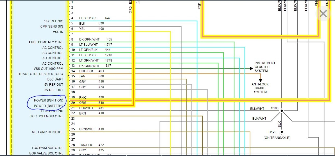

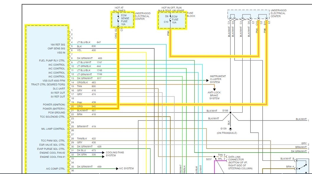

Can you communicate with the ECM? There is a good chance that the voltage surge from the short damaged the ECM.
I attached a wiring diagram of the 2 powers required for the ECM. Check them for a test light or voltmeter.
Apr 18, 2020 at 5:28 AM

The check engine is on. I tested it and get P1406. Would a dirty/fried EGR valve not prime the fuel pump? I also had another ECM and it also recognized the car. It provided the same code. I noticed the fuel rail pressure sensor did not shoot out any gas when I took the cover off and pressed on the inside pin. Would an old/fried pressure sensor stop it from priming? Would a probe clip be needed to test the ECM wires with the multi meter? I thank you very much.
Apr 20, 2020 at 2:51 PM

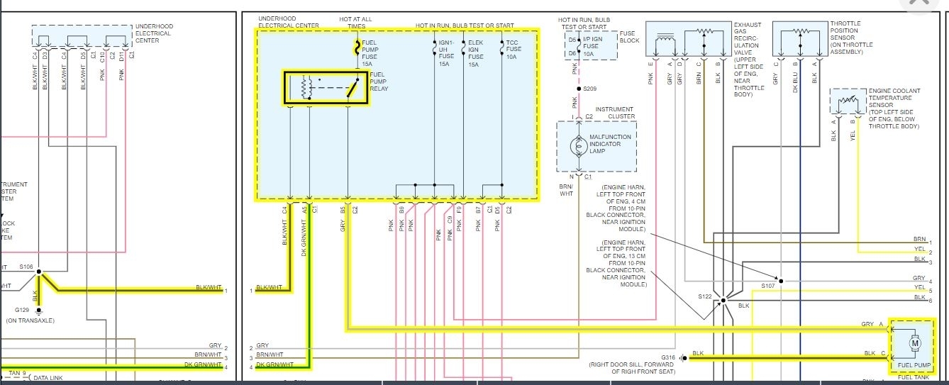

Okay, good.
The 1406 is for the EGR valve. It has no connection to the fuel pump.
Toy may have a bad fuel pump. You need to do a pressure test to see what pressure the pump is sending.
https://www.2carpros.com/articles/how-to-replace-an-electric-fuel-pump
I attached a wiring diagram for you of the system. You will need a test light or voltmeter to do some testing.
