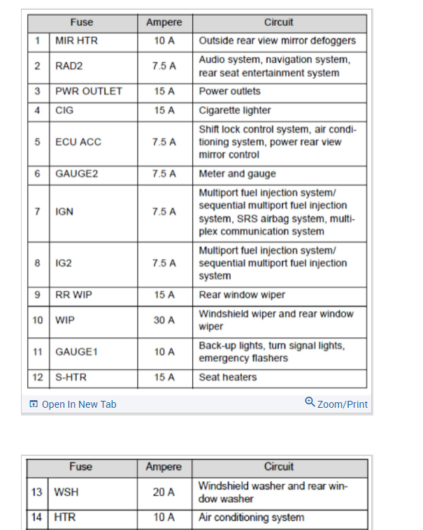

Car had been running very well. A couple of days ago, I had left the key on overnight after raising the windows due to a coming thunderstorm. After having to recharge the battery twice, the gear shift selector was locked in place. I did find an emergency button (indicated in the car manual) which did allow me to release it from park. But, it's very stiff. I didn't drive it at this point.
Afterwards, I began checking and found numerous other, I suppose electrical problems, such as: I can't unlock the rear deck lid (van) while other doors would lock and open, the automatic window will not work, the automatic driver's seat will not function, the heat gauge would not register at all, the gas pedal would not allow me to rev up the engine to no more than 2,000 RPMs, the cabin lights work in the front but not the rear, turn signals will not work, radio and disc player will not work, fan and air conditioning will not work, rear tail lights and brake light won't work, and the windshield wipers won't work. The headlights, however, do work - normal and long range and the horn.
Is it possible that I overcharged the battery? I have looked at some of the fuses, but is there a master fuse which would have responded negatively after overcharging the battery?
Using the car manual, I have checked a few of the fuses in four different locations.
Will be gone for a while to a doctor's appointment and will check back for your answer later.
Aug 5, 2021 at 6:28 AM
It is unlikely that you overcharged the battery but we should check the battery just to be safe.
Here is a guide that will show how to load test it which is what we need to do:

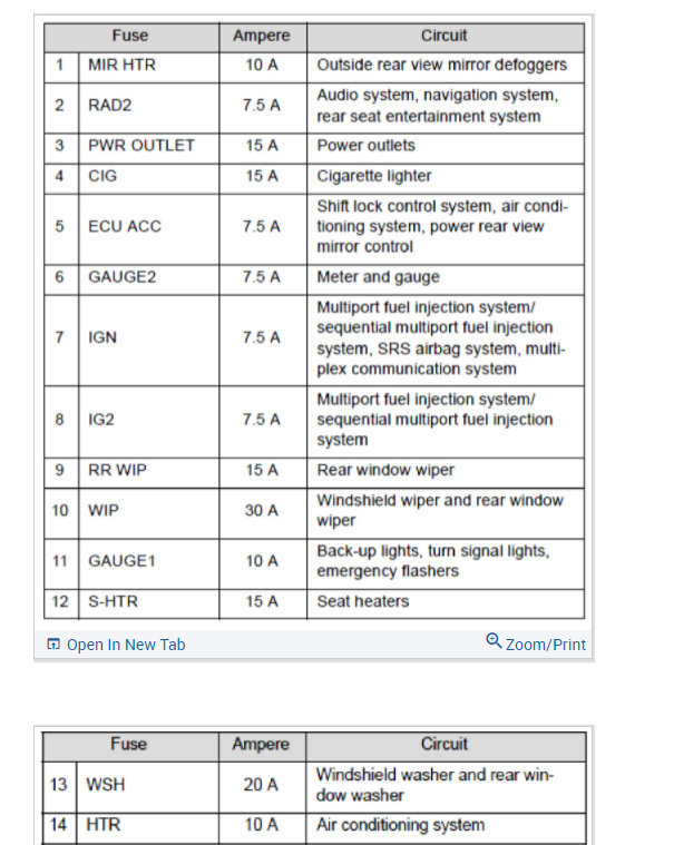

However, the next likely thing we need to do is run through all the fuses and check and make sure we don't have a number of blown fuses.
Once we work through this we will have a better idea what the issue may be. However, if the battery is ok and fuses are fine then we are going to have to pick one of the systems and start checking power to find what the possible issue is on that. Once we fix that one system then we can move onto the next that is not fixed but hopefully these are all related and that fixes everything.
However, trying to tackle all these in one bit just gets overwhelming so we need to focus on one and work through it.

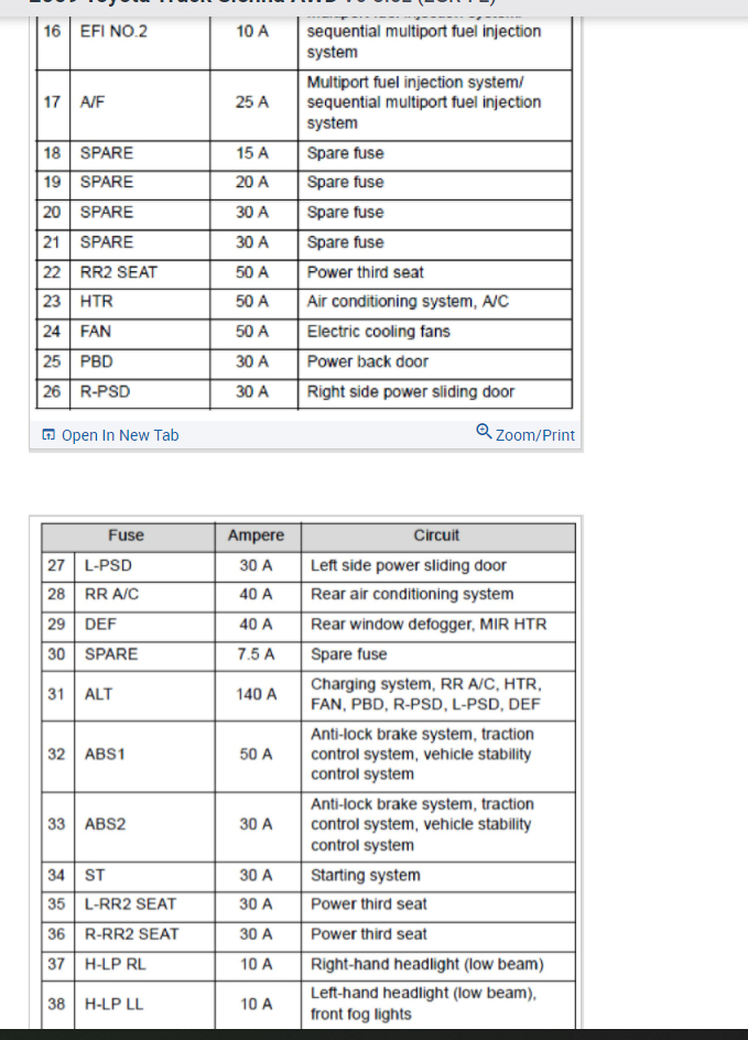

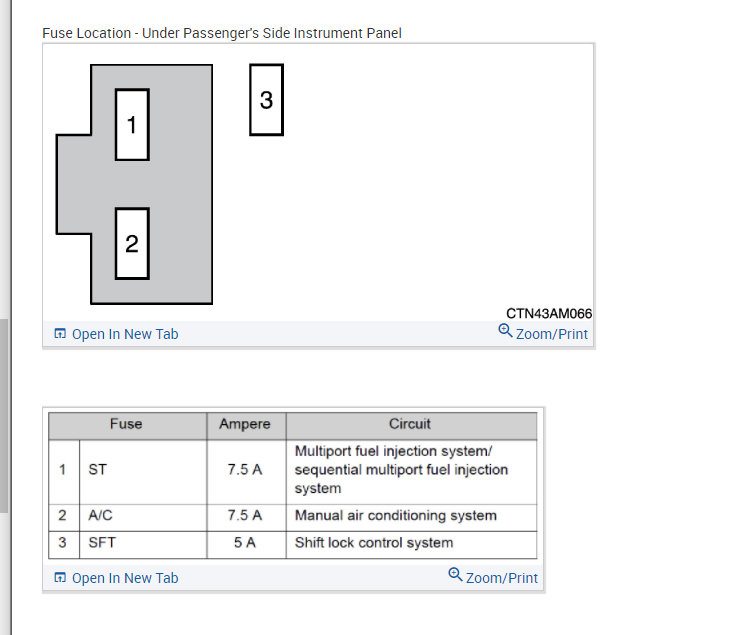

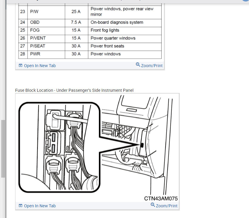

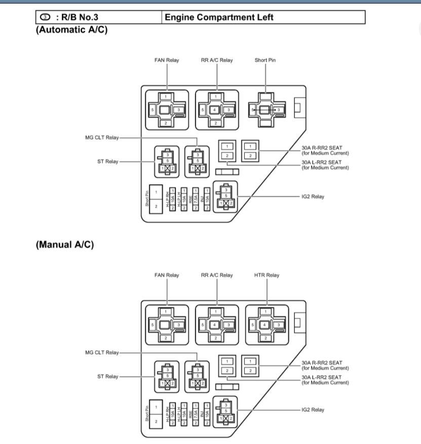

Below you will find the fuse box layouts for your review.
Let us know what you find with this and we can go from there as I am thinking the battery may be damaged causing these issues.

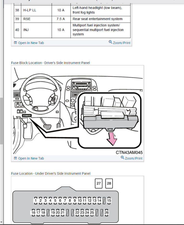

I looked at all three different fuse blocks and individual fuses. A visual check of each fuse did solve one problem. Two of them were burnt and severed. One helped me with the accelerator and it now functions. The other was a radio fuse (single), but it didn't make any difference. It is still off.

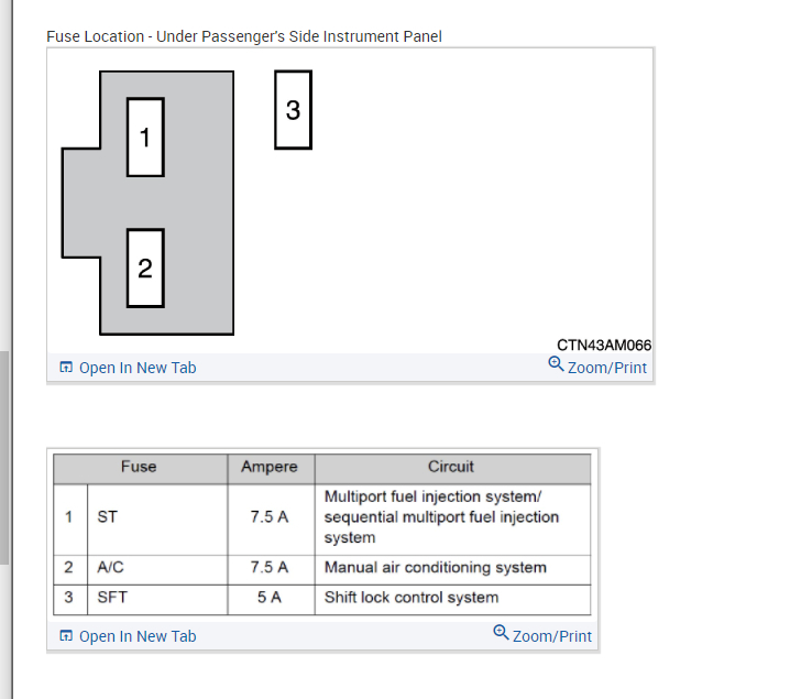

The fuses I checked were visually checked as I didn't have a tester. I was told by the Toyota service department that there is a second fuse box in the engine department beneath the one that the pictures I have from you shows. They indicated to me that it wasn't a good idea for me to try to get to that fuse box??
The driver's side fuse block was quite disturbing, but I think I have it figured out. The schematic on the cap versus the instructions in the book didn't match well. However, the engine compartment fuse block on my van does not have the section 22-29 and 31-34 fuses. That was confusing as well.

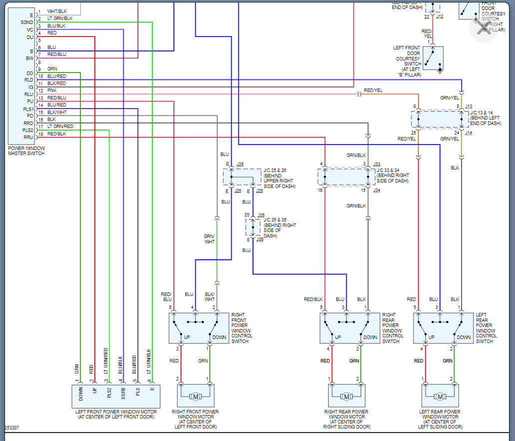

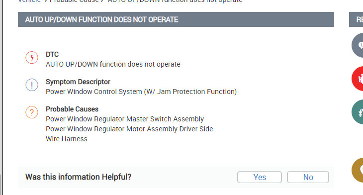

So what I would suggest is we start with the power window issue. Basically I would remove the door panel and check power at the motor and then work backwards through the system to find where the issue is.

Basically we need to pick one of these items and start working through the issue. If it fixes all of them then that is just a bonus.
Here is a guide that will help with this:
Below you will find the detail on this. Please run through this and let us know what you find.

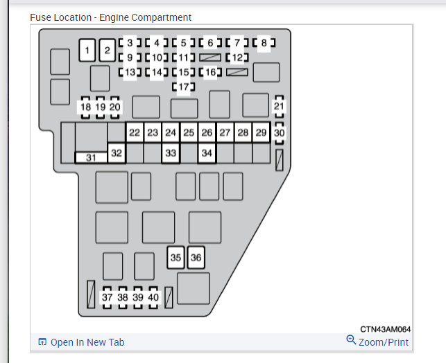

I did buy and use a fuse tester that lights up on all the three panels of fuses. Again, it was only visual before. All of them tested good except for number 37 and 38 in the engine compartment fuse block. This was strange since the headlights did work.

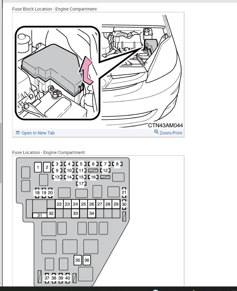

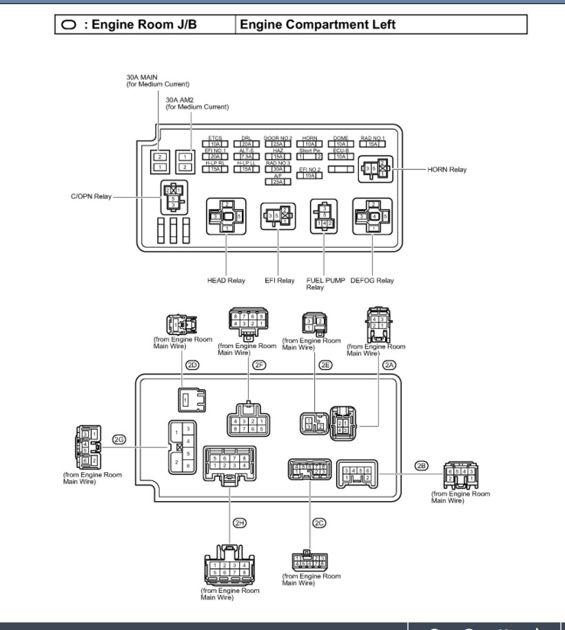

Here's another confession: In the engine compartment fuse block, number 1 and 2 have never been tested. These are a clear, purple box fuse(?), 30 amp. They don't seem to want to come out by pulling them, so I hadn't yet been able to figure out how to test them. So, how are they tested?? Do I need to pull harder. I don't want to break them. Could they be the answer?

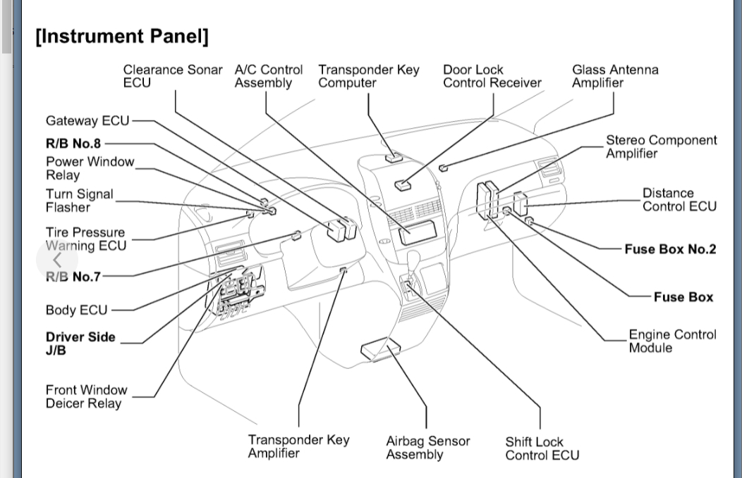

1. Is there another fuse panel under the one shown in the engine compartment?
2. Where would the missing fuses in the engine compartment fuse block go to? The functions they protect are relevant functions listed to those missing fuse sections (22-29, 31-34).

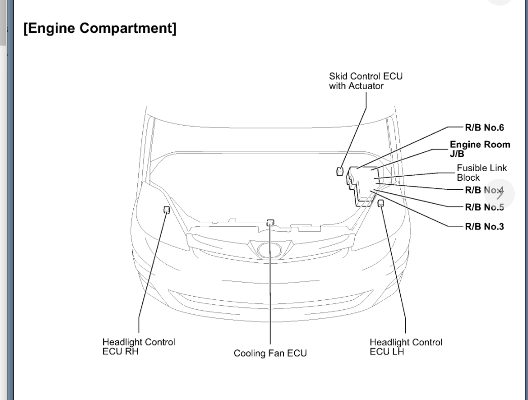

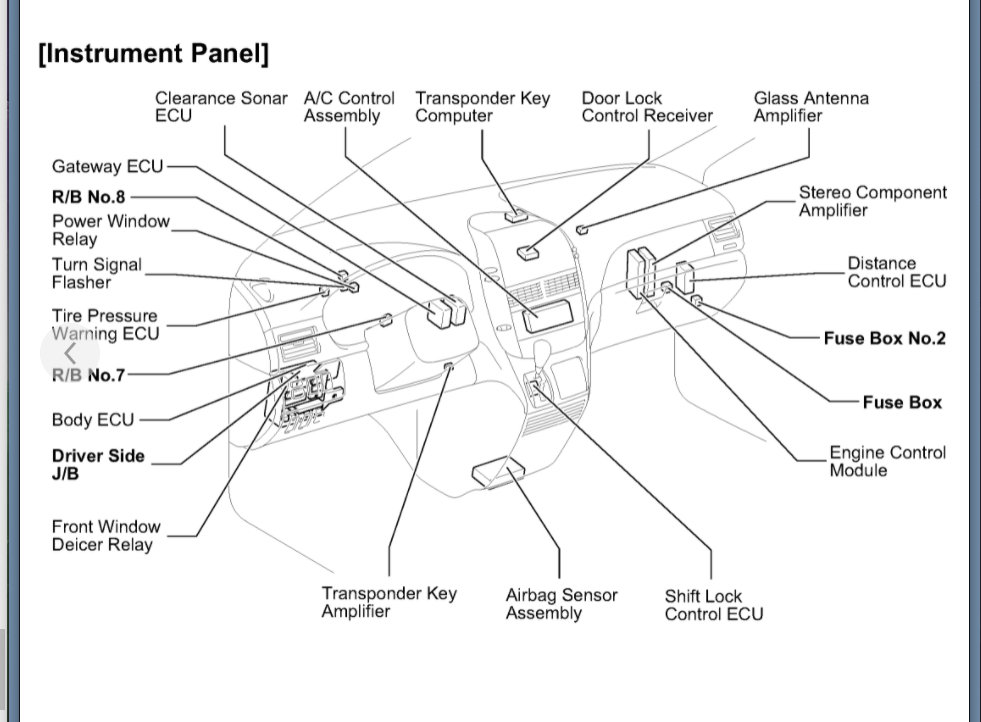

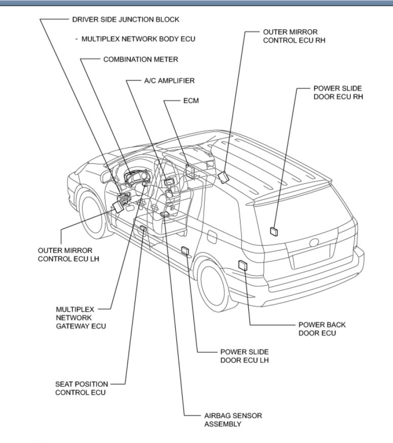

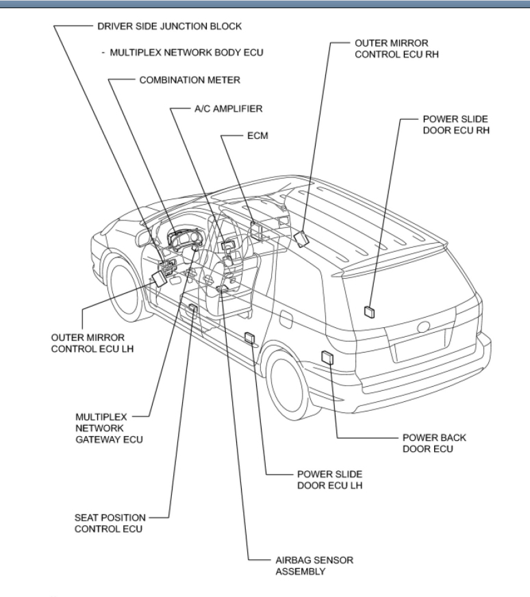

3. Where is the location of the body control module you mentioned? How expensive is it? This is a 12 year old vehicle with high mileage. The dealer and a shop are quoting five plus hours at a minimum of $130.00 per hour to try to find the answer. I do have to weigh the benefits versus the losses.

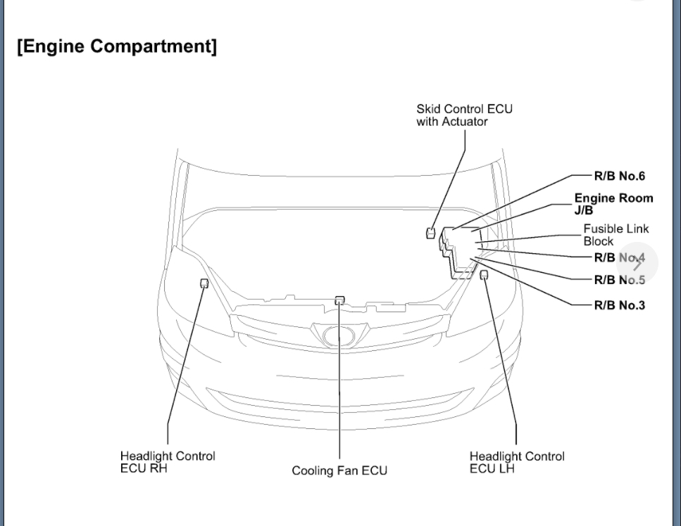

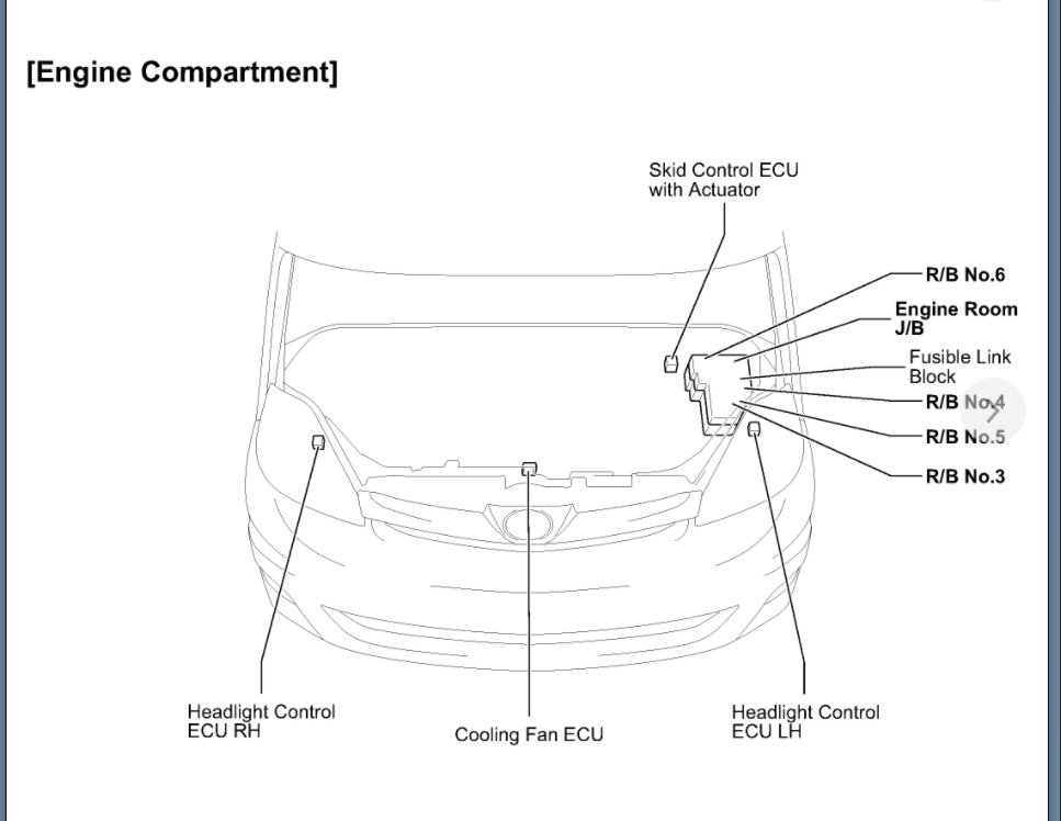

I do not show any fuse block under the other fuse block in the engine compartment.
I am sure there was some confusion in what they meant because that is not normally what they do as the fuse box is meant to be easily accessed to check the circuits.

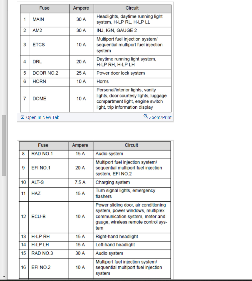

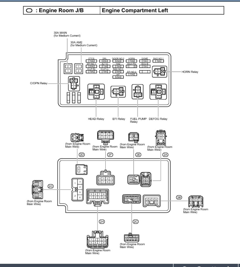

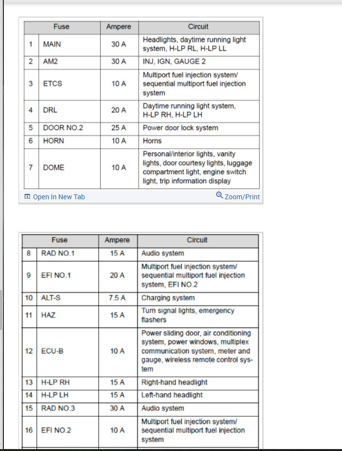

Take a look at the diagram below that will help with this.
Fuse 1 and 2 in the engine box are considered max fuses. They are larger then normal fuses and will just pull out like a normal fuse. They are pretty tight but it doesn't appear they are the issue as they are for some systems that you said are working.
See below.
As for the body ECU, that is called the gateway module in these diagrams.
I think I attached the info that you are asking for but let us know if I missed something. Thanks

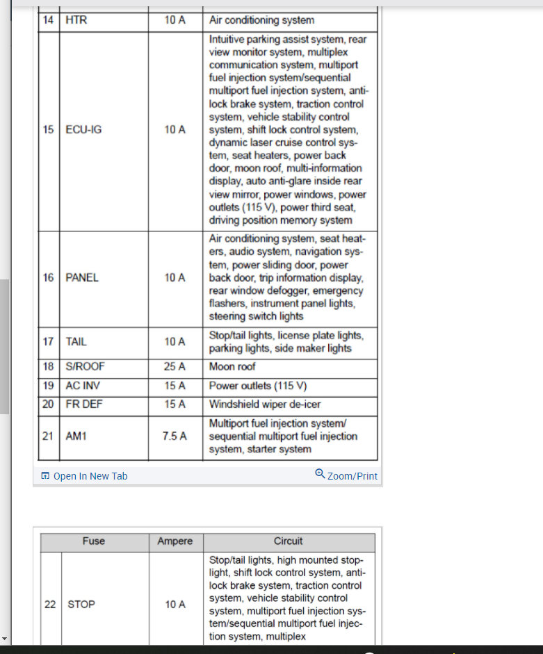

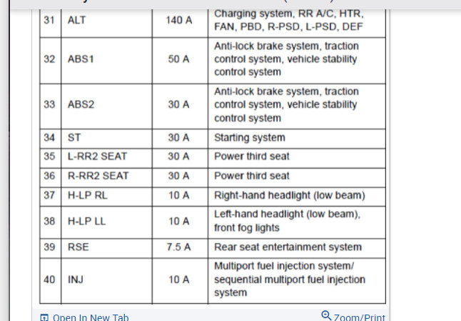

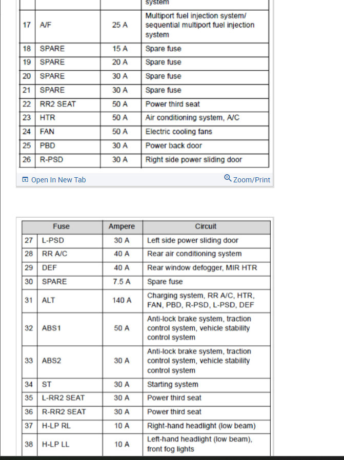

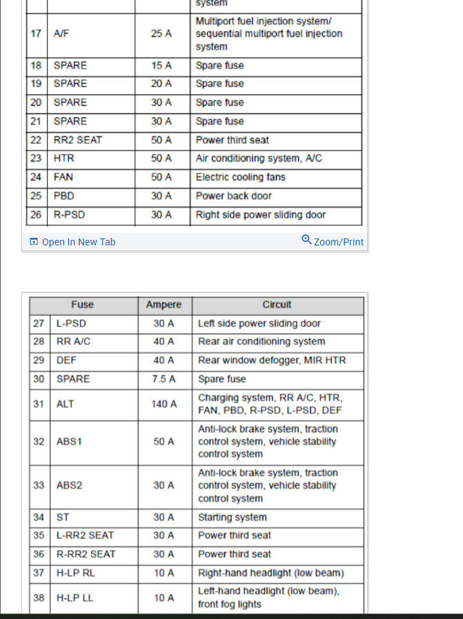

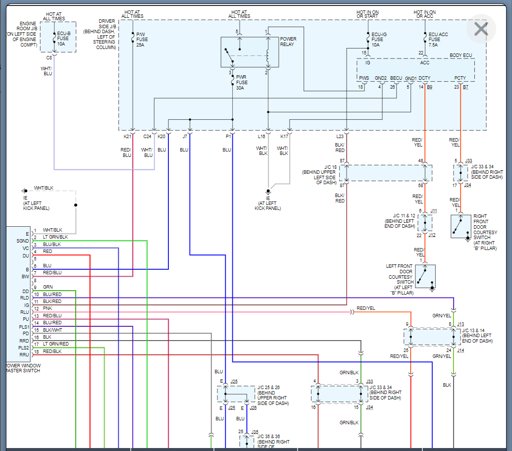

Thank you for your recent response and the diagrams. I mentioned that I had found two fuses which didn't light up with my tester....#37 and 38. I replaced them with new ones, still no response. Remember, all the rest in the fuse panel light up.
I don't understand how the headlights can work when the fuses don't seem to be testing as functioning. Could this in any way hint as part of a solution to problems I am facing?
The vehicle, remember, had been running perfectly for the past year until the day I came out and found the battery dead. And after charging and having it tested, I found all the rest of these various functions that didn't work. So since the car readily starts and with the manual button I can shift gears, would it harm the vehicle to drive it? Or could that endanger or create new problems in additional systems.
Two things finally. One, I'm still not sure that you are realizing that my engine compartment fuse block doesn't have the fuses listed #22-29 or #31-34. There is no place for them. That area is covered by a long, clear narrow see through plastic cover in which I can see two long silver rods that extend from side to side. So? Either those functions listed in the owners manual were either rerouted elsewhere or somehow were not needed for my vehicle.

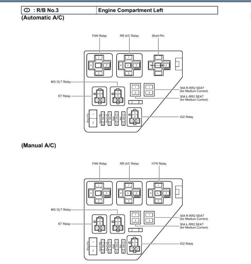

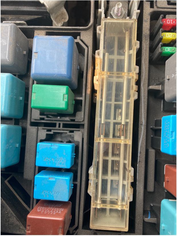

Can you get a picture of this item that is in the fuse locations? I suspect these are mega fuses but I need to see them and that will help explain that.

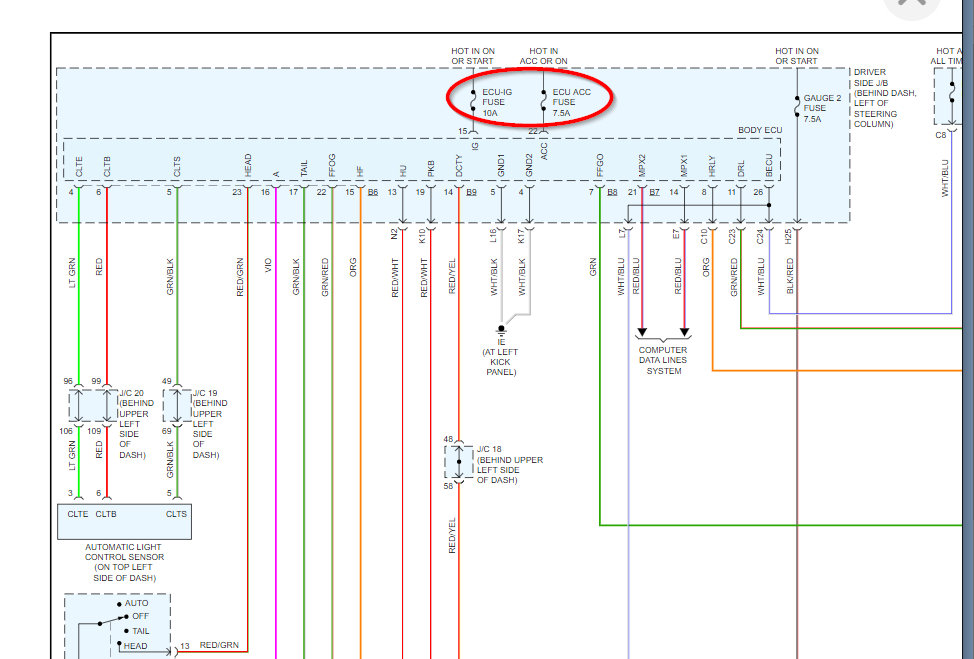

If you have no power coming through on the left and right head lamp fuses then but the headlights still work then you have a short most likely in the driver side junction block.
Take a look at the wiring diagram below. This is showing that these fuses feed the Body ECU so I suspect this is where the short is.

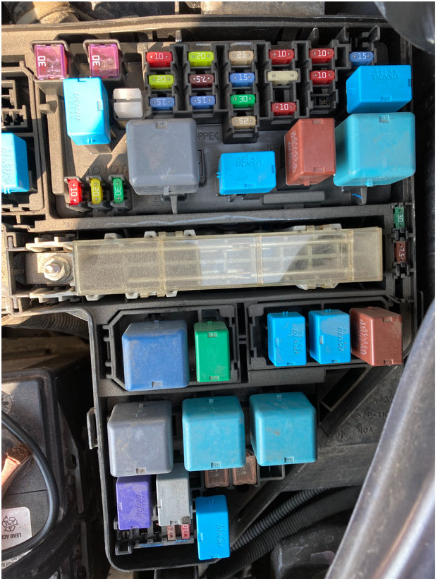

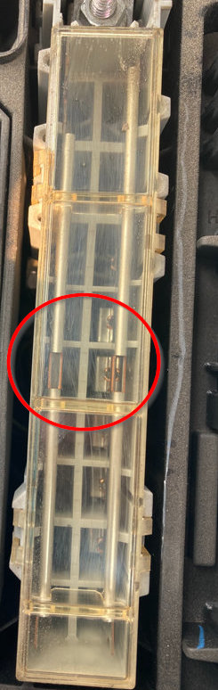

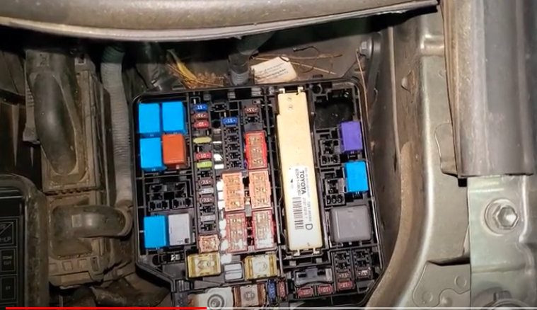

I have two pictures I took on my phone but can't seem to get them to send. The two pictures are of the fuse panel in the engine compartment. Number 2 is an enlargement of the special long plastic covered area I mentioned.
Could you please send me your phone number, so I could message them to you? We won't use your number for any other purpose unless you ask us to or share it with anyone else.
Thanks
Aug 26, 2021 at 8:48 AM
Got them. Thanks. I suspect it was because they were too large of a file. I attached them below.
Those are called mega fuses or also called multi fuses.
Basically they are a number of fuses put into one fuse.
I attached a picture out of another Sienna that is newer. Looks a little different but same idea.
I still think you have an issue with the body ECU which is part of the fuse block because if you have no power on these fuses going to these but they still work then they are getting power somewhere.
However, I just want to confirm that you have daytime running lights? If you do not then these fuses should be empty.

You can open the cover of these fuses and check for voltage at end to end but you can see that the metal weak links are intact.
