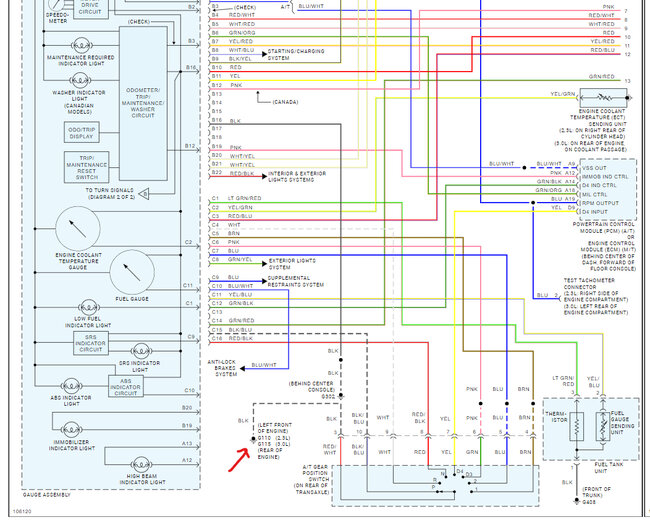

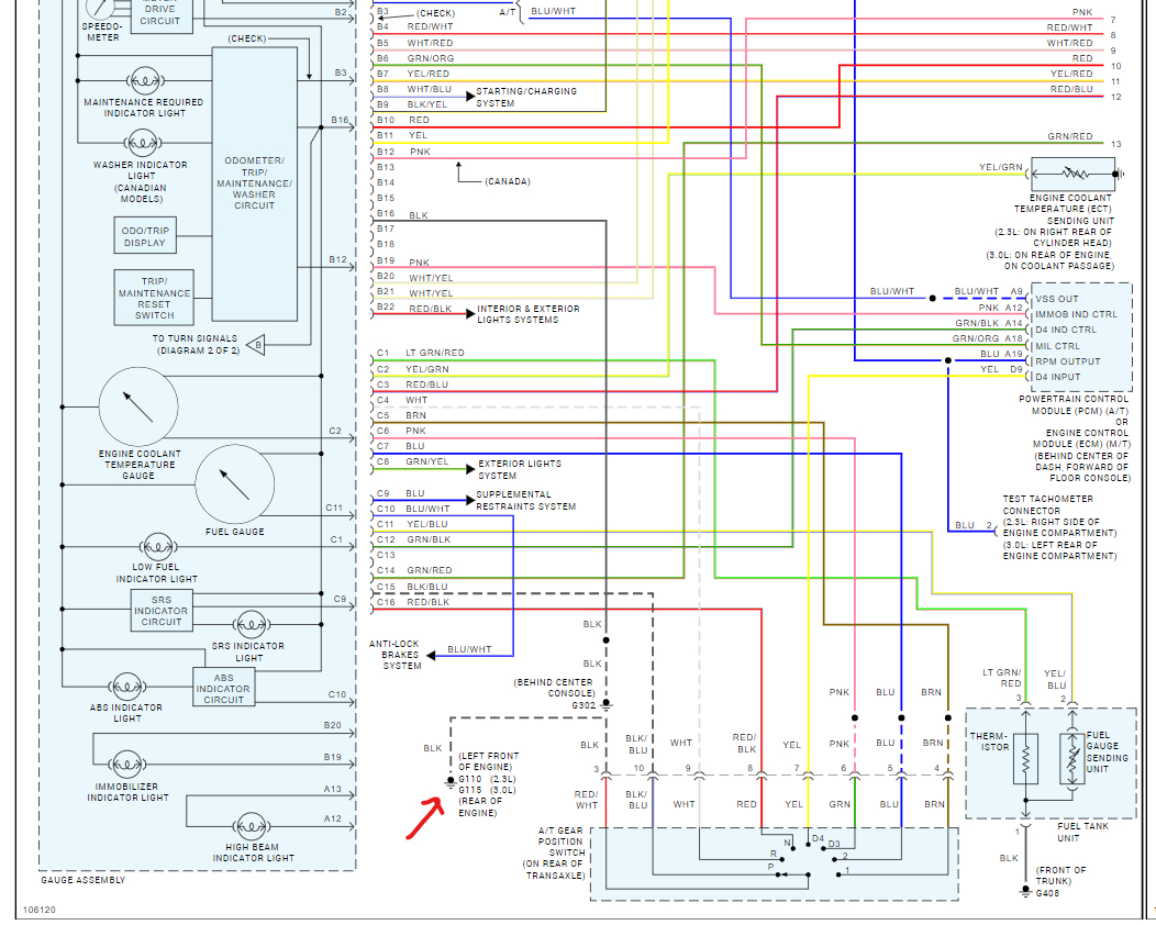

I was coming home from work when all of a sudden, my dash lit up with all the door lights and brake light and battery light came on. I figured probably just needed to clean up some wires and or the battery terminals and connections. did all that and still the lights are on. I've driven it to and from work like these the past 2 days and my battery is still good with 100% health and 99% state of charge. Any ideas would be very appreciated, thank you in advance.
Jul 30, 2024 at 8:54 AM
  • 55,447 POSTS

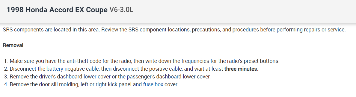

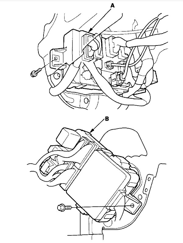

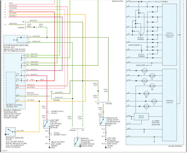

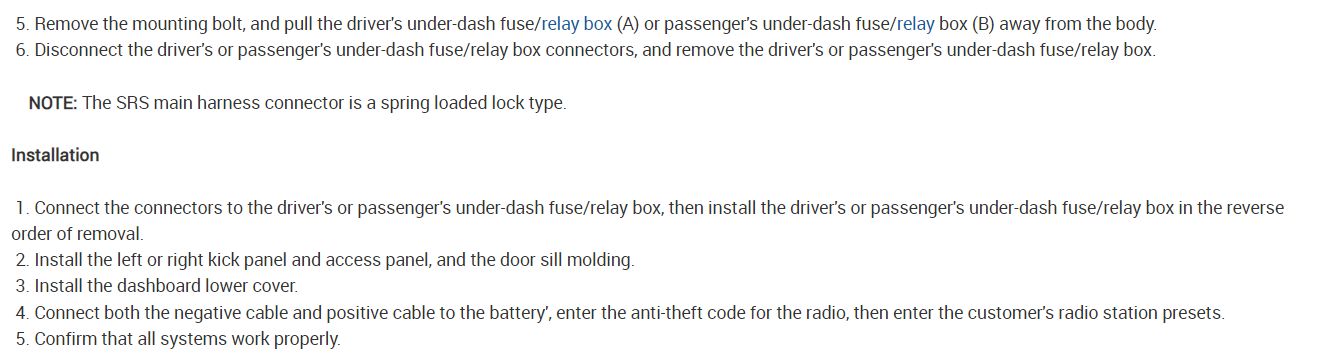

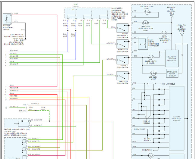

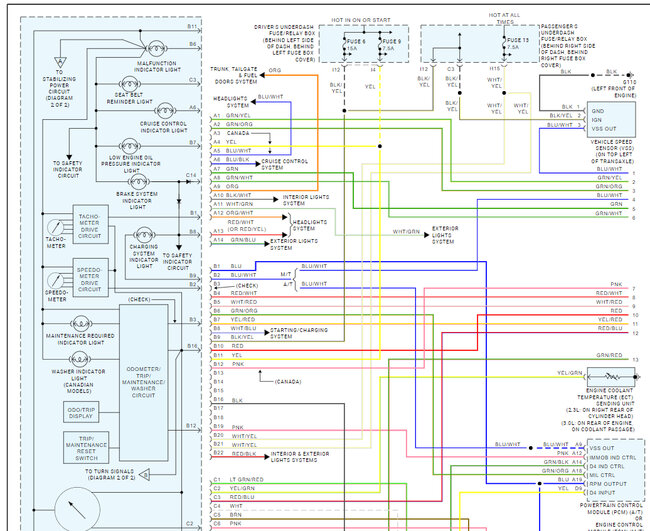

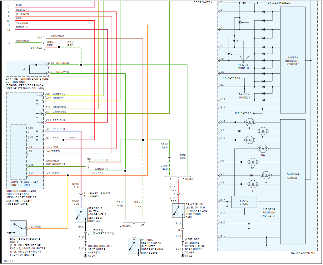

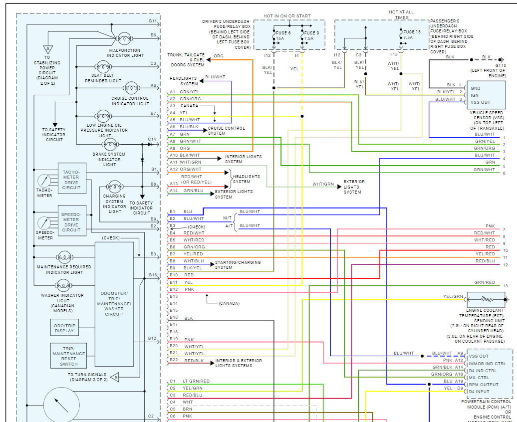

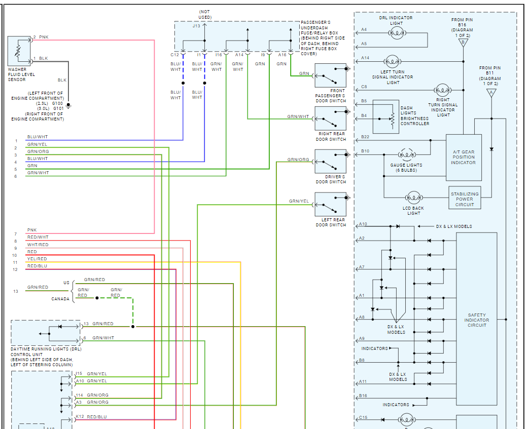

This is common when the driver side multiplex unit goes out. Here are the instrument cluster wiring diagrams so you can see how the system works with the driver side multiplex unit. I would check the power and grounds to the cluster and if okay I would replace the driver side multiplex unit.
Check out the images (below). Please upload pictures or videos in your response of any problems so we can see what to help you with.
