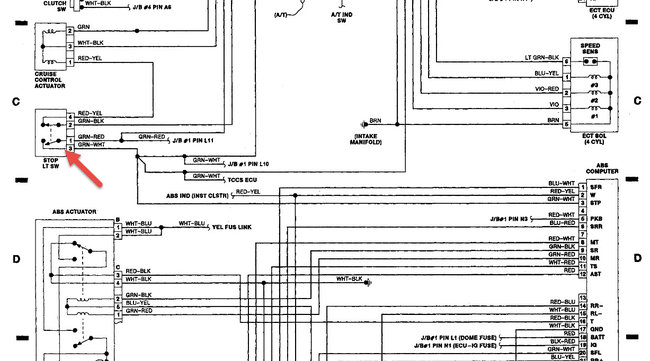

All lights work but brake lights do not. Checked fuses all okay.changed brake light switch.

check to see if you have power going to brake switch then out then trace green/red wire for lights. It may be a bad turn signal switch as it has to go through that to work lights in rear.
